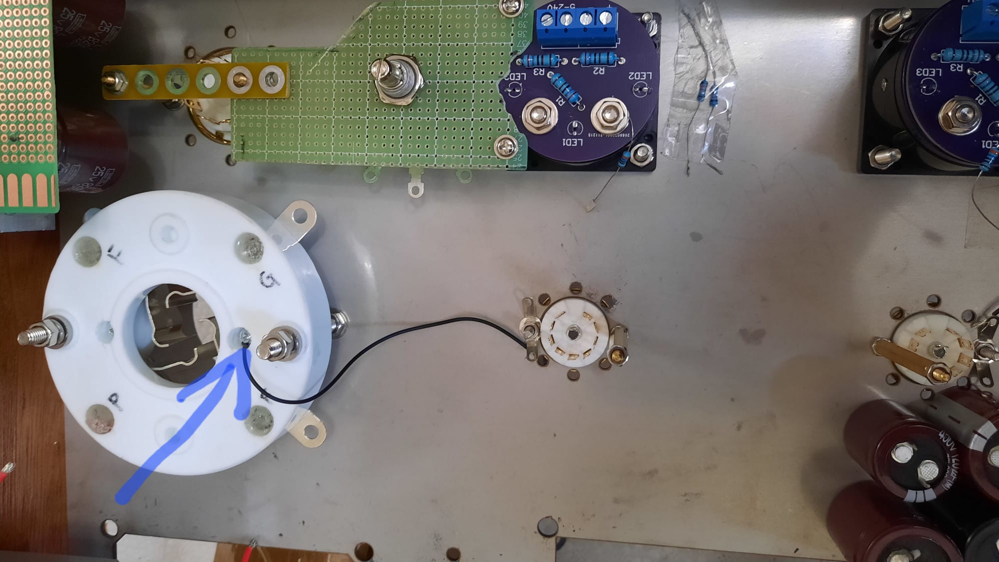

Regarding the 805 socket supplied, I find that its metal bracket is not grounded (i.e. floating). Just wonder if it is safe to leave it floating, as the nearby connectors are at HV. So I added a ground wire to connect it to the grounded metal cabinet. Is it the right way to do this?

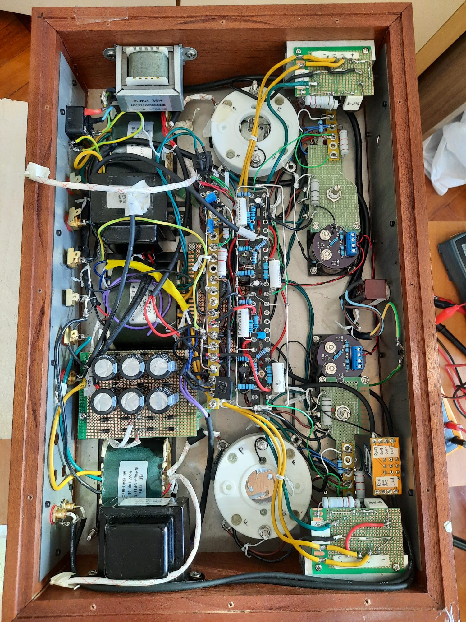

After a few months, finally I got the diy 805 amp assembled as shown. Just started to do the testing with the DC bias. Seems that the bias currents are OK for the 3 stages (i.e. ECC83, 12AU7 and EL34B). Next I plugged in the 805 tube without connecting the speaker. I tried to adjust the grid voltage and bias current. Then I observed that the grid voltage changed from -300V something and then rise up to near 10V (after EL34B was heated up). Nevertheless, at that moment I heard some noise (ro, ro, ro ....) from the OPT. In about a minute or 2, the fuse was blown up.
Just don't know what happened. Seemed the the OPT was burned. Measured that its primary winding is shorted to the secondary winding.
Someone said the I should test it with the dummy speaker load connected. But I'm not sure because later I really connected a dummy load. Unfortunately, the noise is still there.
Any idea from the expert?
Yes, the dummy load is needed for testing. without it, the tube sees a high impedance, and the voltage-swing can be very large, and OT can be damaged.
Next I got the info from the DIY kit supplier that the dielectric strength of the OPT is 1200V. Supposed to be not high enough, because the B+ is already near 1100V. ??
Peak voltage from primary winding to secondary (ground) can easily be 2500V, occasionally more. This OPT is not usable for 1100V output stages, no.

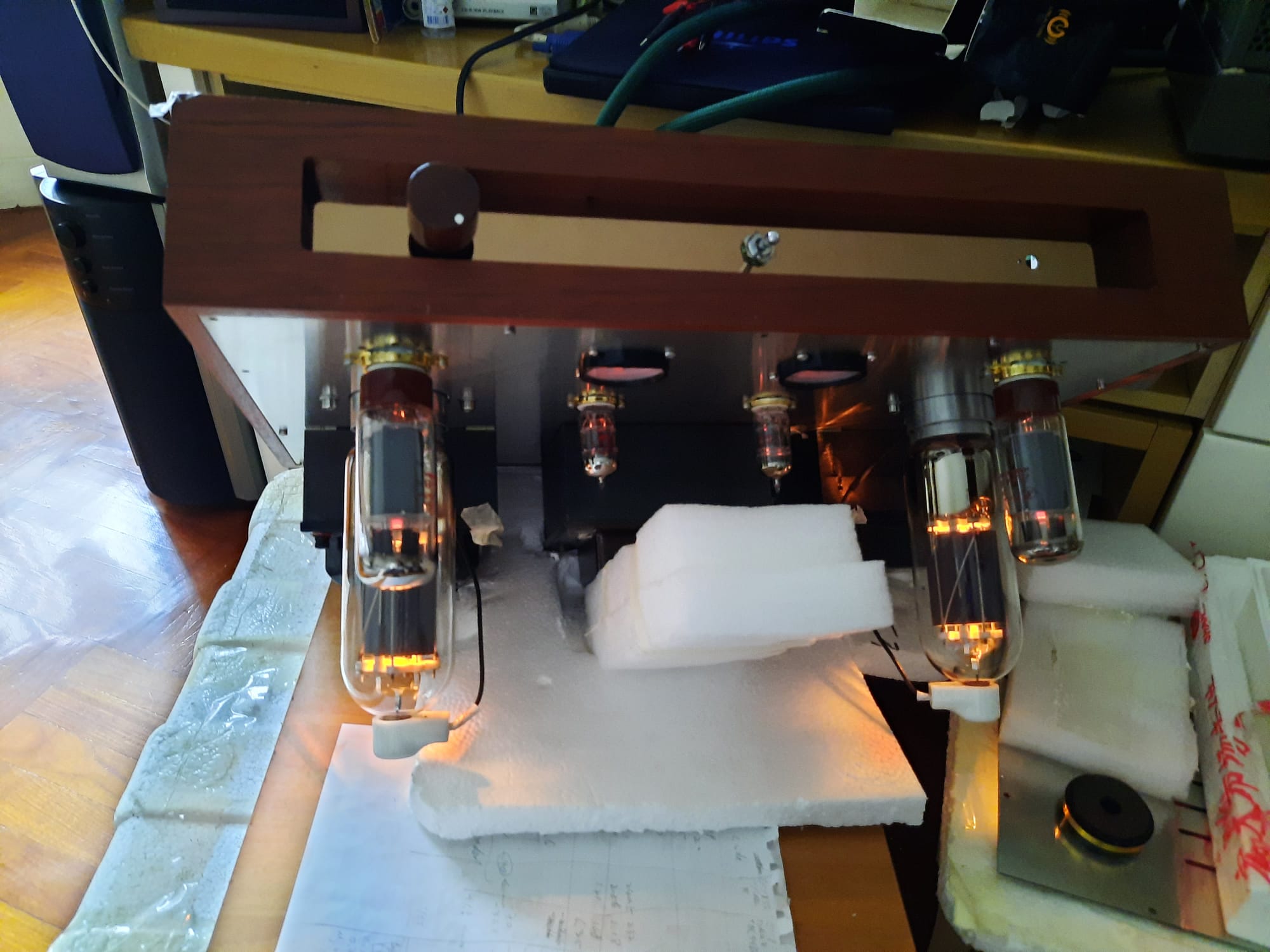

After making a new OPT, the diy tube amp is working now. However, there are some adjustments that I want to figure out.
1. The new OPT spec is that its primary DC current is 130mA (nom), 190 mA(max). With this spec, does it mean that the max DC plate current is 190mA/2 = 95mA so that DC (+/- AC current) = 95mA (+/- 95mA) = 0 to 190mA(max)? (ideal case)
2. Currently, I set the 805 plate current to about 80 mA (allow some safety margin). Is it good enough?
3. Regarding the hum balance pot, I tried to tune it to reduce the hum at the speaker (as suggested by astoufer.) However, seems that there is no noticeable difference at the speaker. The hum level stays more or less the same. Any idea on this issue?
