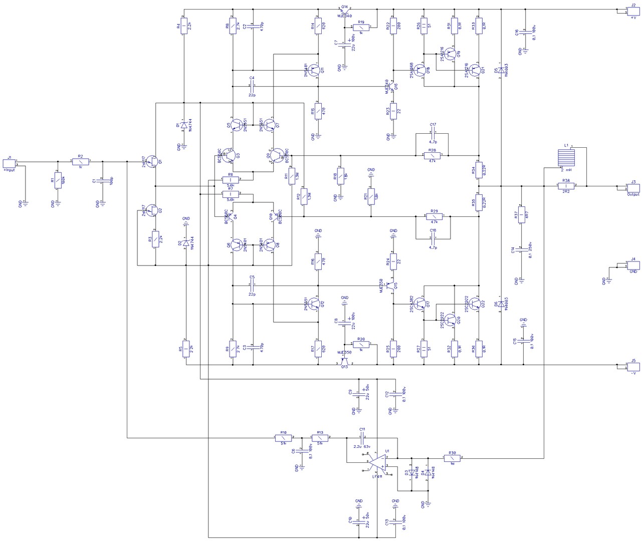

Hi Francesco, here is an updated schematic. In fact, for 30W @ 8 Ohm load, one pair of output transistors is more than enough. However, if we want a 4 Ohm load and up to 50W in class A... that's why I have placed the second pair there.
Not all compensation caps will be used probably. Real world prototype's behavior is different from simulations in most cases, so we'll see 😉
Valery

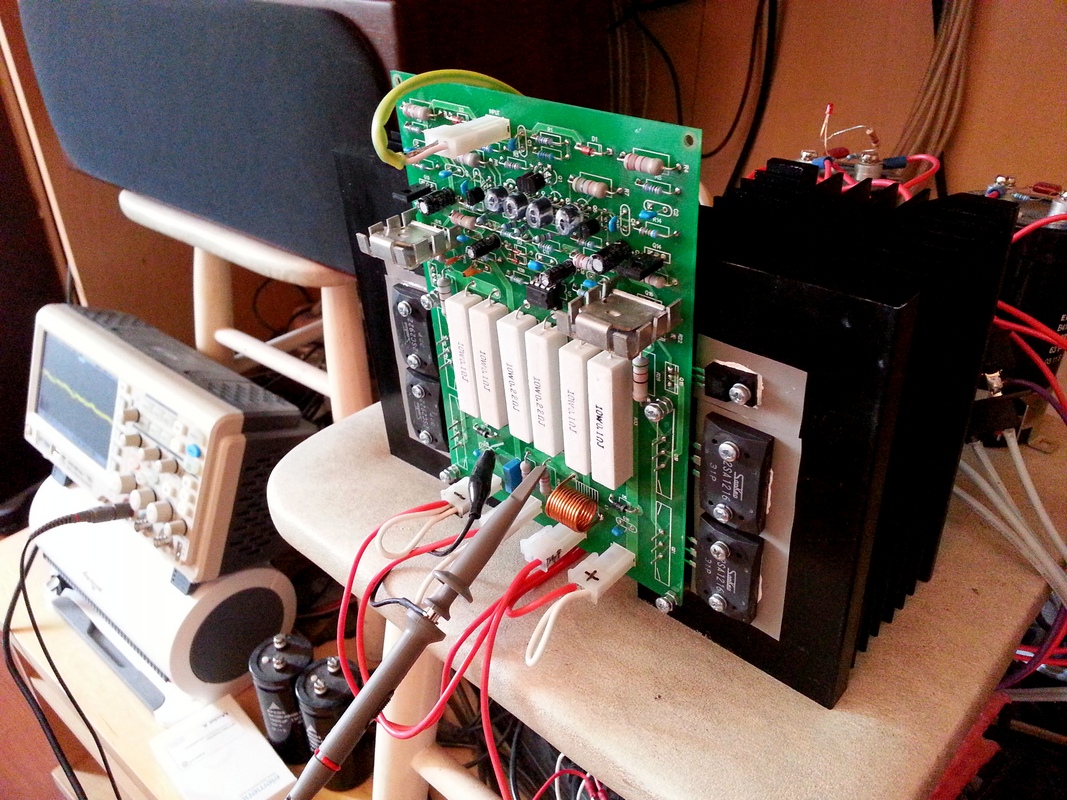

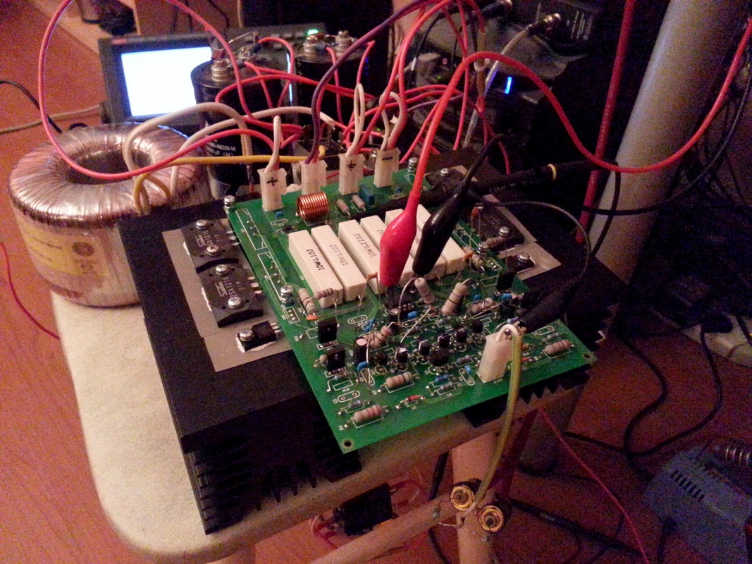

Quick update
Guys, here is a quick update on the development process )
I was a bit more busy the last couple of weeks than expected, however I have finished putting everything together and ran a few initial tests.
I have to admit, I made a stupid mistake while soldering the boards - VAS transistors (2N5401 / 2N5551) appeared exchanged (PNP <-> NPN), causing the signal not going through and neither NFB nor DC servo working at all, with OPS quiescent current somewhere at around 20A 😱
Such behavior made me think something is terribly wrong, I did some measurements, saw the voltage at +/-15V zeners is much lower than it should be (it was +/-3.5V), understood that something dramatically drains current from them and realized the VAS transistors were exchanged.
After putting the transistors to their correct locations, the whole thing started working!
I have adjusted the OPS quiescent current to a pretty low one for the time being (400mA, to be on a safe side), added couple of caps to improve stability and ran some initial tests. See the pictures.
Output signal is 3.2V RMS at 20 Ohm load (deliberately using easy load at the moment). It is not even class "A" yet - it is a high-current "AB", however I really like harmonics distribution (2-nd one is strongly dominant) and the way THD increases with frequency increase (very lightly, no change observed up to 10 KHz and very slight increase at 20 KHz).

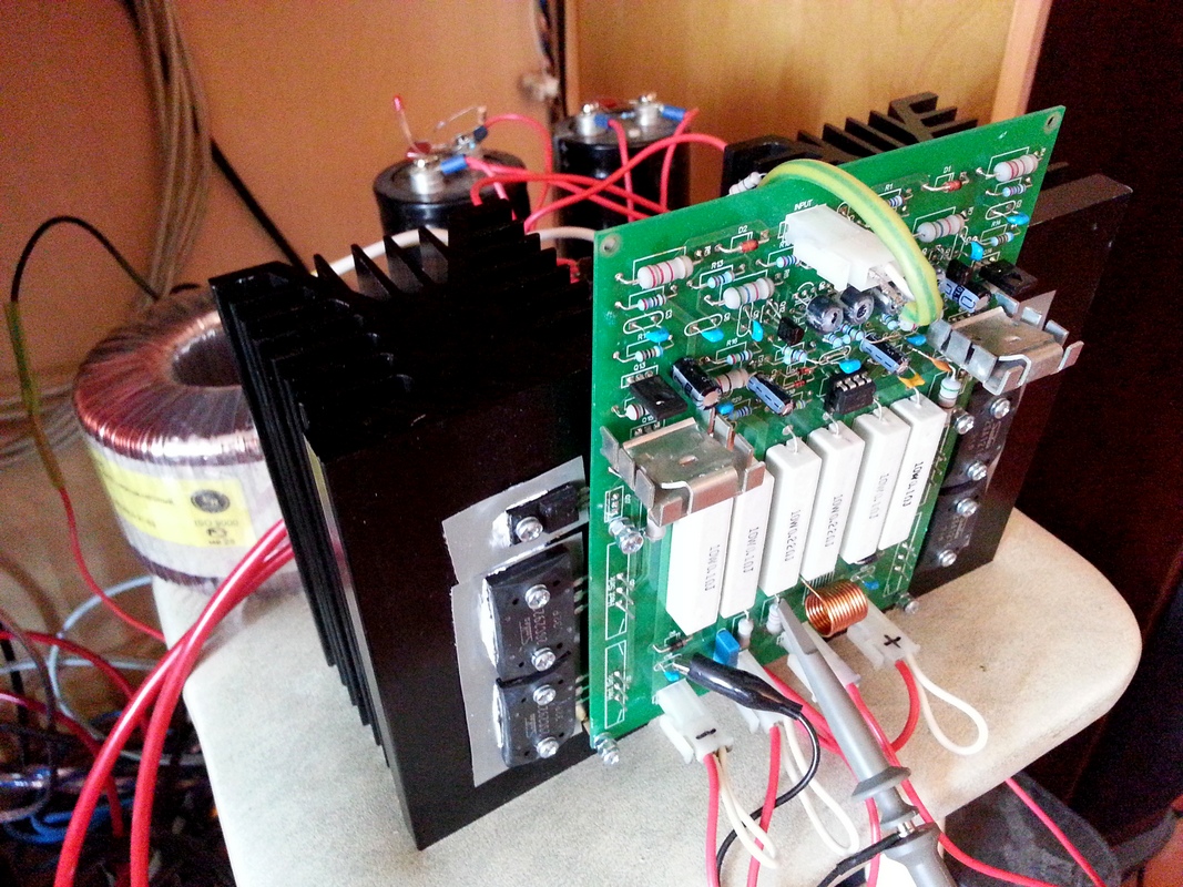

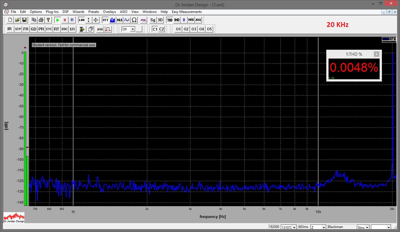

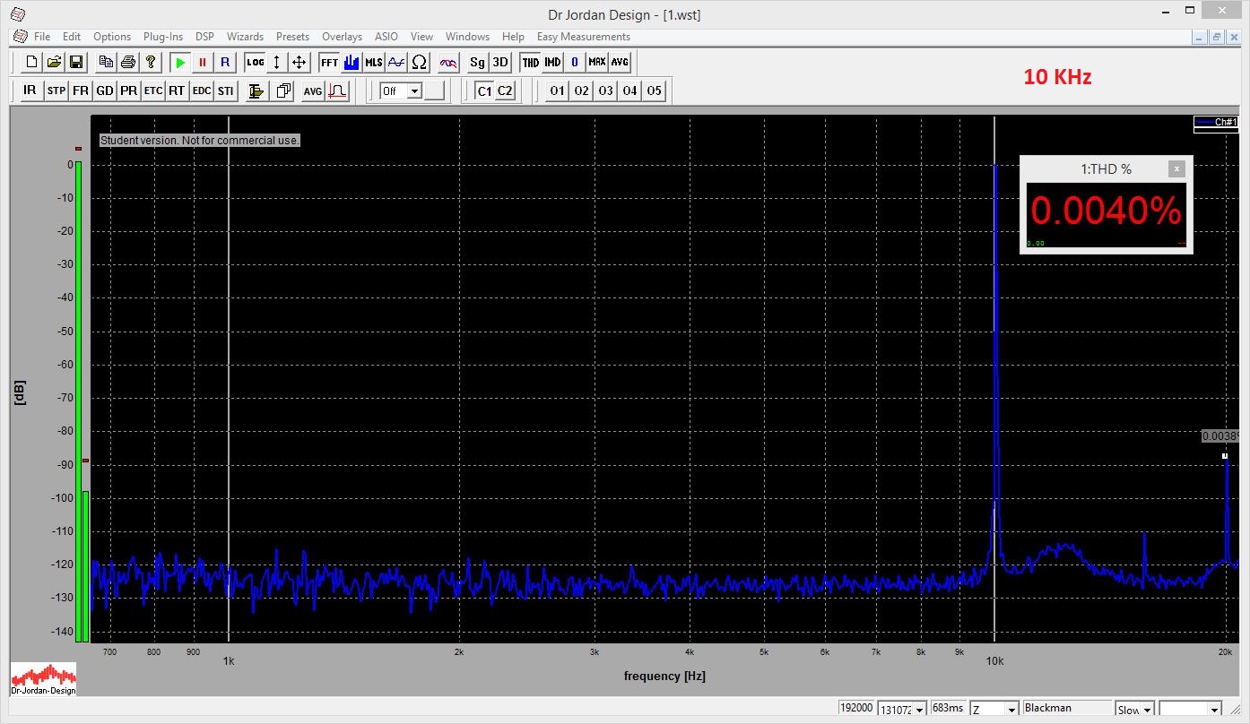

Up and running

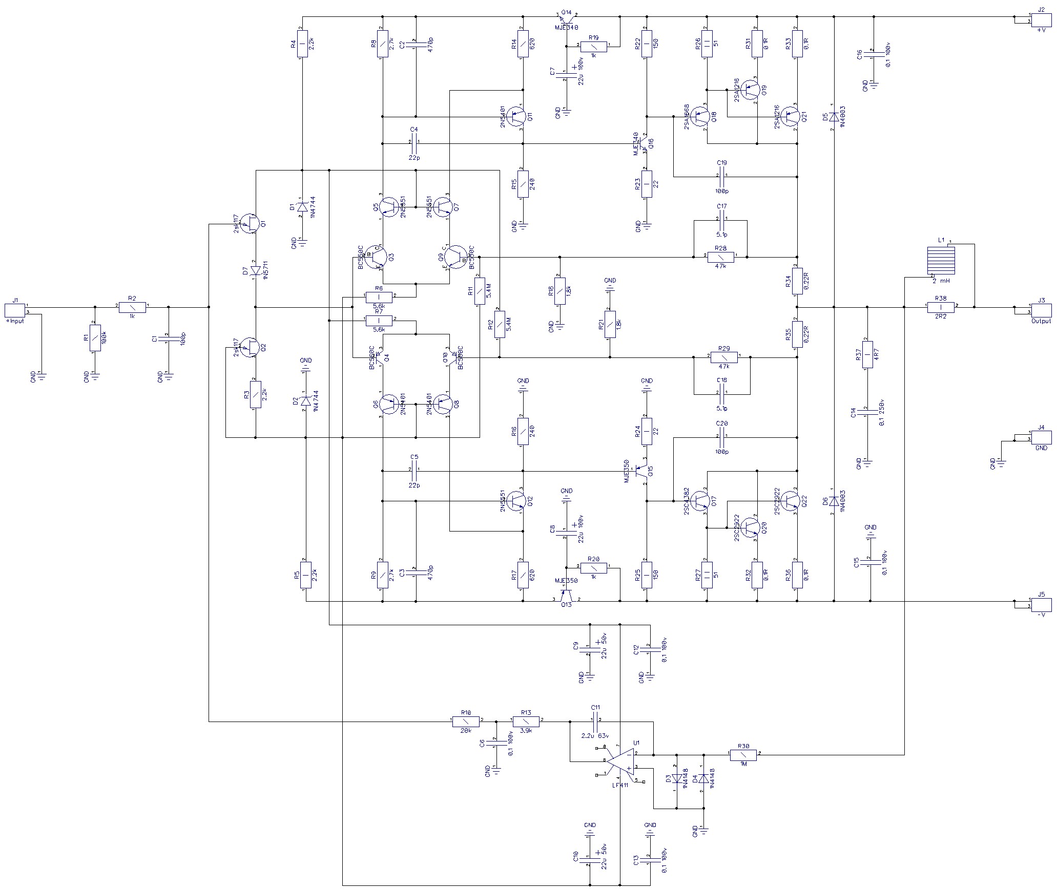

OK. Here it is.
I tried it with OPS quiescent current at 1.7A. Works great, quiescent current is very stable, however with my heatsinks it gets too hot - I can't touch them any more 🙂
So I have set 1A now. The temperature is somewhat around 90 degrees Celsius, rock-stable. Performance is slightly increased comparing to the previous measurements - excellent even at 10V RMS, 8 Ohm load. It's easily possible to go above 2A of quiescent current - just need bigger heatsinks. As always - class "A" amp is a high-performance heating system 🙂))
The very final version of the schematic is attached.

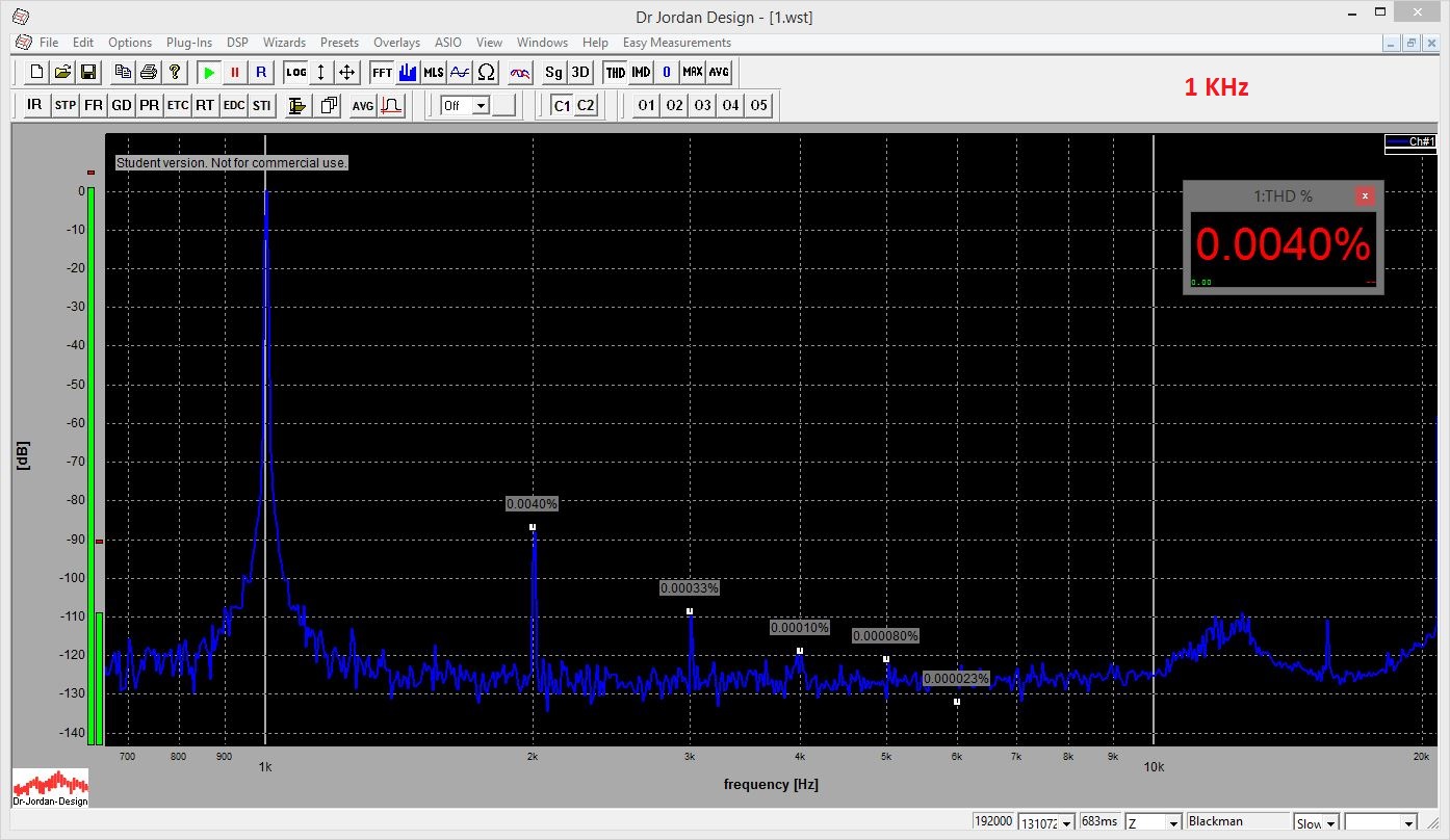

I will publish more graphs and measurements - just need to organize them for convenience. In a nut shell:
- THD is less than 0.003% @ 1KHz, less than 0.009% @ 20KHz - mostly 2-nd harmonic, 3-rd one is roughly 10 times less;
- IMD is less than 0.005%, measured with 14KHz and 15KHz waves at the same time. It is interesting, that the highest harmonics are F1-(F1-F2) and F2+(F1-F2) - 13KHz and 16KHz. The pure differential harmonic itself (1KHz) is negligible (0.0005%);
- Pure class "A" up to around 20W @ 8 Ohm (with 1A OPS idle current), then it seamlessly continues in class "AB" up to around 75W (almost touching the rails), then it clips cleanly and nicely - no sign of saturation (or "rail sticking") whatsoever.
- Square wave response - clean, with slight overshoot (I don't want to fight it though to preserve the other qualities), 800nS rise/fall time at full amplitude (more than 80V/uS slew rate).
As usual, I auditioned it with two Monitor Audio RS-8 speakers, connected serially to the output (6+6 Ohm).
Sound is very, very good - solid, very high-resolution, providing clear separation of sources even with one channel. It somehow gives an impression of a top quality valve amplifier. Extremely comfortable for listening during a long time. Advantages are most noticeable with high-resolution sources - SACD, 24/96 - 24/192 lossless digital formats.
It is highly repeatable - absolutely self-balancing design, no adjustments required if no mistakes are made and elements tolerance is reasonable (I used 1% for most of the resistors and matched in pairs all the transistors except the input FETs, drivers and OP big ones). Sanken rules again ))
If you want to change the OP idle current - just change R11 and R12 (the less the R value -> the higher the current). 2.7M will give you around 1.4A, 2.2M - 1.7A (this is what I practically measured, if you want higher currents - decrease the R value, but don't forget to use the bigger heatsinks).
For those who'd like to build it I provide full technical support 😉
Just be prepared to feel some heat 😀
Carlos - thanks again for inspiration!
Valery

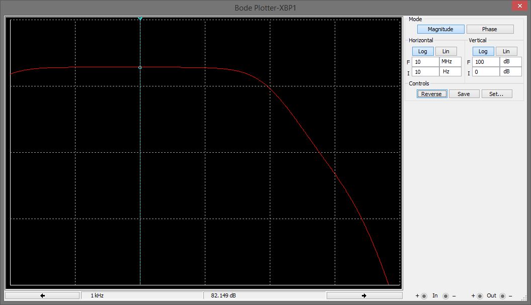

Congratulation Valery, as always very good design, not so simple, but then I myself usually could not keep KISS principle.
Could you show the Loop Gain?
Damir
Damir

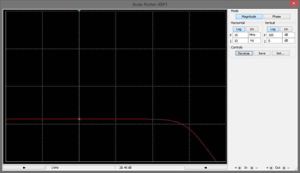

Thank you Damir 🙂
I can show the gain with open (1) and closed (2) GNFB loop - see attached.
So, the loop gain is roughly 82db - 28db = 54db, at least within the audio frequency range...
