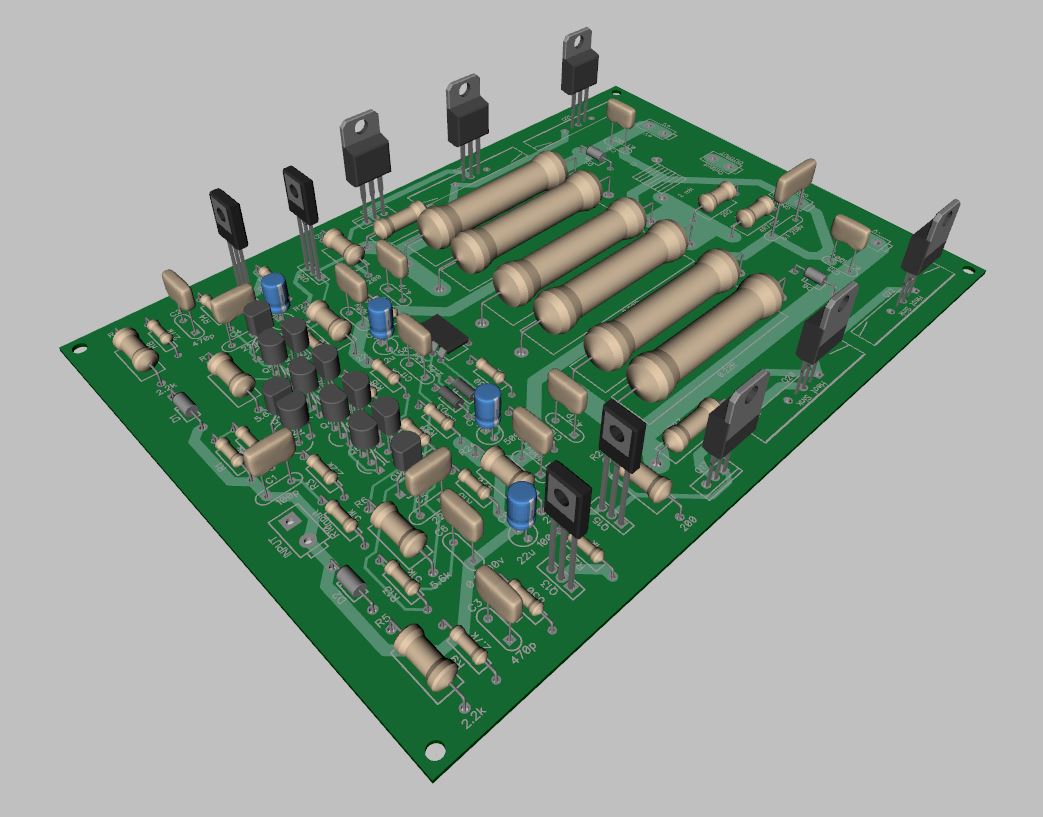

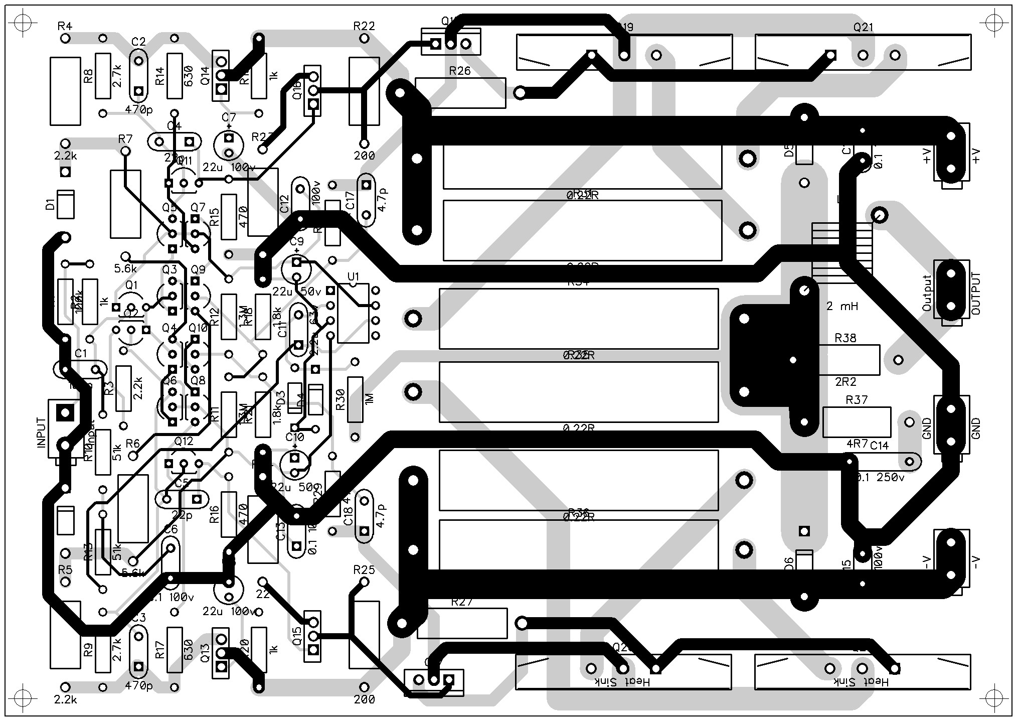

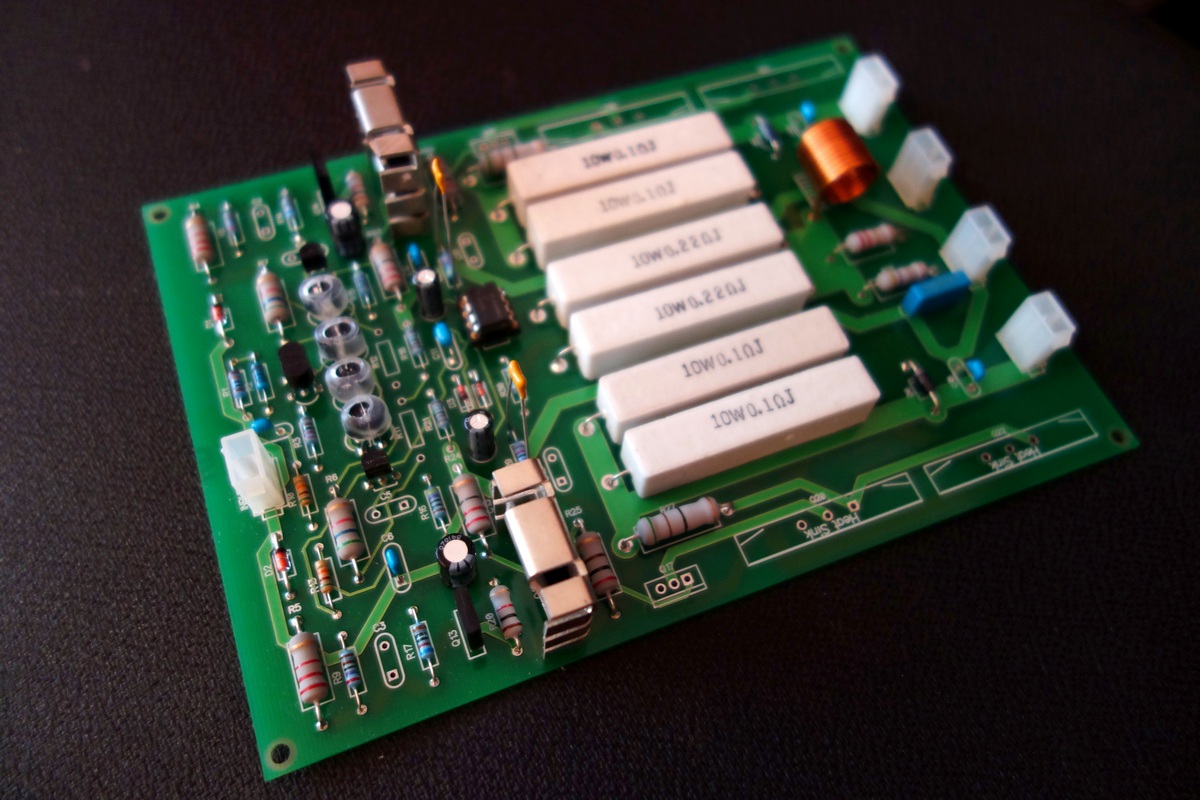

Building a prototype
Further improved schematic - added JFET source follower at the input, some other stuff... waiting for a PCB to come from the factory (couple of days)...
Some elements are shown in the wrong cases in 3D view - never mind, this is just to give an overall idea.
Valery
Valery

2 Valery
If it is according post 16 ,output triples with voltage gain, closed in global feedback loop, it will be very prone to local instability. Very tricky to get it stable, very dependant on transistors used, on PCB parasitics. Simulation do not show thisFurther improved schematic
2 Valery
I know 🙂 Had some problems with CFP OPS in a wide-bandwidth design recently... However, this one is less cranky than CFP, so... we'll see 😉
