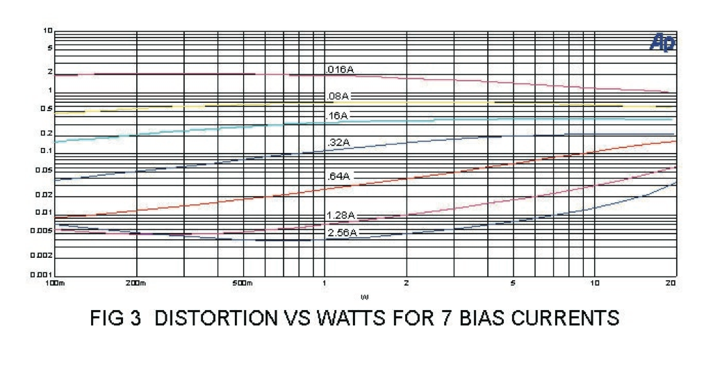

But apparently for mosfets there is no biasing sweet spot, i.e. the distortion goes down and down until the transistor fails from heat (excess current). Seems to me that for us DIYers the practical 'sweet spot' is balancing the minimum number of devices in parallel to supply sufficient current needed for an intended power level into an intended loudspeaker load. So it's all about designing the amp for the load...
I still wonder if the advantage of multiple mosfets is more about total current capacity and DF. From what I have read, Andersonix seems to be correct that with increasing current, both THD and higher order harmonics drop. THe only exception I have seen is in lateral mosfets. I believe this app note shows that at some point, the laterals THD plateaus and begins to get subtley worse. I assume this is related to Yfs ceiling, which is not present at reasonable bias levels on the other fets tested.

BTW, that Fig 3 Distortion vs Watts graph is from NP's 'Leaving Class A' article, and as bias current goes up, distortion goes down and into the noise floor, so there's not much point in going too crazy with the bias unless the PS and 'everything else' is also very 'quiet.' More bias -> more PS ripple... on and on...
