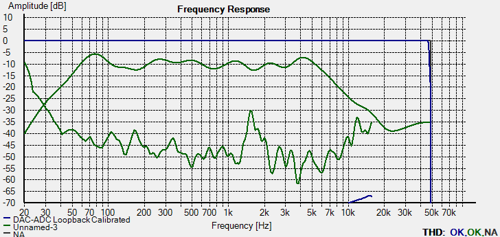

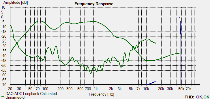

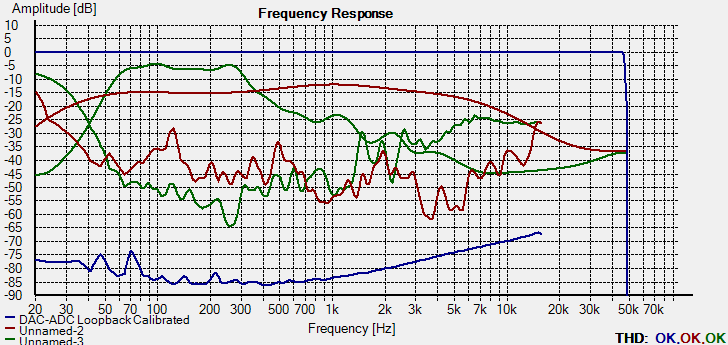

Here are some in room response charts.
jer🙂
