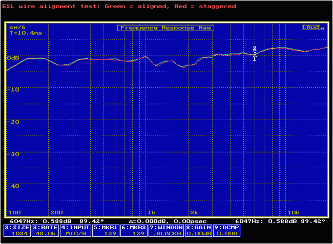

I agree they will look better if aligned, but, logically thinking, it seems they would be more efficient if they overlapped. :cheers:
A few years ago I did run a test comparing response with front and rear wire stators lined up .vs. staggered.
I can't remember the exact D/S and wire spacing, but the wire diameter and spacing between the wires was < D/S.
There was no appreciable difference in efficiency/sensitivity, or distortion.
If the spacing between wires got to be significantly larger than the D/S spacing, most likely there would be some differences between the two cases.
