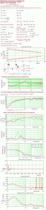

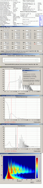

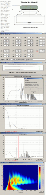

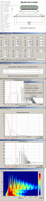

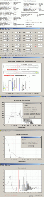

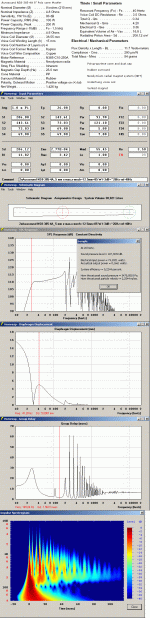

Hi zman01,Rullknufs...all
Reading this thread, I searched MA #6 in my computer and found a Zman-folder with sim. suggestions that seems not to be sent? Don't know for which tread but I guess they were targeting to extend FR-drivers?
Here they are again?:
b
3-2xAurasound NS8-385-4A_T-TQWT_using-Dayton Audio MCA2550E-amp.GIF141.1 KB · Views: 706
6-AurasoundNS8-385-4A _T-TQWT_as_an._OD-TL_30L_225cm.GIF61.7 KB · Views: 69
