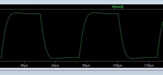

OK, with Mooly's welcome help, I have simulated the Quad 303 circuit in Spice. Using this solves the question discussed earlier of the discrepancy between the Vrms^2 / R calculation (70 Watts) and Quad's specification of 45 Watts. Here goes -
Total dissipation in output transistors and emitter resistors,goes like this: Q1=11.928W, Re1=0.8785W, Q2=11.822W, Re2=0.81318W. This lot totals 25.44168W. Power in the 8 ohm load is as Quad states - 44.627W. Adding the non-output dissipation to the load dissipation gives the formula's predicted total of 70.07W (formula gave 70.15W).
I now understand what's going on. The experts were right (as they were bound to be!). A lesson for me about the caution to be used when predicting with that formula. Thanks to all of them for their patience - and especially to Mooly for his help.
