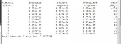

OK, here we go...
The "Quad 303" file is using standard spice library models.
The "Quad 303 using Cordell models" file uses models by Bob Cordell. The diodes must have a slightly different forward volt drop to the original Quad parts. This needs the addition of R29 (72 ohm) to generate slightly more volt drop. Without this the quiescent current can't be set high enough (5 to 10ma).
The "Quad 303 optimised" file is prepared for simulation.
Notice how I have removed the input coupling cap for simulation by adding an offset voltage to exactly match the voltage that was on this cap. A voltage source has replaced the resistive divider and 300uf cap. The 50uf bootstrap cap has been reduced to 1uf. As we are not testing at low frequencies this is acceptable.
Quad 303 distortion at 1 watt show distortion and FFT. For the FFT plot increase the number of cycles (the input signal) to 1600 and the .tran command to 800ms. Look at the last 8 cycles by starting the FFT at 792ms and ending at 800ms. The distortion (spectrum) isn't as "good" as I thought it might have been.
