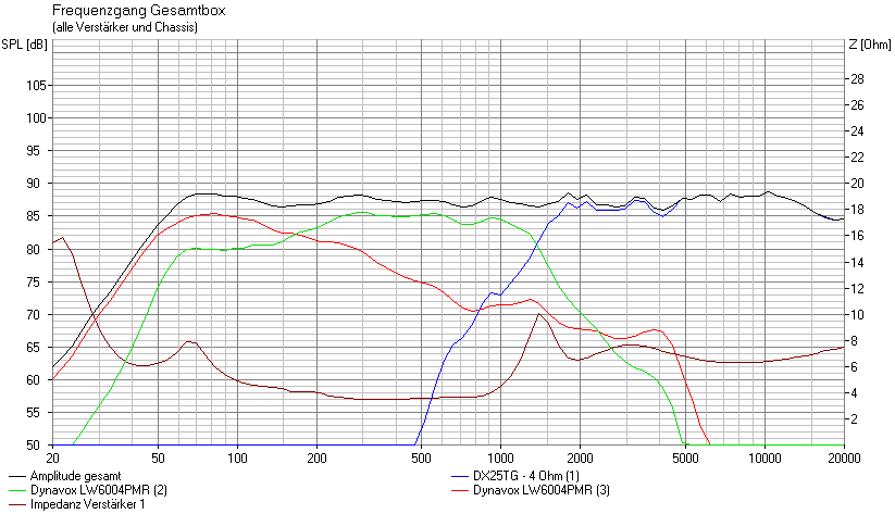

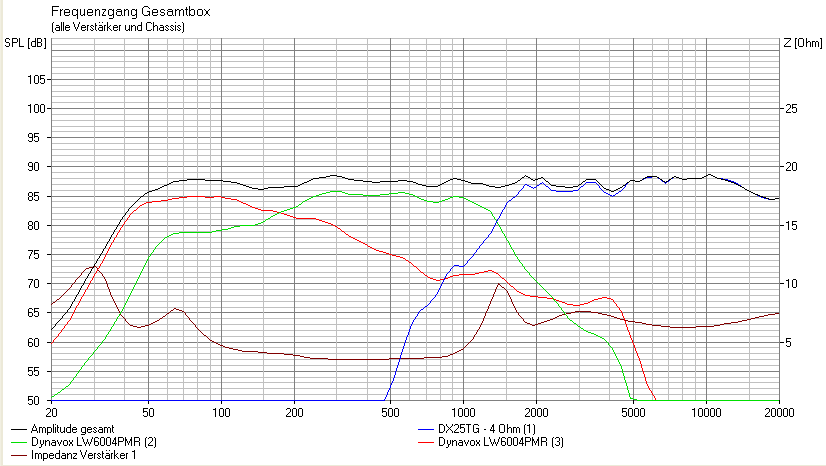

I have some Dynavox LW6004PMR 6-1/2" woofers. I would like to create an MTM with the Vifa DX25TG-05-04. Idealy I would like to use a 1 cu/ft ported box.
Why you need your 1 cu/ft box. It doesn't work like that. You should have, at least, a 40L interior volume enclosure (+ vol. of drivers, port, wood), instead of the 1cuft/28L interior you ask.
Dynavox LW6004PMR 6-1/2" Woofer
Vifa DX25TG-05-04 1" Fabric Dome Tweeter
Now with a 30L/45Hz BR, and a 10L closed box for the second driver you get an interesting MTM loudspeaker.

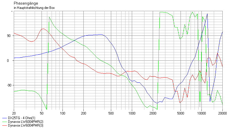

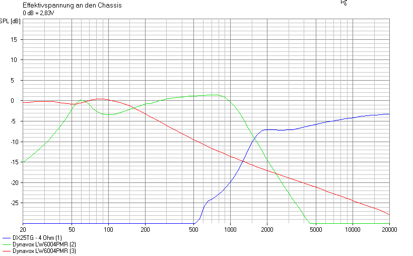

Xover MTM Dynavox LW6004PMR 6-12 + DX25TG
MTM Xover for 2xDynavox 6 1/2" Woofers and Vifa DX25TG-05 1" Tweeter.
For simulation, gave the approx. dimensions for the front baffle (HxW): 500x220mm
(Good that the f/z data files where available for simulation):up:

The best reassurance is if you can make a successful design, and test it (for you and for us). Now that was one, between a few different, of the possible MTM designs. You can see that it looks like a 3-Way design. You can also go for a pure MTM, but I will leave that at your discretion, since this design seems to work very well (with difficult/not-so-easy drivers), and a good way to start-up your project. If you leave the xover outside you can make adjusting more easy, but have in mind that, in this case, the enclosure is different/separated for both woofer/mid-woofer.

You show the design for a speaker, in your last, and in another previous post. Please, express your intentions in relation to the xovers and methodology (type of xover) you are working on. This is because I think that your xover wasn't adapted to this type of box, but a 3-way MTM xover I posted previously for you.😀
