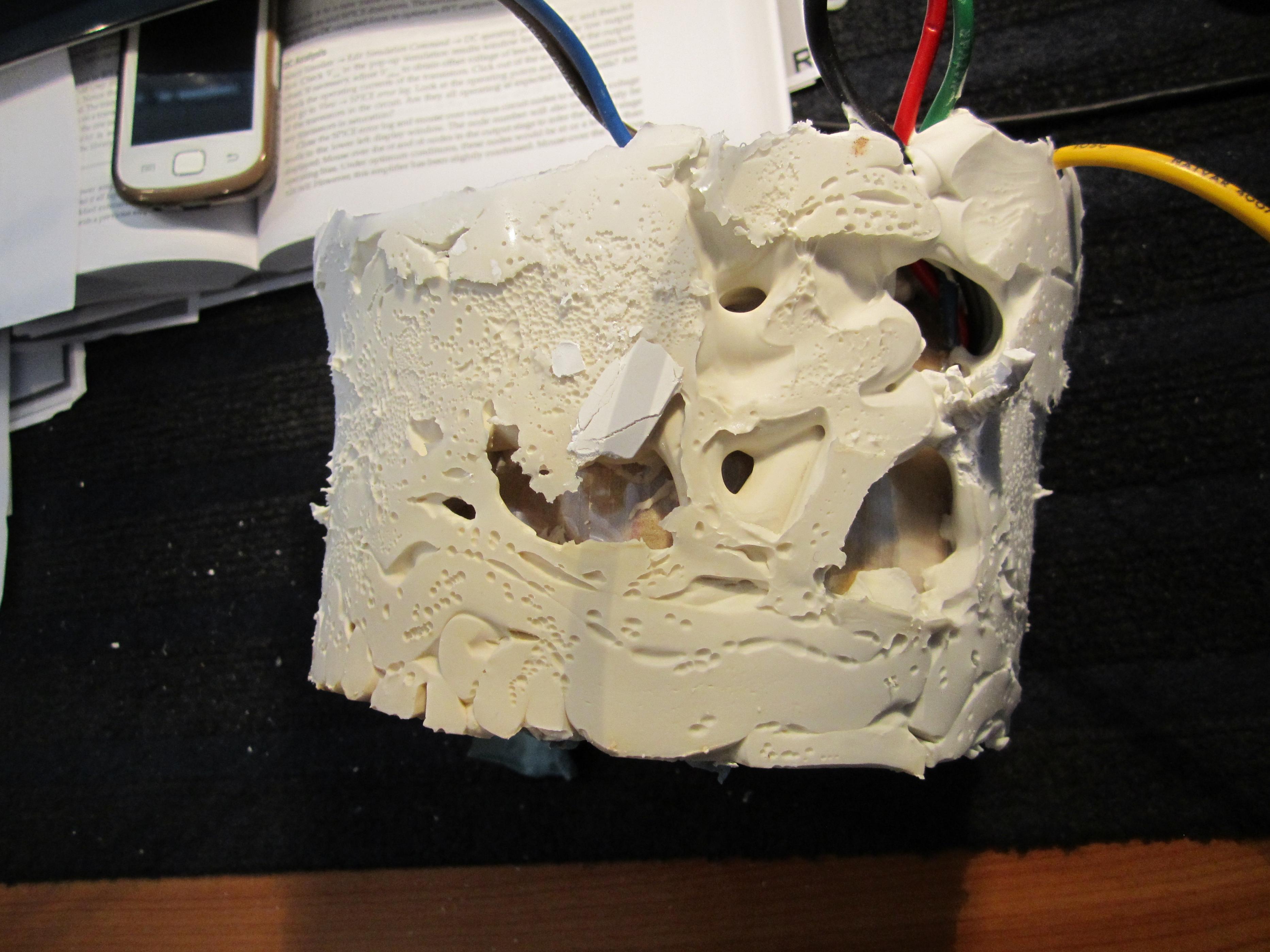

Unfortunately the transformer is immersed in some chalk or similar
Is the white circular thing ... 🙁

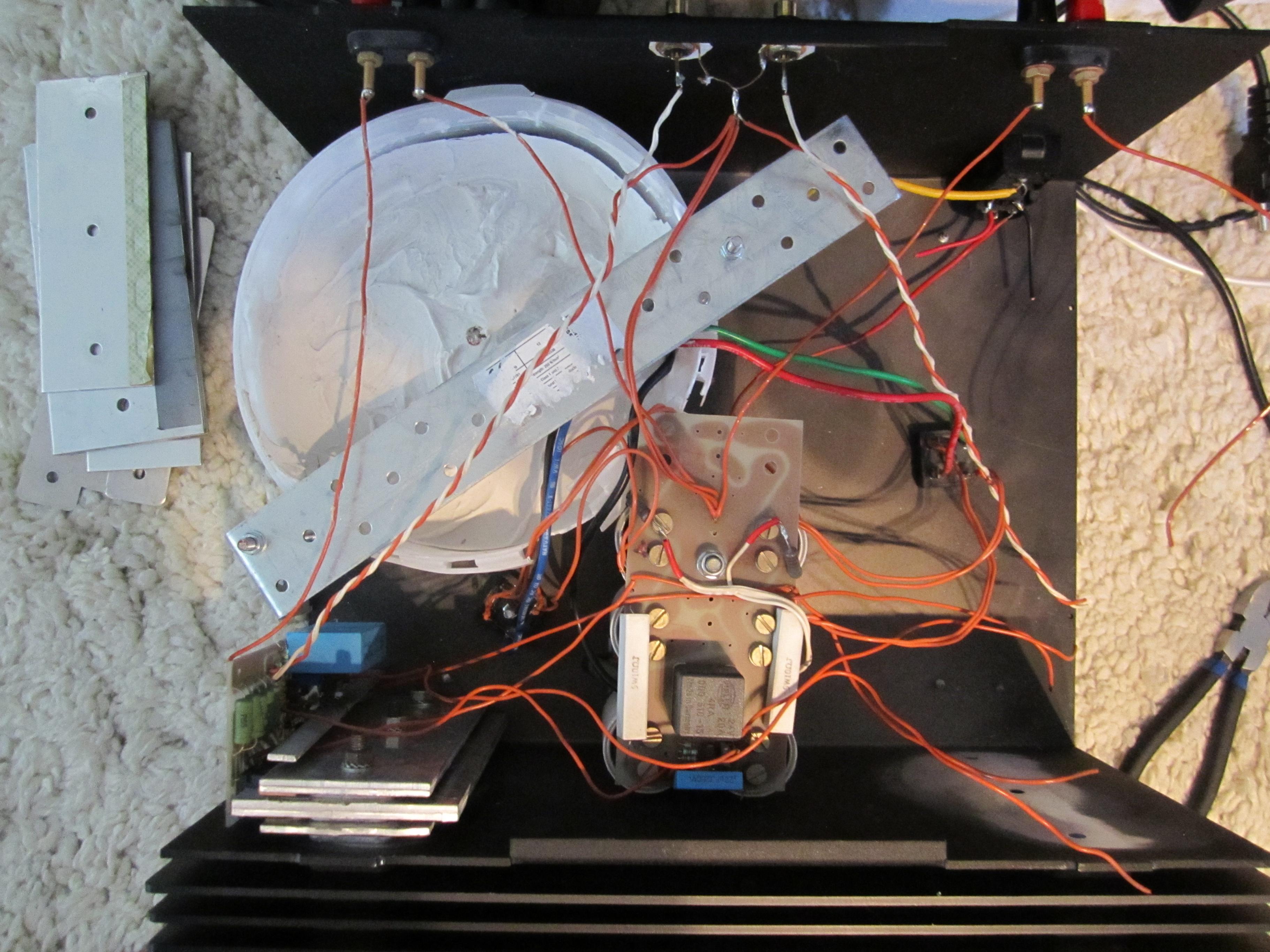

I'm not so sure its a good idea having a metal clamp over the transformer. You mustn't created a "shorted turn". That can happen on toroidal transformers secured with a centre bolt and where the top of the bolt can touch the top of the metal chassis. I think you're OK at the moment with that because what you have doesn't pass through the centre of the core.
The construction of this amp is clearly not that of a masterpiece 😀
It worked just one day ... and it also sounded pretty nice with a nice soundstage
It has also made me change my feeling about multiple output devices
I think the problem was in a relais in the power supply
I tore everything apart 😱

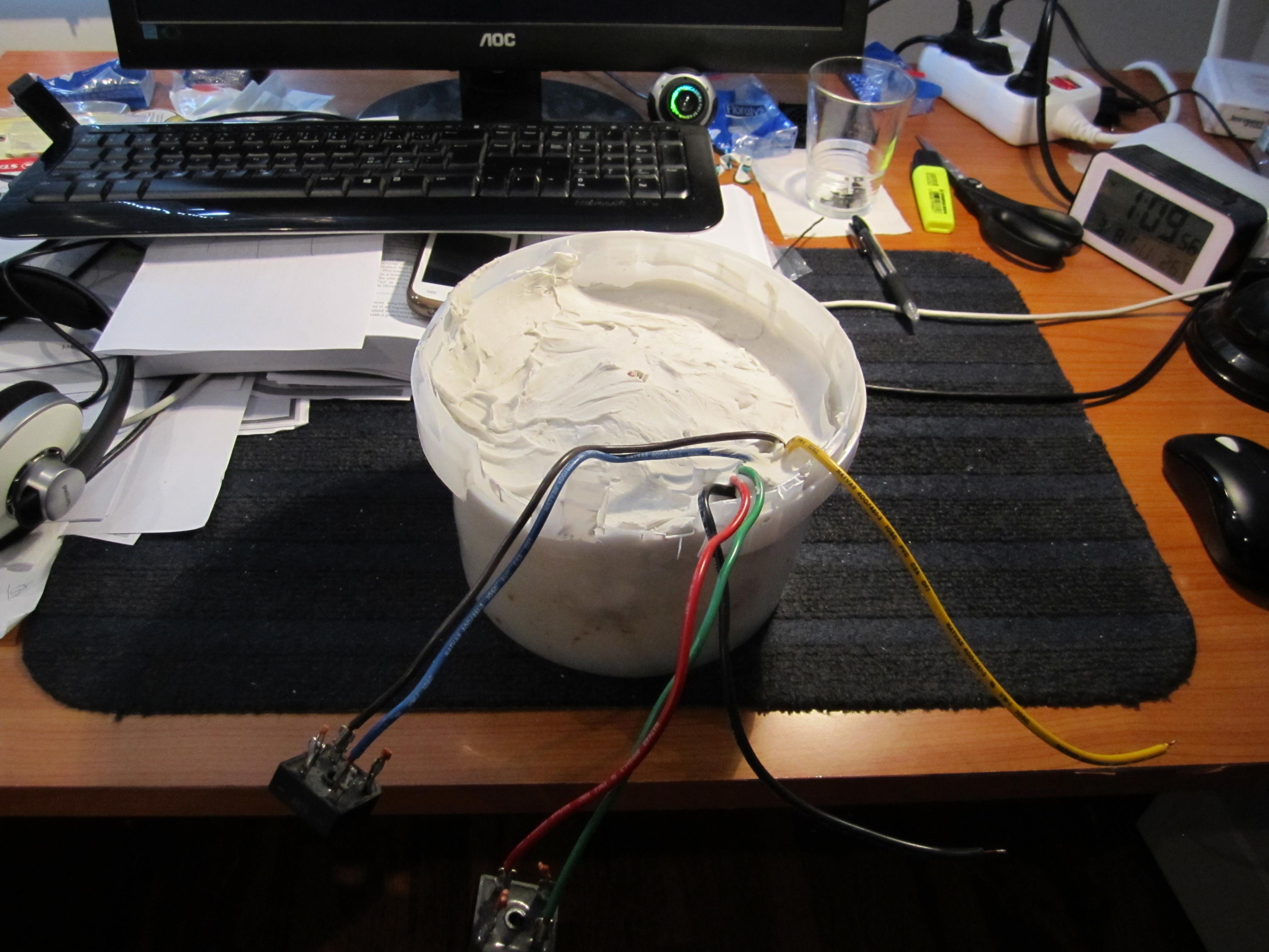

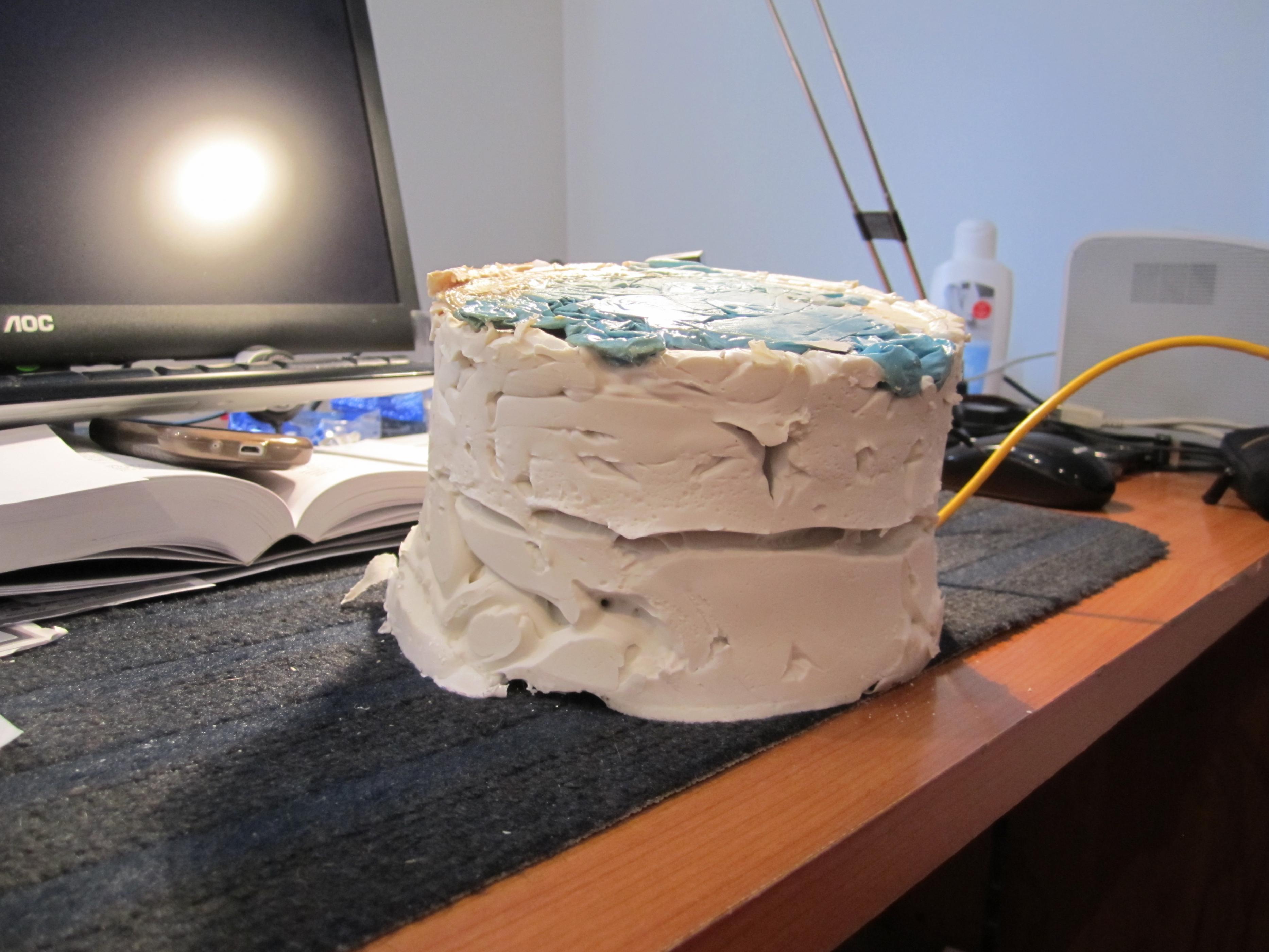

But the potting ... it is tremendous
Just look here ...
It must be the work of an audiophile 🙄😀

Looks more like a birthday cake gone wrong 😉 It is indeed tremendous potting. I can't say I've ever seen anything quite like that tbh.
😀 just image my expression when i opened it ... i was even scared
I do not even understand what they have used because it is slightly rubbery ... like some plastic ??? it is not chalk
For this reason the builder should be an audiophile
