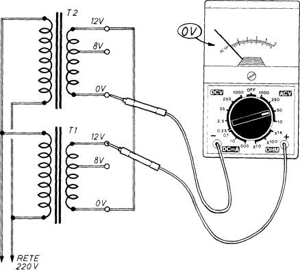

Its easy. You have two secondaries and four wires. With the transformer not connected to the mains identify using an ohmmeter the secondary pairs of wires. That means you pick one wire at random and measure on ohms to the other three. Only one of those three will give a reading. That makes one pair. The other two wires make the other pair.
Now connect one wire from each pair together. That means you have two unconnected floating wires.
Switch the transformer on and measure the AC voltage between those floating wires. If you find you have the expected voltage (twice the voltage of one winding) then the CT connection is correct. If you have a very low voltage or zero then the connections to one winding only must be reversed.

If i connect the secondaries wrongly, can i damage the transformer ?

You can't damage the transformer doing what I outlined because there is nowhere for any current to flow with the wires still floating.
