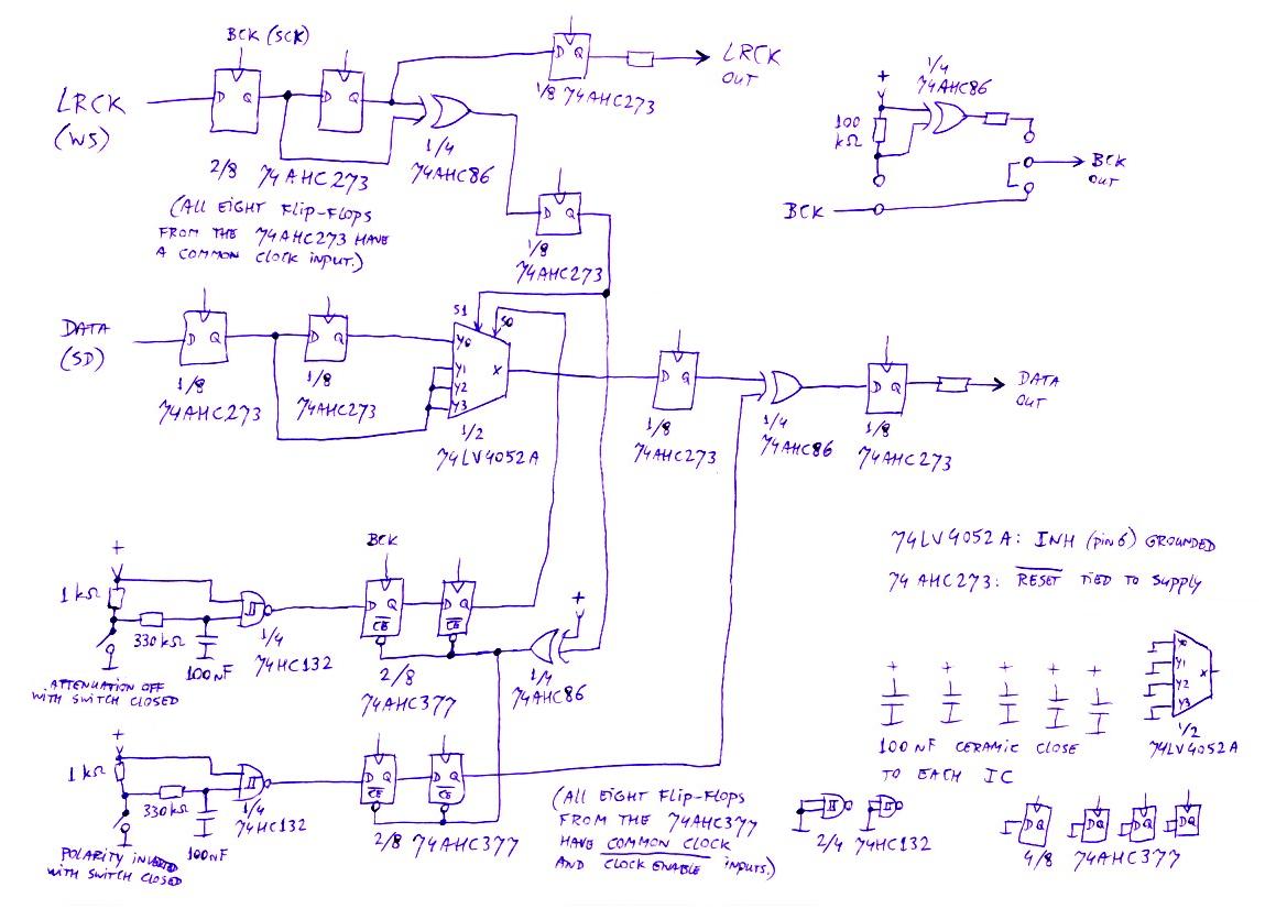

Solving the intersample DAC clipping problem for about ten euros

If you don't mind hearing a click when you switch over, the circuit in post 1 can be switched in/out with a switch to ground and a pull-up resistor connected to the active-low set input of the second flip-flop in the bottom row. Changing absolute polarity can be done with an EXOR in the data line, if you don't care about the 1 LSB offset that gives you.
In fact you could use an 74AHC86 quad EXOR as polarity changer, clock buffer and delay circuit to prevent hold time issues.
I made a stupid mistake, I meant the active-low set input of the third flip-flop in the row that starts with LRCK.
Taking into account all comments in this thread, I came up with this improved version (also neither tried nor tested). The capacitance on the clock line is reduced by using two octal flip-flops where all eight units have only one common clock input. The switches allow one to switch on and off the attenuation and to invert or not invert the signal, switching between modes is always done at the start of a new word.
The input has a 1 ns hold time requirement, which is not in accordance with the 0 ns required by the I2S standard (property of the SN74AHC273, most other AHC flip-flops are worse). This will usually not be a problem, but when it is, it can be solved by delaying the LRCK and data signals with an RC filter.
