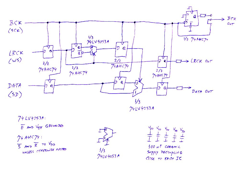

Assuming two's complement data sent over an I2S connection, the attached circuit should be sufficient to attenuate the signal by 1 bit (6.02 dB), thereby creating 6.02 dB of headroom for intersample overshoots. If your DAC has 110 dB dynamic range referred to 0 dBFS, it will be only 104 dB after installing this circuit, but in practice that still means you don't hear any noise at all. Mind you, it is only a paper design so far, I haven't tried this circuit.
The circuit shifts the whole signal one bit to the right and applies sign extention (repeats the MSB). This means that 16 bits data become 17 bits, 24 bits become 25 bits et cetera. When the number of bits gets larger than the DAC or the ratio of bit clock to word clock supports, the LSB will be rounded down bluntly without any dithering. In practice this is no problem for DACs with a large input wordlength, like 24 or 32 bits DACs. For a 16 bits DAC, very soft signals will be degraded by the extra quantization distortion.
Built with 74HC74's and a 74HC4053, the circuit should be able to handle 44.1 kHz and 48 kHz sample rates at 3.3 V supply voltage, and 96 kHz at 5 V. With the indicated 74AHC74's and 74LV4053A, even 384 kHz at 3.3 V should be no problem.
The values of the output resistors depends on the lines between the circuit and the load. When the wires are short, no resistors are needed, otherwise they need to be chosen such that reflections stay limited.
The top right flip-flop is abused as an inverter.

Your second paragraph is a good reason why it is a good idea to look for a DAC with voltage headroom, the more the better. Then one can do a digital volume reduction at -6dB or less and still get enough gain out of the DAC.
Marcel, what is the motivation for doing your hardware modification versus using digital volume reduction? You mention CDs, so perhaps your application is intended for hardware based playback like a CD player where there is no provision for digital volume control?
That's a very clever circuit. In exchange for eliminating an occasional clipped sample, which would probably be inaudible, you reduce the available dynamic range by 6dB, add distortion, and increase BCLK jitter. Well done!
If you already have a digital volume control before any filter, you can use that of course. If you have no digital volume control or if any kind of sample rate conversion or filtering takes place before the digital volume control, then you are in trouble.
On what do you base your assumption that 3.7 clipped samples per second are inaudible, while a slight increase in a minus one hundred something dB noise floor would be a problem?

and to mention that the BCK inversion is optional; it improves hold time at the expense of set-up time, but is not required according to the I2S standard.

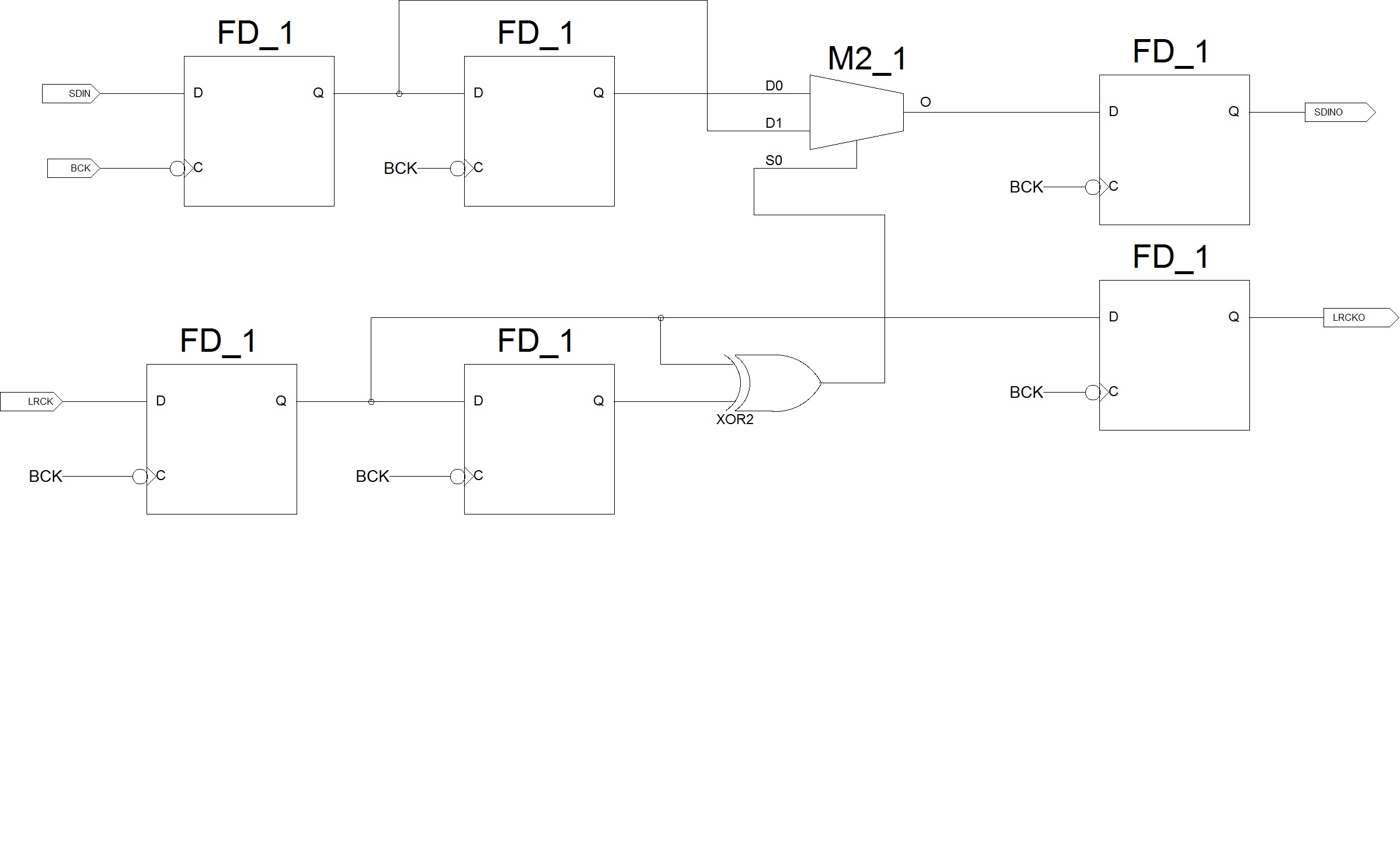

It's interesting. I have IIS interface configured by FPGA to pcm1792. It takes few hours to add "divide by two" and reconfigure. It worked successfully. The attached is schematics. I am out of date person who still uses the schematic entry to design FPGA. But I'm sure it is useful to understand circuit visually.

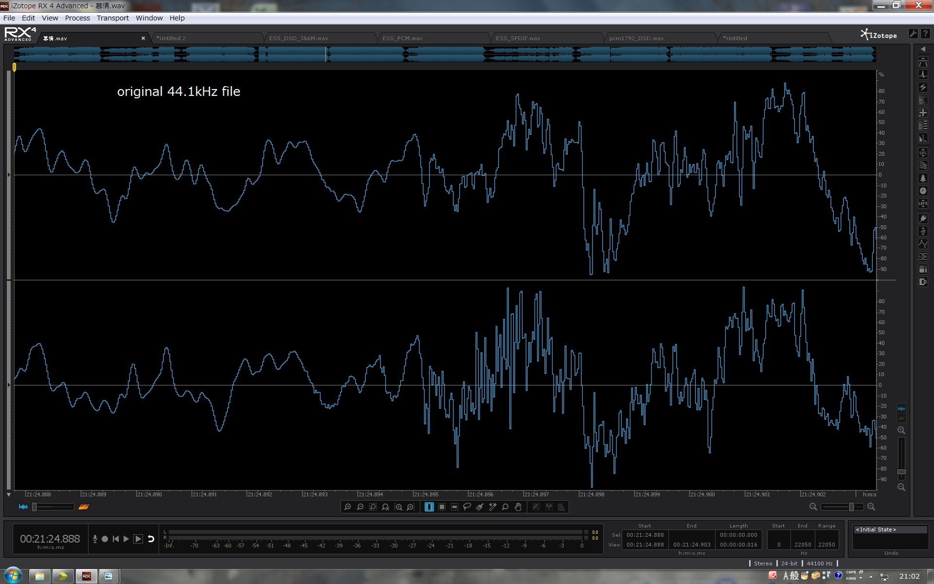

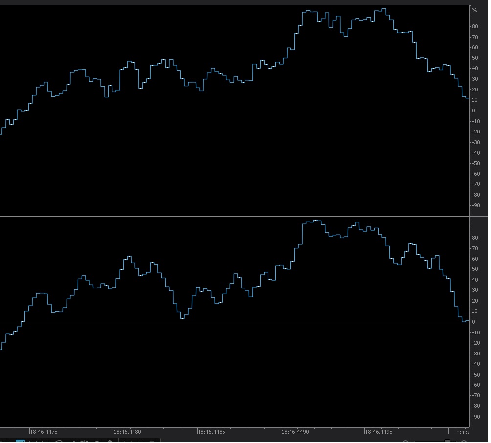

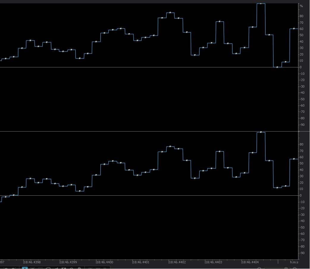

The attached are recent music files ripped from CD. You can easily find several clipped sample points(0dBFS). Their usual maximum level is almost -0.3dBFS(97%) which has a good chance to have intersample overs though it depends on the oversampling process. DAC manufacturer has no responsibility for this because they can't predict what music files are played by a customer. A customer must recognize the probability.
No oversampling filter, which means NOS, is one solution. DSD stream is another one which inherently no need to have an oversampling filter. Some people say DSD has quiet sound like high sample rate files. I'm sure DSD is free from intersample overs but not sure it can have quiet sound because DSD has much quantization noise from 20kHz.

You've cut the available dynamic range in half. You've changed a 16-bit DAC into a 15-bit DAC. You've added quantization noise to every sample. The typical CMOS input gate adds 1-15pf to the net it's on. PCB traces, etc. add more. That added capacitance is a low-pass filter that slows the clock signal, increases the propagation delay, and slows rise times. That hardly matters with data, especially at digital audio data rates, but is surely matters with a clock. Increased prop delay means increased skew. Slowed rise time means the signal spends more time in the no-man's-land between zero and one, which increases the uncertainty of exactly when clock edge happens and that is jitter.
If removing intersample noise with this circuit is so important, a very simple circuit change will solve the potential jitter problem. Add a buffer to the BCLK tap. E.g., Si53365.
A better way, if you are using S/PDIF, is a simple mod to the S/PDIF receiver to it right shift the data one or two bits with sign extension. Such a circuit, implemented as a drop-in replacement for a CS8412, was posted on the Audio Note forum a few years back.
The circuit is meant for modern oversampling DACs with an interface of 24 bits or more. The extra quantization noise will then be at -140 dBFS or less. As DAC manufacturers compete on price and dynamic range, most of these DACs have dynamic ranges far in excess of what is needed for normal domestic listening, so I don't consider a 6 dB loss a big deal.
Thanks for the suggestion, it is the first constructive contribution you made to this thread. If anyone wants to use a buffer, please check that its delay doesn't introduce hold time issues. If it does, data and LRCK also need to be slightly delayed.
That's functionally the same as what I propose, so how is it better? In any case, if you are so worried about jitter, don't use S/PDIF.

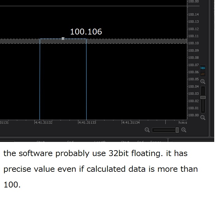

I did software simulation from 44.1kHz to 88.2kHz. The target is recent "loudness war " files which I posted before. This is my first try which means no special selection. But I found three intersample overs in five minutes files!
My software, which probably uses 32-bit floating point, can calculate precise value even if overflow occurs. One intersample overs is about 100.106. This is a little bit higher than 100 but has a disastrous result.
Most digital filter usually doesn't have overflow protection. More than 100 means from max positive value to max negative value(from 0x7fffff to 0x800000).
My digital filter doesn't have overflow protection(limiter) but has 0.5dB headroom. In this case, no overflow occurs. 0.5dB headroom is usually sufficient from my experience. But "loudness war" files have a chance to break my fire wall and make overflow.
