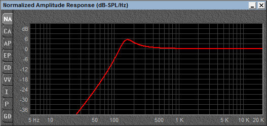

How about using ported box for rising low-end of the midrange driver? Example attached - 150hz port for Tang Band W8-1772. Crossover between bass driver and midrange could be at ~200hz.
That would require a very wide cabinet.
