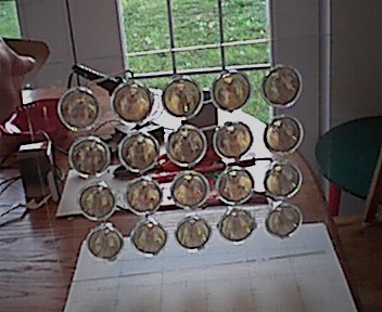

well, at least it looks cool....
Thought the best mounting would be silicone to a sheet of glass.
OK, my first light up of the array -- and not exactly what I wanted.
I wanted a very parallel light source, but this is rediculous!!! In order to get a perfectly even light, I need to have the array almost 20" away from its target in the current spacing of about 1/2" between bulbs. I'm still seeing spots too, man is that bright!
I had to turn the brightness all the way down on my camera to even get something that is visable. BTW -- the lights are on in this pic and there's only 10 of the 20 bulbs lit!!!
I'll post more as I experiment. I think I'll break out the welding mask the next time I light it up -- I have a headache now....

yea somthing like that. Last pics for the night, I didn't wait until the silicone cured, so my bulbs started falling off the glass. while I was playing around with it.
I did get a somewhat focused image -- I could never get it focused out to the edge however. I would say about 70% was in focus. It's probably due to not having a frame around the fresnel, it wasn't perfectly flat. I did prove to myself however, that if you flip the lcd so that the normal viewing side is facing the light source, and turn it upside down, the resulting image from using a single fresnel as a focusing lens outputs a correct image. (the 100" ebay thing)
I also proved to myself that an array of solux is an extremely bright backlight, and if you are taking non focused light from the lcd and putting that through optics, you still get a good image. (Like the guys using 2 loa's for a backlight)
I also put the fresnel behind the lcd and saw exactly what rapsac said I would see, a bunch of light rings from each of my sources.
I have to do some refiguring at this point, putting the bulbs as close together as possible, won't fill a 15" screen with 20 bulbs, and I don't want a 4' long projector.....
I also haven't made a light grid, like 18wheeler drew in an earlier post yet either.
I can tell you 20 of these bulbs gives new meaning to the word overkill......

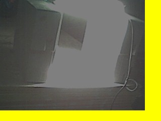

I can't make anything out of that image above with the yellow border. Can you explain it ??
How wide are the reflectors on each solux bulb?
Also, can you post pics of your screen? (im not expecting too much just yet, I just want a general idea of where you are at)
each bulb's outside diameter is 2", inside reflector diameter is just under 1 7/8" The pic with the yellow border is a pair of old ibm computers up on edge, holding up the array, that's shining down. I was trying to get a pic of the square light that the array was putting out. It was so bright though, that I couldn't adjust brightness and contrast enough to show.

Sorry for the confusing descriptions. As you have guessed, at less than 20" away, I have bright well defined "circles" of light from my array. I think they are being overly generous with the 10 degree spread. I would say it's almost parallel. They claim it will show a 4" circle @ 2', and it's definately no bigger.
Also, a 2 1/2" square light grid has a diagonal of 4" (didn't think of that....) so I sould have figured that out before I orderd the bulbs.
I'm going to try again with the edges of the bulbs touching, and setting my screen size down to 800x600 (my screen black borders and doesn't stretch on lower resolutions)
