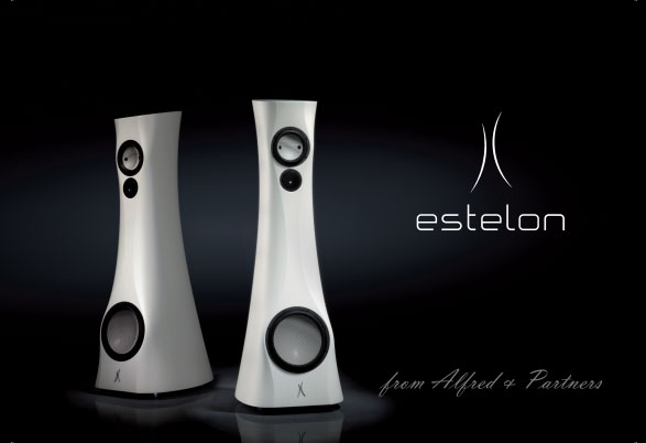

Time and time again, Seas Excel seem to come up as one of the best range of speakers and Accuton at the extreme high end. Would these seem like worthy routes to look into?
If I wanted to keep a shape similar to above, tapering, (aesthetically pleasing, reducing parralel facing sides, natural tapering, simply changed in internal volume etc) how best to get from the BMR's lowest note it can produce with ease (200Hz seems about right) to at least 40HZ.

The buyers of those aren't interested in the science.How do these guys get away with such a large spacing between mid & low range?
I wish all your guys (&girls?) would club together and write a brief 'speaker building manual' I guess I should buy a few books and read a bit more, but simple information like, driver beaming and how big and how low a frequency would allow for side firing woofers, seems hard to find...
A low XO. I bet tweeter/midbass is also < 1/4wl. That guideline gets broken all the time.
dave
I have yet to be impressed by any speaker with Accuton in them
dave
They're a focused array, so has a fairly specific 'sweet spot'. This is all I could find in a quick search, but notice the two chair listening position............
