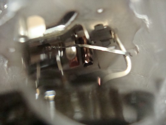

Pic of KT90 interconnect from screen to cathode. The quality of this skinny interconnect of many power tubes is typical. With such a splashed welded connection the idea that stranded or solid wires or even silver for external hook up can improve the performance is a myth. OMO.
richy
