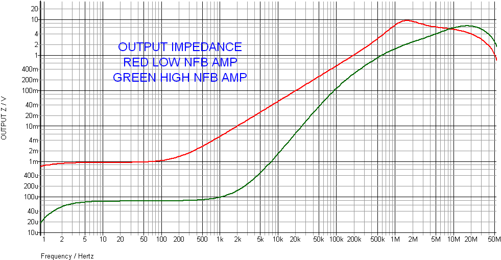

Wahab,
what is happening at ~1.5MHz?
Is it worth trying to reduce that peak.
Could we hear that peak?
The output impedance climb to almost 10R at this frequency.
Of course this peak in output impedance has no audibility
since it s at very high frequency.
What matters is the output Z in the audio band.
Increasing the open loop gain will yield lower closed loop gain output Z,
but i suppose that everybody know that.

It is probably where the loop gain curves around the (1,0) point in the complex plane. If it gets too close you can get 'resonance-like' behaviour.AndrewT said:But, what is causing that peak?
Could it be a resonance that is heavily damped?
Spot on DF96...
Past this frequency the amp has no loop gain and will be seen
by the generator as a complex capacitive load hence the decreasing
apparent impedance above 1.5mhz.

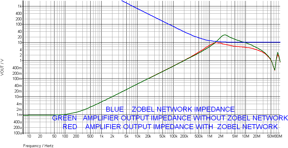

Of course the zobel network will reduce the apparent impedance
value since it is in parralele with the amp output , as well as move
the said peak frequency.

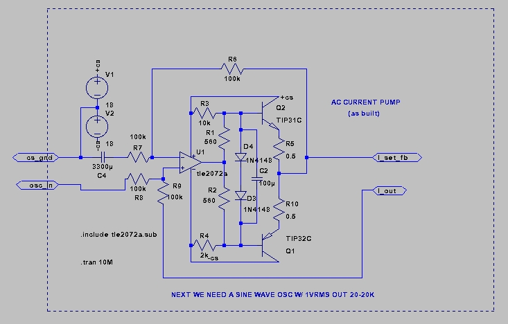

i had forgotten this thread.... i've done a few bench tests with some receivers using the simplistic method (amp driven to 10Vout, through a 10 ohm 20W resistor into the output of an undriven amp). the method works quite well, and as i suspected DOES show when an amp is underbiased. i haven't had the time to graph versus frequency, and have been using a 1khz signal for most of my tests so far. with the amps tested so far, these have all been mostly Pioneer and Denon mid-grade receivers, and are pretty consistent at between 50 and 200 milliohms with very similar amplifier circuits. when i have the opportunity i will get some data in the frequency domain as well.

if anybody has the time, and a 10 ohm 10 watt resistor, i'd be interested in seeing the results of experiments on anything anybody reading this has time to try. it's real simple..... using a signal generator and an oscope, apply signal to channel "A" of an amplifier and set the volume for 10Vp-p out. with no signal in channel "B", connect the 10 ohm resistor between channel "A" and "B"'s speaker hots, and use the scope to read the resulting waveform at channel "B"'s speaker terminal. this may seem like a crude way to do it, but you ARE feeding 1Ap-p into channel "B"'s output, and the resulting voltage has a 1:1 relationship with the impedance.
