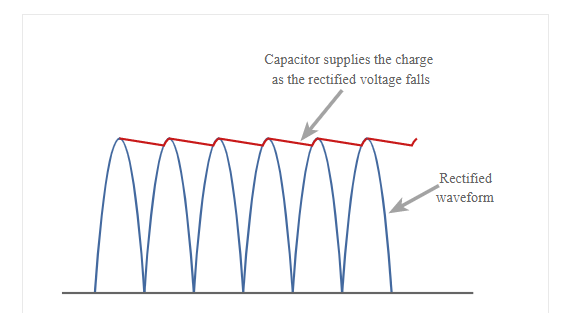

IIRC, I read that a long time ago in a technical book, not hearsay on a forum, I forget where or would quote the source. And that it's the main res caps that pull the current from the mains supply.
If they're pulling a current for a short time through several different impedances, then what's the result? Is it that smaller voltage waves are created on a carrier wave?
From the rectification process that's obvious. The voltage on the caps is steadily drawn down by the amp, and will be topped up as soon as the transformer secondary voltage becomes larger than the cap voltage because that is when the diodes start to conduct.
In a dual phase rectifier that happens twice per period, which in 50Hz is every 10ms and at 60Hz every 8.33ms.
So what you will see on the caps is a sawtooth-like voltage, slowly going down between charging pulses as the amp draws current, and relatively quickly topped up during the period that the rectifiers conduct.
So there's no mystery here.
