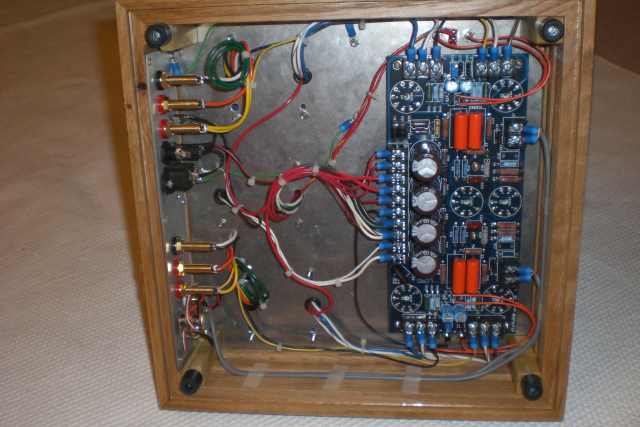

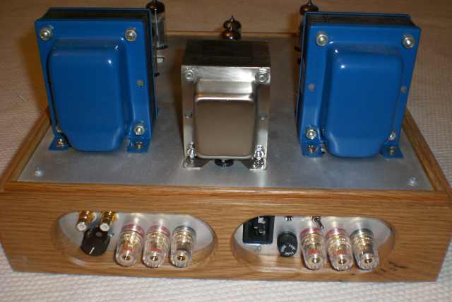

The problem is that in my amp i have my bias in 35ma for each EL-84 set ok, but I change the hole set of output tubes because the tubes tust burn a month ago, then i decide to chenge the hole set and investigate what was happening. Then after a while i realize that the g2 to cathode i found 370.8V and anode to cathode 367.3V
This is the second set of tubes that i have working without regulation. So this is the reason I'm planning to get the regulator.
Here i go with some pictures... Thanks for the irfanview software Wavebourn...
Luiz

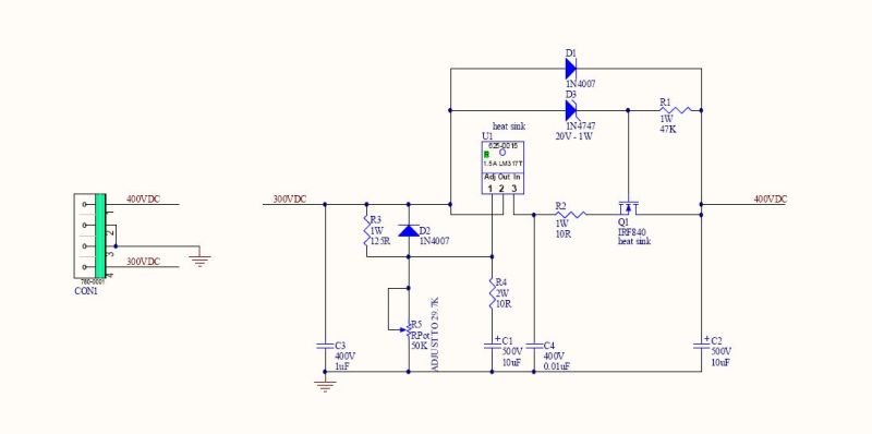

Here i have my SCH of the Voltage regulator.
Suggests are welcome.
I'm planning to run the PCB on weekend.
Anyone are interested in the board ?
I'm planning to built around 30 pcs.

Looks like you're wasting a lot of current in the divider chain, and that equals quite a lot of heat. Make sure your pot is up to the task.
I'm using 1k/220K, for two reasons:
1- MJ does it, and If It Ain't Broke, Don't Fix It
2- I had the proper resistors handy.
You should do well to note that ideally, the bias chain draws 5mA, 5mA being the minimum load current for the LM317 to regulate properly. A particularly astute observer will notice that 221k across 300V equals ~1.358 mA.
MJ solves this by preheating the tubes. I solve it by including a separate 80k divider for heater bias. I expect that there's another place you could use this current, besides setting your output voltage.
Do note that as of last night this regulator is still under construction, and may yet go "pop!" or fail to be satisfactory really at all.

You are telling me to change the R3 to 1K and use the 220k for pot R5?
Is it right ?
I liked your sch Antonio, but i'm really thinking in going ahead with LM317 because i already have at home and also the IRF840.
So i'm planning to have this little board, then i can use in another amp that i'm planning to build with KT88.

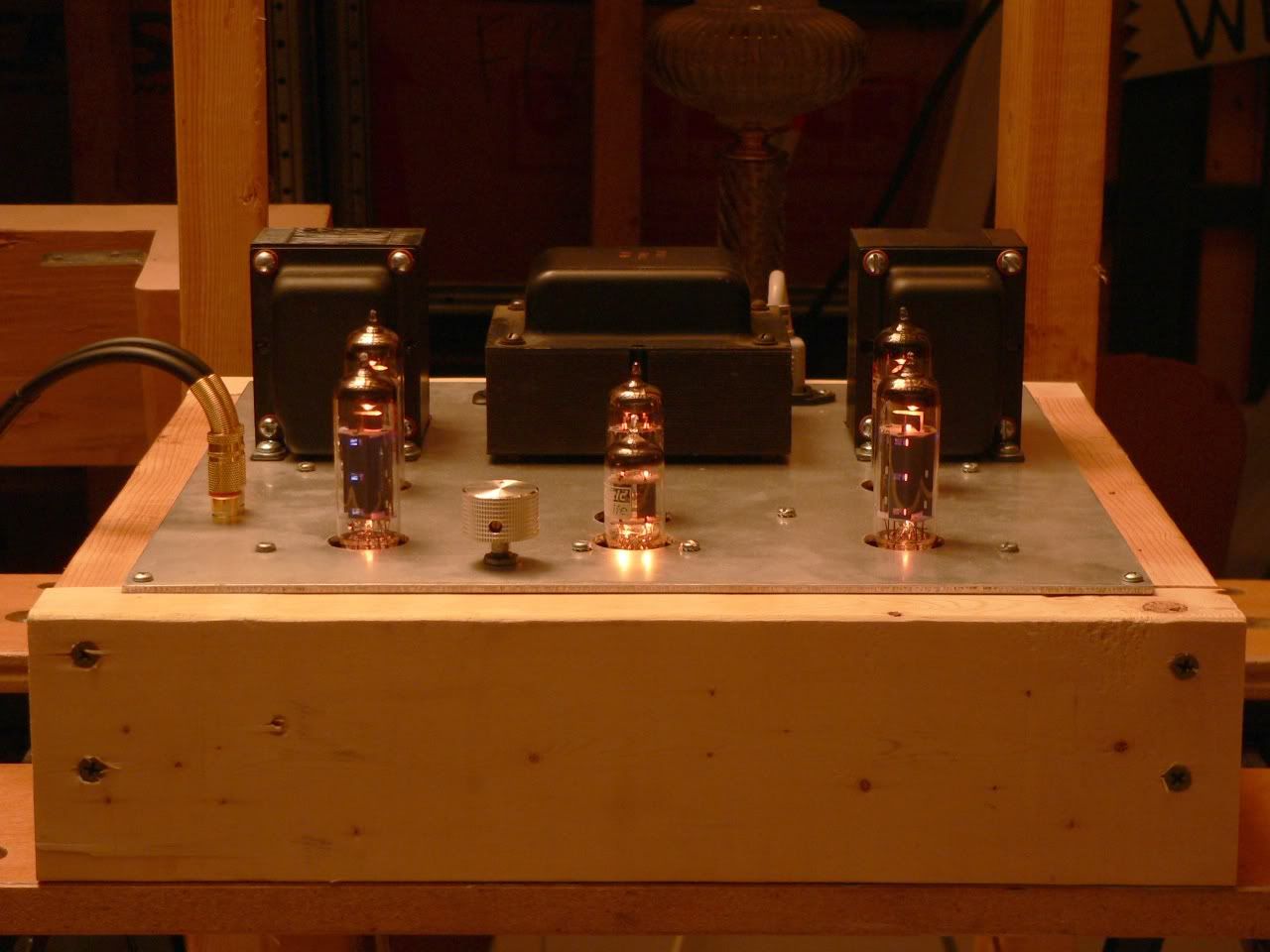

Nice looking DIY ST-35 you have there. Is that a Rev C, or a Rev D? Did you assemble it yourself? I especially like your chassis. It's quite a bit more professional looking than the construction grade pine 2x4 that I used.
I will say I haven't had any problems with the voltage on mine, and it runs over 400 volts most days. I've had the same set of Reflektor 6p14p in it since last July, and they appear to be holding up well.

Ual seems that you have the same revision that i have witch i think it's D, the last one.
I did everything by myself. I bought the chassis on e-bay, but it tooks me more than 1 month just researching for a really good one.

Nope. Mine is a Rev B. Look closely at the top, there's eight screws mounting the circuit board, not six. The Rev B is a bit larger, and the underside is different too.
Your chassis looks a lot like Uncle Ned's TubeZone chassis, but your iron is all different. I thought he usually sold a toroid PT and a set of Z-565 clones with that chassis.

Sorry, I missed your last few questions. I've had this amp running since last July. My power transformer isn't the one spec'd in the manual, and it tends to run the plates of the 6p14p tubes at a little bit over 400 volts. I was a bit worried at first, but I haven't had any problems with it so far...
