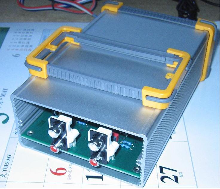

PMA,
Looks good............where did you get that chassis from? and how is the project working out?

Hello all,
The board is made by Hammond, 145x series.
Otherwise, PMA is in vacation but don't be afraid, he's like Emile Zatopec able to working for a while.

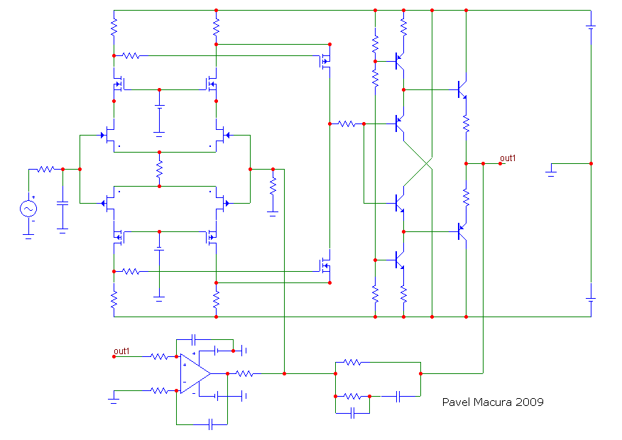

Hi Pavel.
What gain does the first cascade have? ... You have MOSFET in second stage. It is more noise.

- Without the value of parts - a discussion does not make sense, results can be different. It is simpler to use OPAMs.So how about this? (Just an idea, some parts omitted).
Best regards,
Alex
That looks like your line amplifier. Is it not too noisy for
phono work?
Can you get the needed gain, ~84 dB at DC, with that topology?
phono work?

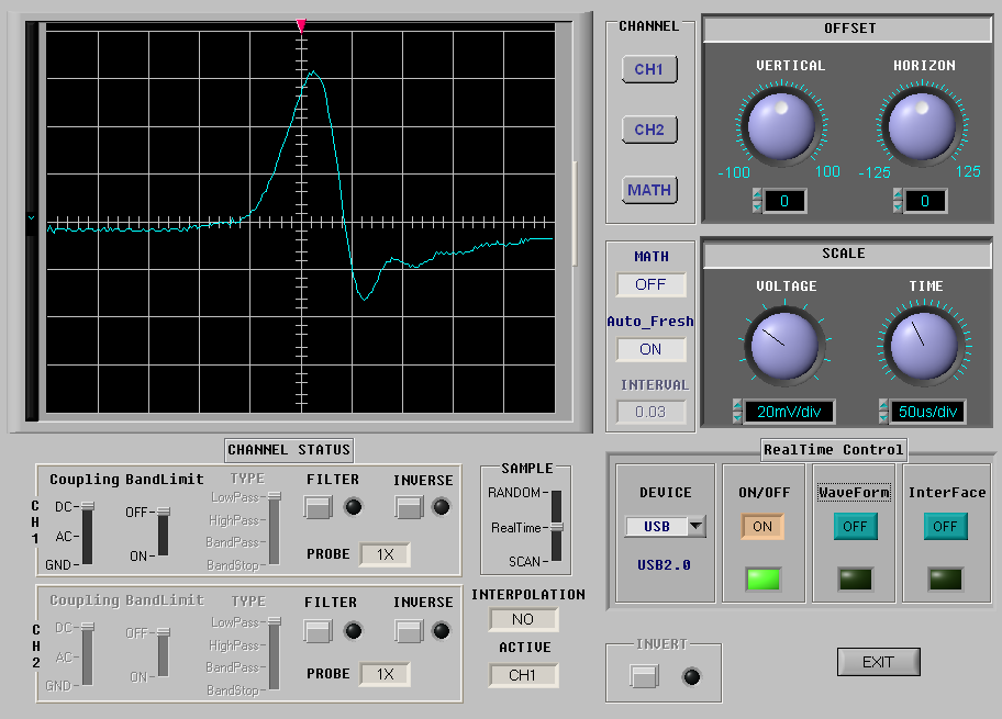

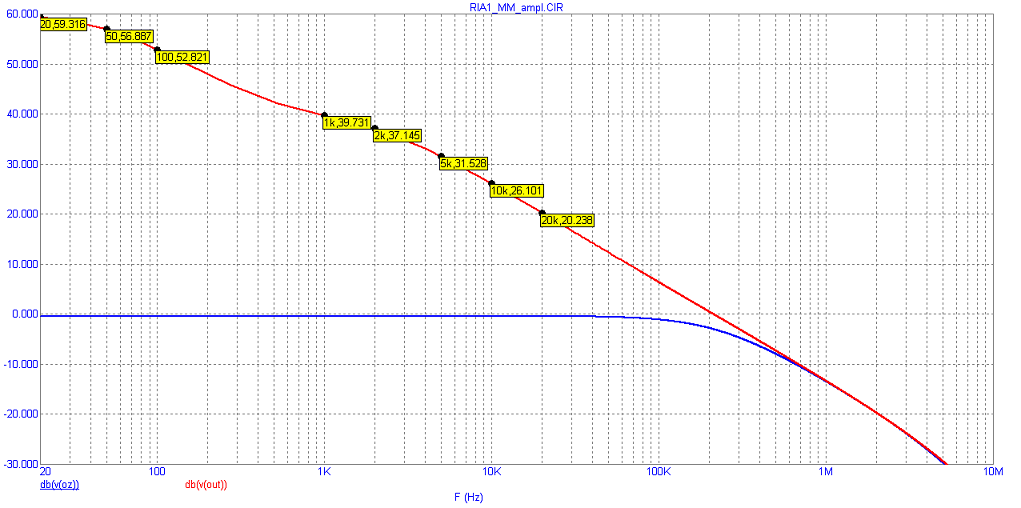

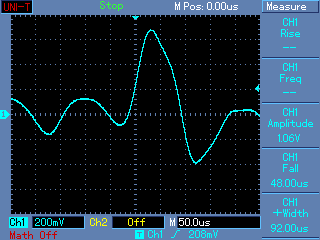

Interesting graphs Pavel.
Its for this reason that I now favour fully active RIAA. I have done some sims, and with active/passive EQ, the best I can get off +-15V rails is about 200mV overload at 20KHz - and it will be worse ay higher frequencies. In the other hand, active EQ gives me 700mV at 20KHz.
I also took a look at the load on the op-amp output. Its doable at 20KHz, but if you take alook at 50KHz (considereing the clicks and pops just like you show above), the EQ network demands >30mA. Ugly. For this reason, active EQ network in an active RIAA needs to be driven by a GOOD BUFFER enclosed within the EQ amp feedback loop.
The loss of headroom on active/passive EQ is 18dB. I checked it on the sim. The problem with this is that it easily drives the EQ amp into saturation at HF, but you then need time to recover, and this will affect the sound.
