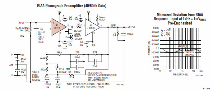

Their suggested phono preamp
Their suggested phono preamp looks pretty good-especially the FET current source that's pulling its output stage into class A operation.
http://www.linear.com/pc/downloadDocument.do?navId=H0,C1,C1154,C1009,C1026,P1293,D1612

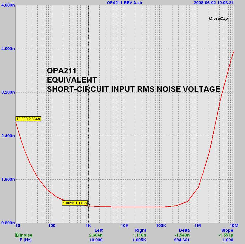

OPA211 SPICE Model
Yes, Andrew, the model is 1000 times worse relative to the datasheet.
PMA - the OPA211 is a superb OPamp noisewise, IMO.
Attached is the noise plot for the OPA211 SPICE Model.
The model is very accurate. Sligtly too much at 10Hz: 2.7nV/sqrt(Hz) instead of 2nV/ sqrt(Hz) in the datasheet.
Siurd

AndrewT said:post 294 refers to 1uV and the other you referred was 1nV/sqrt(Hz)
But the nV/rtHz have to be multiplied by the bandwidth to get uV of noise.
20kHz takes 2uV/sqrtHz up to 0.3uV
If the bandwidth were 100kHz then 1uV drops to 3nV/sqrtHz.
Now I see what you are trying to say.
ALL my presented graphs of OPamp noise are
the eqvivalent short-circuit input rms noise voltage spectral density. It is NOT the total rms noise over a bandwidth.
Microcap should present what the unit is when doing noise simulations but MC does not. I have mentioned this to them, and expect them to add this.
Sigurd
Sigurd

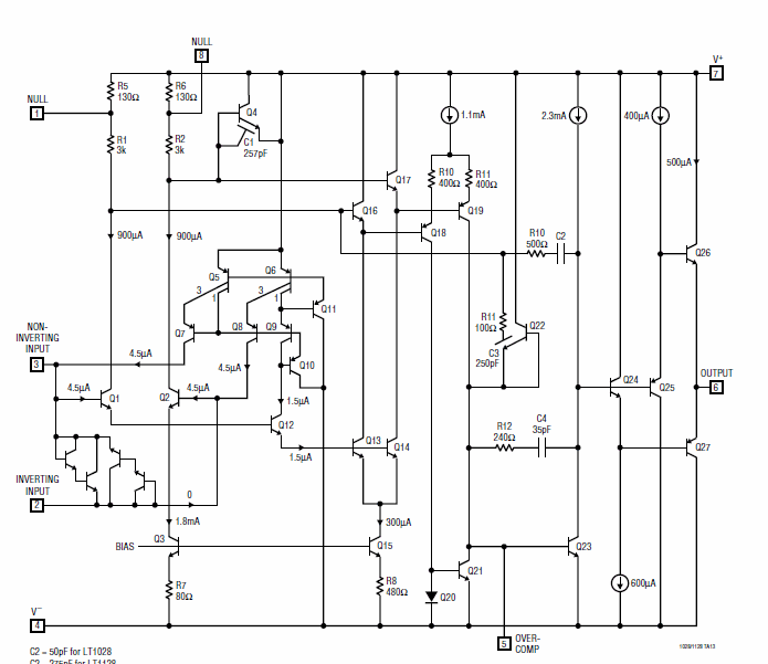

Exactly, they look very much alike except for the DC performance.scott wurcer said:
AFAIK LT1115 and LT1028 are the same part. I think Walt Jung talked them into relaxing DC specs and making a lower cost audio part.
Just my 12 cents, when I tested them for stability, I had a feeling that LT1115 was a little bit more difficult to compensate at very low gains.
jam said:PMA,
How about you thoughts on a low noise power supply for a phono stage.
Jam
Should be a nice PSU, cascaded. I have not had time yet to solve this issue.
PMA said:Just my 12 cents, when I tested them for stability, I had a feeling that LT1115 was a little bit more difficult to compensate at very low gains.
Jam's schematic got a little clipped, remember there's a mask option 1028/1128 so I'm not sure where they picked the comp cap to be for the 1115. In any case it's probably pulled back to the point where you're going to get some lot to lot phase margin issues at low CLG.
(what a compensation nightmare I forgot!)

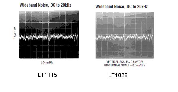

Here is a bit of evidence on that: noise traces for LT1115 and 1028 in their datasheets are identical (it is the SAME trace! 🙂 ) .
Cheers
Alex
