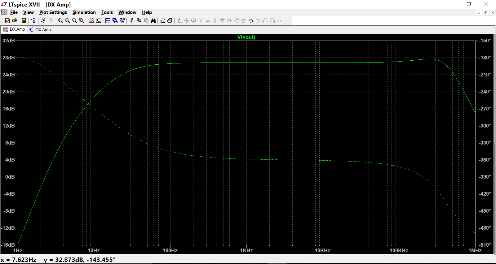

but the circuit is made to sound with high efficency speakers...that is only one way for that amp, it is low biased, and bass limited....I would to find where is bass limitation and remove it.
you also can read from author's page that frequency response is flat from 40hz-25khz on 8ohm....why???? how can I improve bass response?
True bass limitation comes from the various time constants within the design, the input coupling cap, the feedback return cap and the speaker coupling cap.

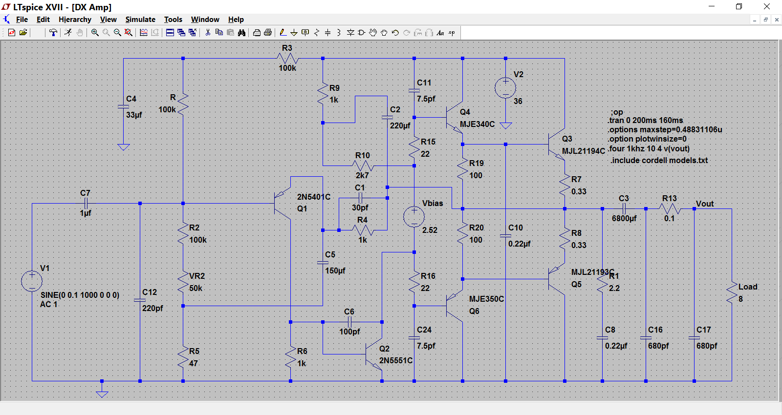

So i need to recalculate the two feedback caps. One is 150uf and the other is 220uf. Any help?

Changing C2 will change the bass roll-off frequency via the feedback network but frequency response should not be determined there. C1/R2 is the place to set the lower frequency limit but that should be ok as is. I don't know where this 40Hz lower roll-off frequency comes from. There are a lot of anomalies here and I don't think this is a good design to tinker with, as others are saying too.

Which circuit are we working to ? The one a few posts back has 330uf as the feedback return.
It's the usual problem of assuming we can all read minds.Which circuit are we working to ? The one a few posts back has 330uf as the feedback return.
Just reference the sch by post number, or attach a copy of the sch. Saves so much guessing.
I am struggling to read the capacitor numbers, so I just counted the electrolytics.
I see 5 electros. All of these will in some way influence the way the amplifier performs.
Include the input AC coupling cap and you find you will need to assess all 6 capacitors to find which are the worst bottlenecks to bass performance.

The schematic is at post #31.

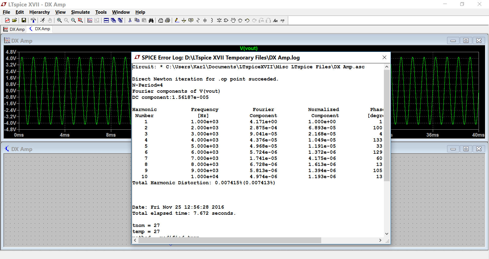

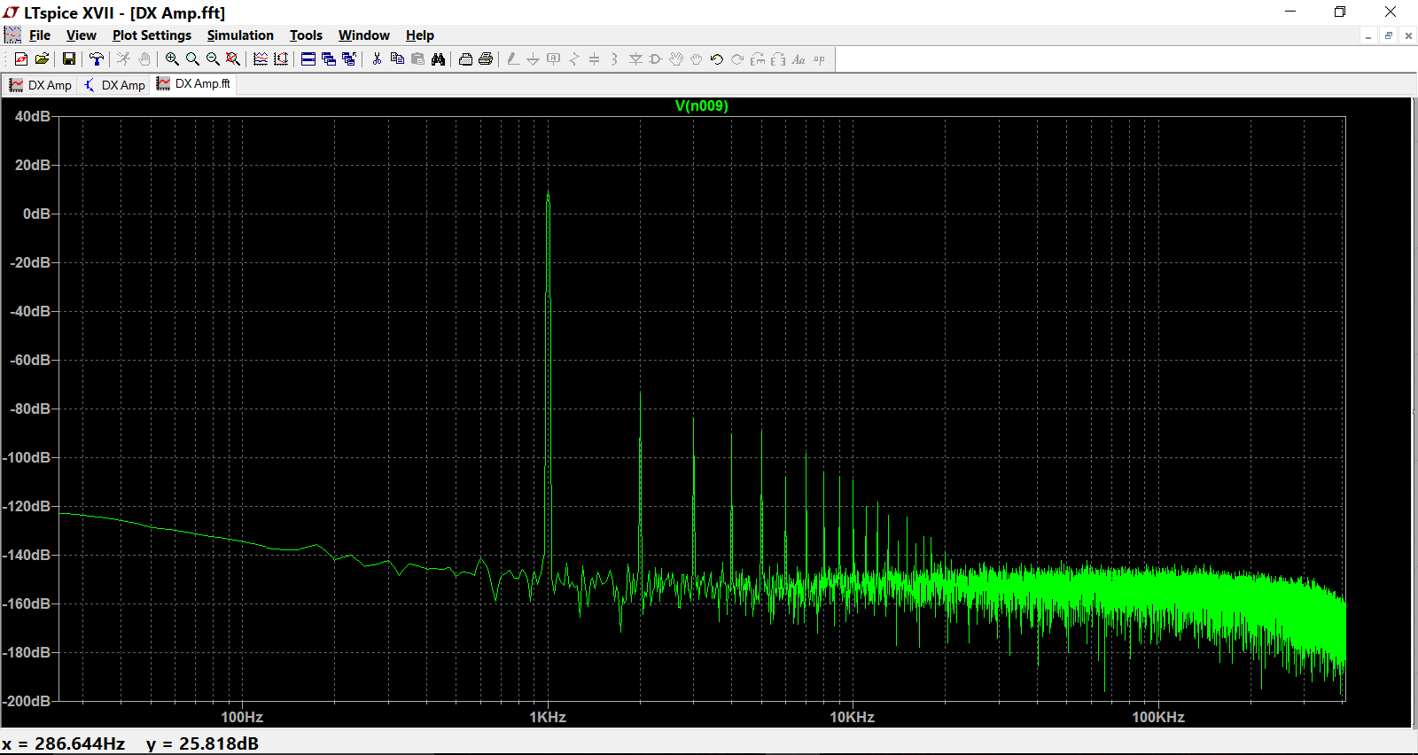

Come back in 15 minutes and I'll simulate it for you.
