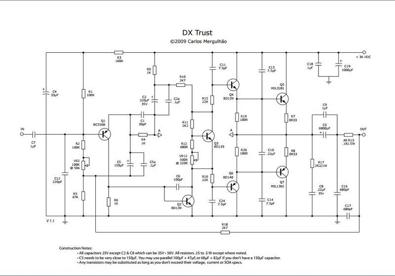

Okay, the DX trust is a single supply full complimentary amp, with a speaker capacitor.yes, it's exactly what I'm looking for.
I think that if someone looks at dx trust schematics, can surely improve it.
I would start from R13.....
R13 is a cheap, available off the shelf RF interference inhibitor to keep radio emisions from sending your amp into oscillation. 5 W wirewound resistors typically have some inductance due to the windings. If you want something more conventional, get some 16 or 14 ga magnet wire. Wind 14 turns around a AA battery, remove the battery. Parallel it with a 10 ohm 3 watt resistor. Voila, zobel network like most real amps have. My PV-1.3k has exactly that for a zobel network.
The speaker capacitor design is something I highly recommend for newbies for their first amp. When a solder joint lets loose, instead of rail voltage toasting your speaker, The amp sits there putting DC on the capacitor, which can stand it. A direct comparison of my improved ST120 (bias correction) speaker cap amp versus a no caps in music flow CS800s, at 1.5 Vpp, I can't hear the difference.
I think you are looking for an amp not particularly with less power, but you need less gain so the amp is not so loud. Gain has to do with ratios of resistors around the voltage gain stages. I just built a very similar Apex AX6, point to point hand wired, no printed wire board. It is quasi comp. I used 2n5401 input, D44R2 VAS, TIP41/42C for drivers, NTE60 (MJ802 white box) for outputs. I needed higher voltage transistors than this dx trust because my transformer puts out 80 vdc @ 6.5 A. I listen to classical source, so even with a 1.5 Vpp base level output, I can get a 20-40 v peak on the cannon shot in 1812 overture. If you listen to singer songwriter guitar sources, the dynamic range is not very high and a 36 v power rail could be fine at 1.5 Vpp average lintening level.
Also on DX trust, I'd put 20-30 pf disk cap to analog ground at the input to keep RF out. I have trouble with CB radio cars driving by, and lamp dimmers. I'd also use a 4.7 uf input cap instead of 1 uf, it doesn't cost more.
C13 & 14 are a little strange, and would tend to increase the tendency of the output transistors to not shut off quickly. Look at the Apex AX6 for comparison. Similar amps are the Elliott basic 50 (npn input), the TGM8 and with more sophisticated input structure, the Panasonic SU380

dx trust has too many goofy capacitors.
C12 would tend to short out your input voltage. Delete it, or substitute 33 pf as I said (or 22 to 47 pf).
Delete C10, C13, C14, C16. He may have had an oscillation problem, but these are the wrong places for these. C11 & C24 are more conventionally 47 pf instead of 7.5 pf to prevent oscillation. These are disk caps. Part of Mergulhao's oscillation problem may have been the lack of 10 ohm resistors between the drivers Q4 & Q6 and the output transistors bases Q5 & Q7.
C3 could be 4700 uf or 3300 uf which is a lot cheaper.
Really, AX6 is a much more proven design. Worked out for 56 v supply though. My AX6 is not oscillating, I checked with a VOM 2.5 vac scale on the output with the input shorted. 0 v out.
Also look at kurozz first amp http://www.diyaudio.com/forums/solid-state/297453-tips-first-amp-design.html but follow the suggestions in the text, the first draft had some problems. This hasn't been built to my knowledge but the idle bias control is better worked out than AX6. My Ax6, if I set the idle current (through output emitter resistor like R7 dx) to 8 ma quiet it peaks at about 160 ma with some volume.
On dx trust, VR2 is adjusted to get the DC input voltage of the output capacitor C3 to the middle of the supply voltage. AX6 this control is missing, I had to change R2 several times to get the output centered. I ended up with 270k pull up 300k pull down with a high gain On semi 2n5401 input transistor.

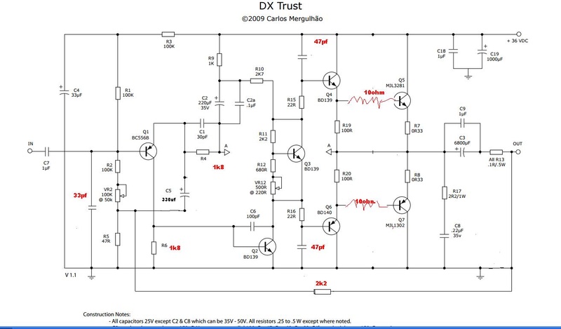

so, thanks to indianajo suggestions, this should be new improved schematic for dx trust amp.
what do you think about it? any help will be appreciated....many thanks
Much more conventional.
Change C6 to 100 pf from 100 uf.
Move the 33 pf from the base of Q1 to outside the 1 uf to ground. It should connect directly to the RCA jack input. The 1 uf input cap can be 4.7 uf.
See post 196 of this thread for the Apex AX8. It is very close to this, plus Mr. Slavkovic builds them at least once. There ought to be a pcb layout somewhere, but not on this AX6 thread. The MJE340 in the upper left corner and associated parts are a soft start I think and are not necessary. See AX6 for the simple version of this area. The output area of your schematic with the zobel and permanent RC load are more stupid proof; IMHO, my ST120 with TIP mod has those. http://www.diyaudio.com/forums/solid-state/236256-retro-amp-50w-single-supply-20.html
(ahem)....C6 is the Miller frequency compensation cap. 33-100pF is normal in most linear amplifiers, 100uF is definitely not.Much more conventional.
Change C6 to 100 pf from 100 uf....
DX's "goofy" capacitors are all about tweaking the sound quality for his audio tastebuds. i.e. enhancing the harmonic distortion to have low order dominant evens. This is no generic design for efficient, clean sound or textbook simplicity so if you don't want the tweaks, look elsewhere to even simpler solutions like JLH's class A designs or Rod Elliott's DoZ - these are great sounding, widely used and simple class A designs.
