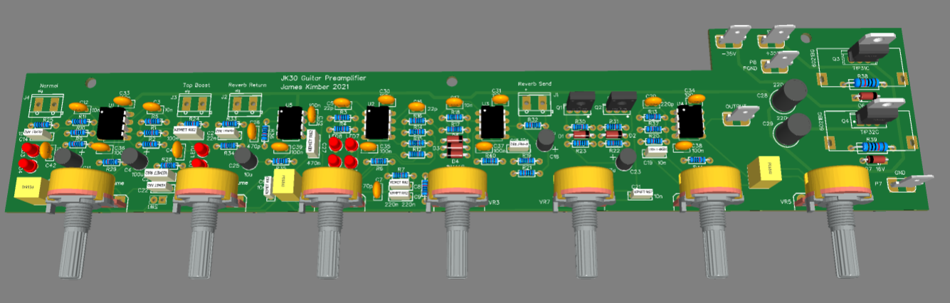

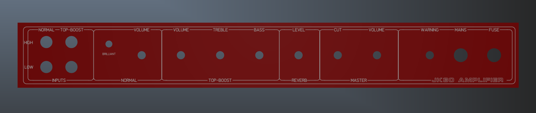

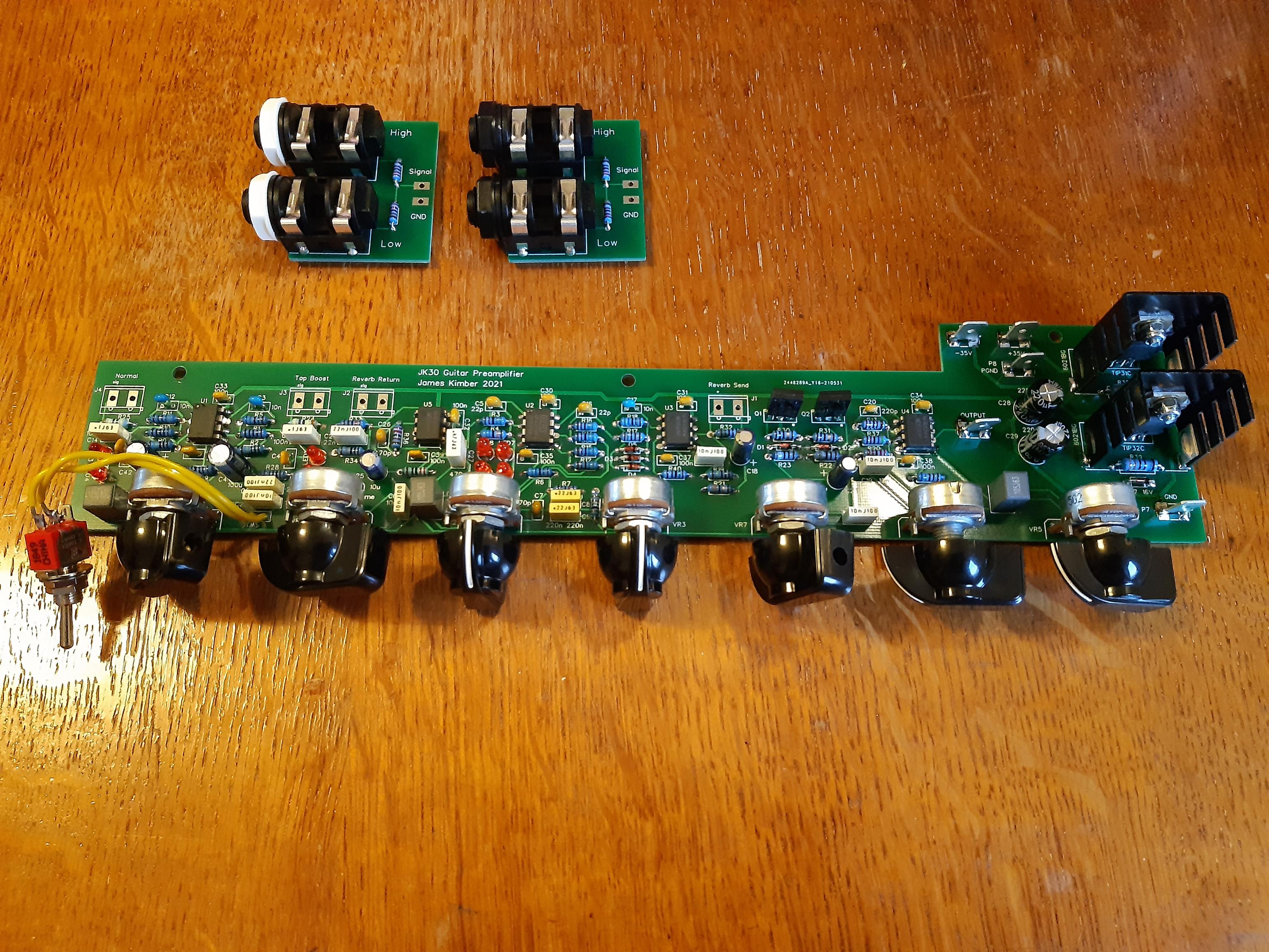

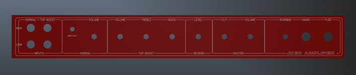

I've now finalised the preamp design (attached) and the boards are being made by JLCPCB right now. Fingers crossed everything works when it arrives! I've started working on the front panel in Front Panel Designer and I'm going to have it engraved by Modulus Amplification. It needs a few tweaks but I'm pretty happy with how it's looking so far.
Once the preamp boards have arrived and been assembled and tested, I can begin work on the chassis. I'm going to order a 'C' type custom chassis from Modulus Amplification. They say that they can do square cutouts for transformers so I'm hoping they can do one for mounting the power amp to the heatsink.

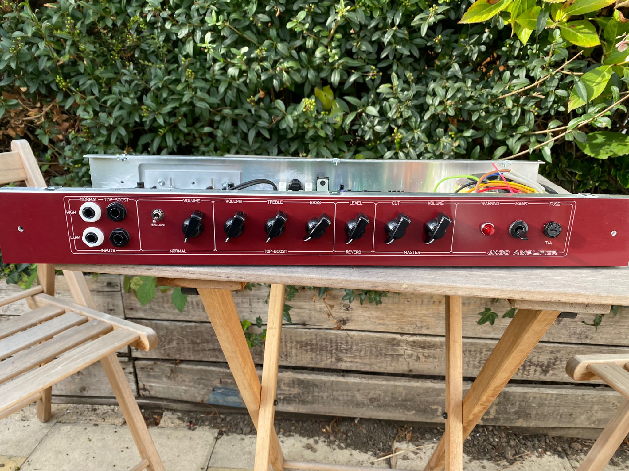

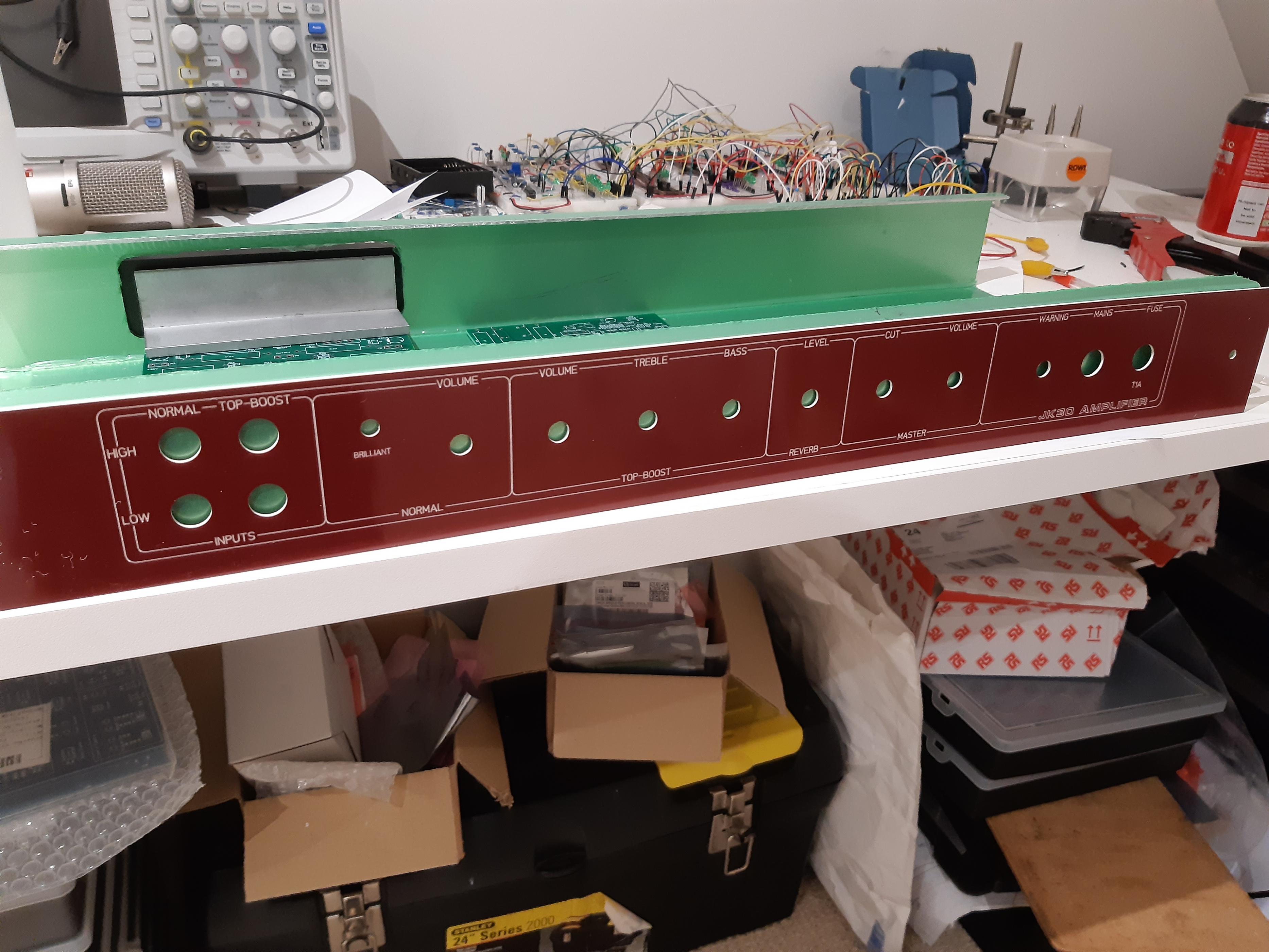

Due to various other commitments, I haven't been able to work on the amplifier for a while but I should be able to get back to working on it fairly soon. There was a bit of progress today as the chassis and front panel arrived, both from Modulus Amplification. The chassis is aluminium and has a rectangular cutout for the power transistors to mount to the heatsink. The front panel is engraved acrylic and looks very good indeed. As you can tell, I've modelled it after the AC30 front panel. I'm particularly pleased that all the holes line up correctly with the preamp board! I've attached pictures of the panel and chassis, along with the preamp board which is now assembled and tested. Hopefully I can get some more work done on it soon and I'll keep you updated!

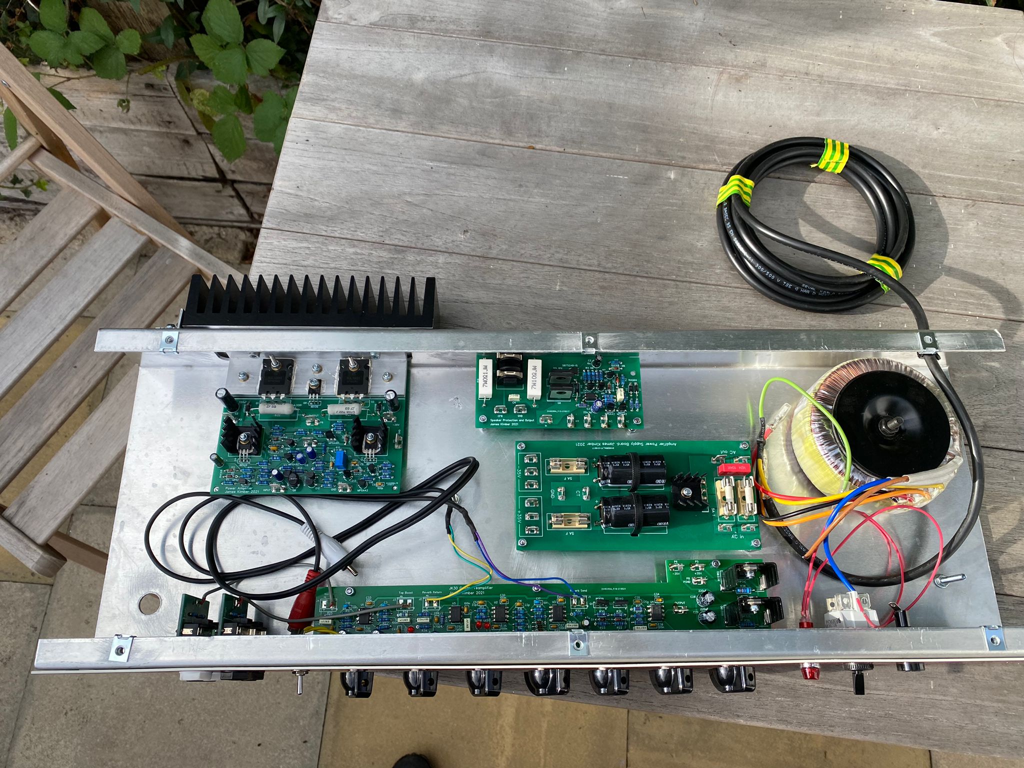

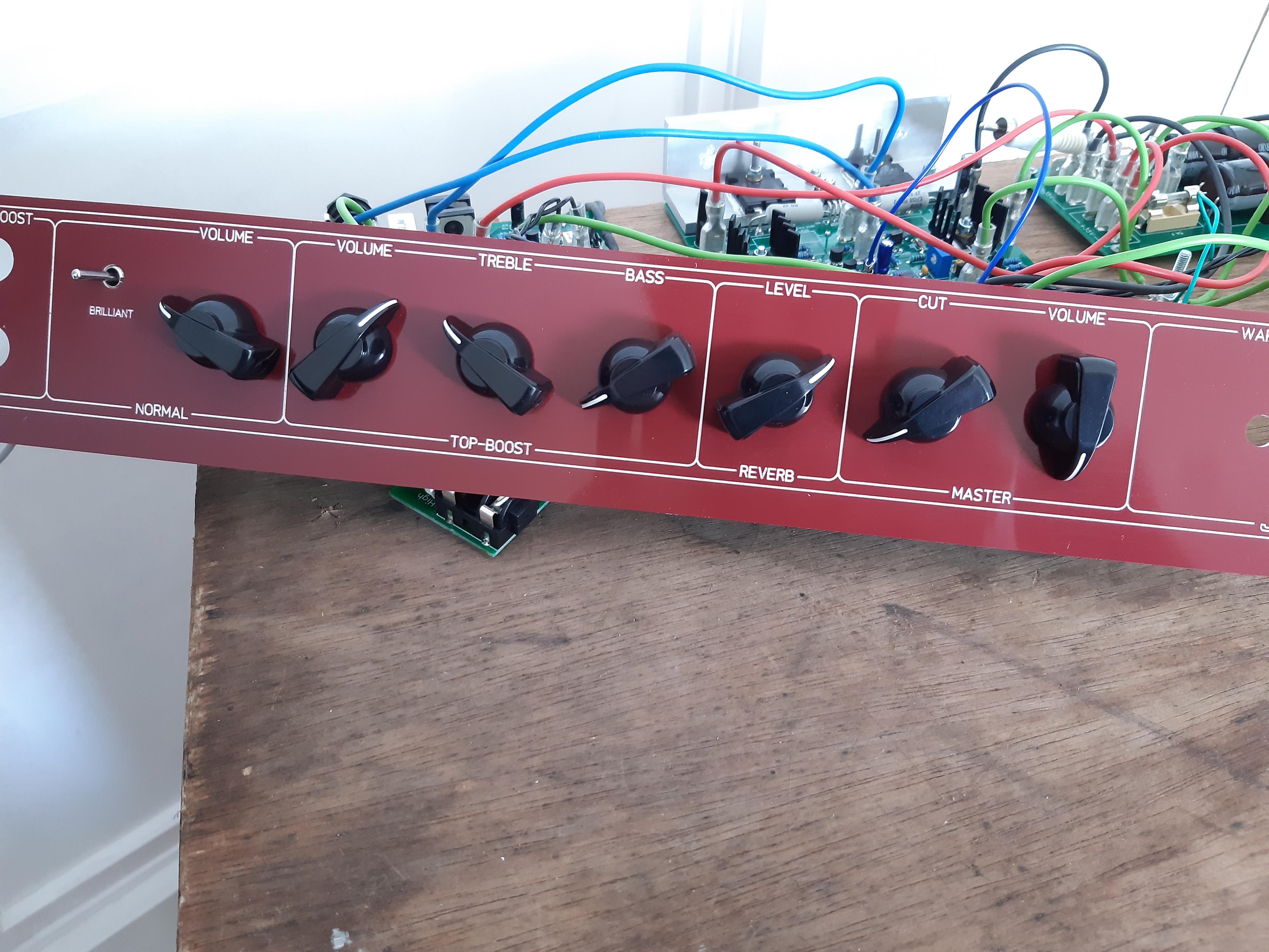

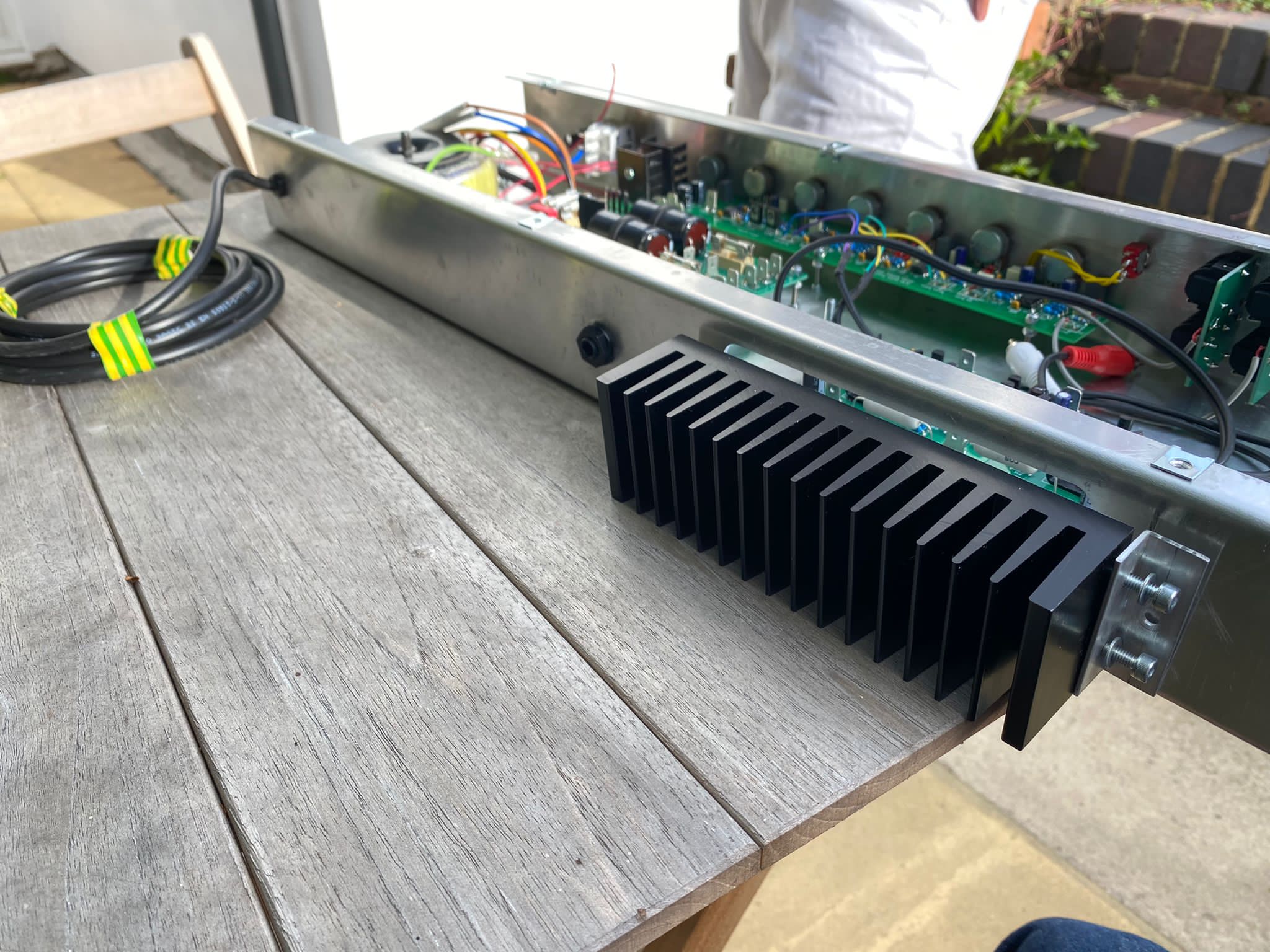

I've now almost finished assembling the chassis. The machine shop took a long time to get the heat sink done as they were very busy but I got it back a few days ago. I've drilled all the necessary holes and fitted most of the boards and other components. I'm just waiting for some screws to arrive so I can fit the power amp to the chassis and then I can wire it all up and the chassis will be complete. I aim to have it all assembled by the end of the week so, assuming it all works, I can move onto the cabinet.
The cabinet will probably take a while to complete but with the chassis nearly done, it's moving in the right direction!

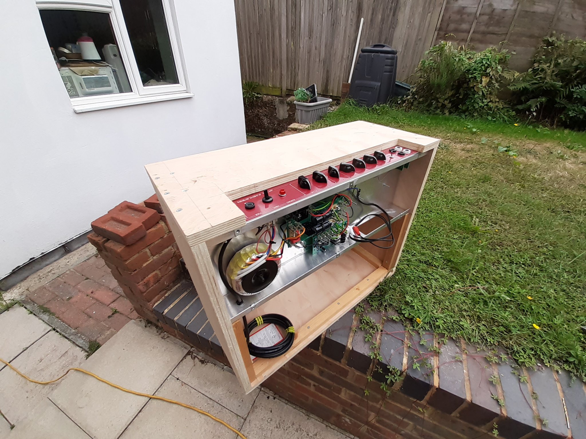

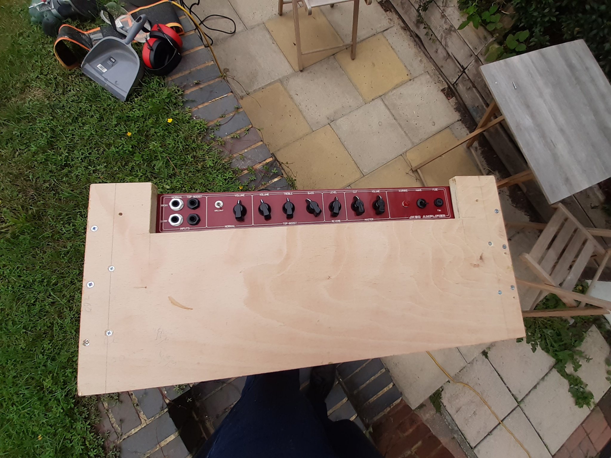

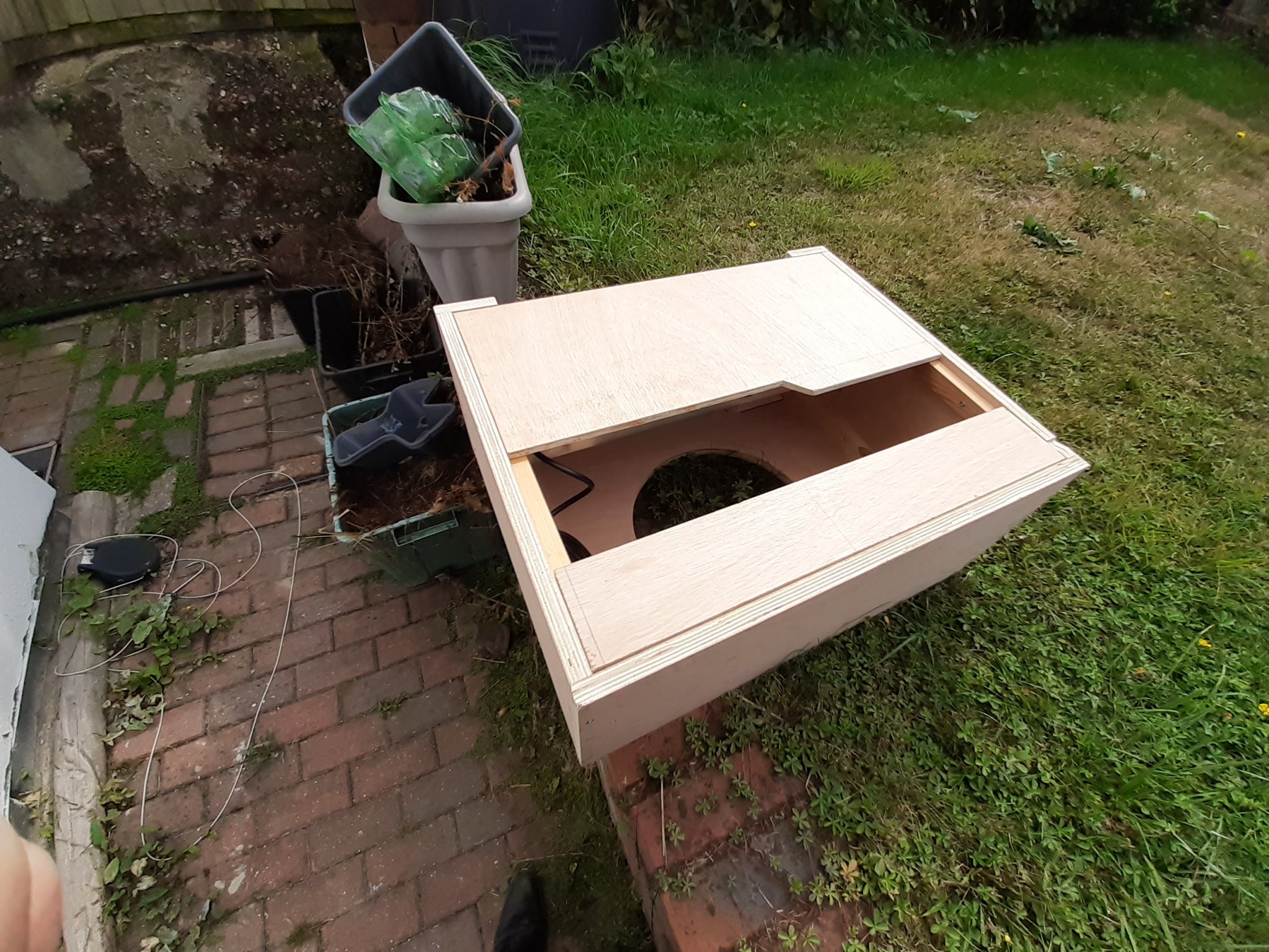

Thanks for the comments. I made some progress on the cabinet today. I just need to drill the holes in the back and then it will be finished structurally. The bit on the back that sticks out is where the heatsink is and I'm going to make a cutout and cover it with coarse mesh. I wanted the heatsink to have some protection from being knocked while still having airflow and this seemed like the best solution.
I've wired up what I can on the chassis but I'm still waiting for the screws so haven't been able to fit the power amp yet.

I'm not sure, actually. Certainly lighter than a real AC15. The alnico speaker is light and the chassis can be balanced on one hand. The cabinet isn't as light as some but is pretty standard. Overall I think it will be reasonably light amp though I can't put a figure on it.Nice cab! How heavy do you think it'll be fully assembled?

Remember to remove those screws holding sides to top (and bottom) before routing rounded edges, they will destroy the bit if touched.

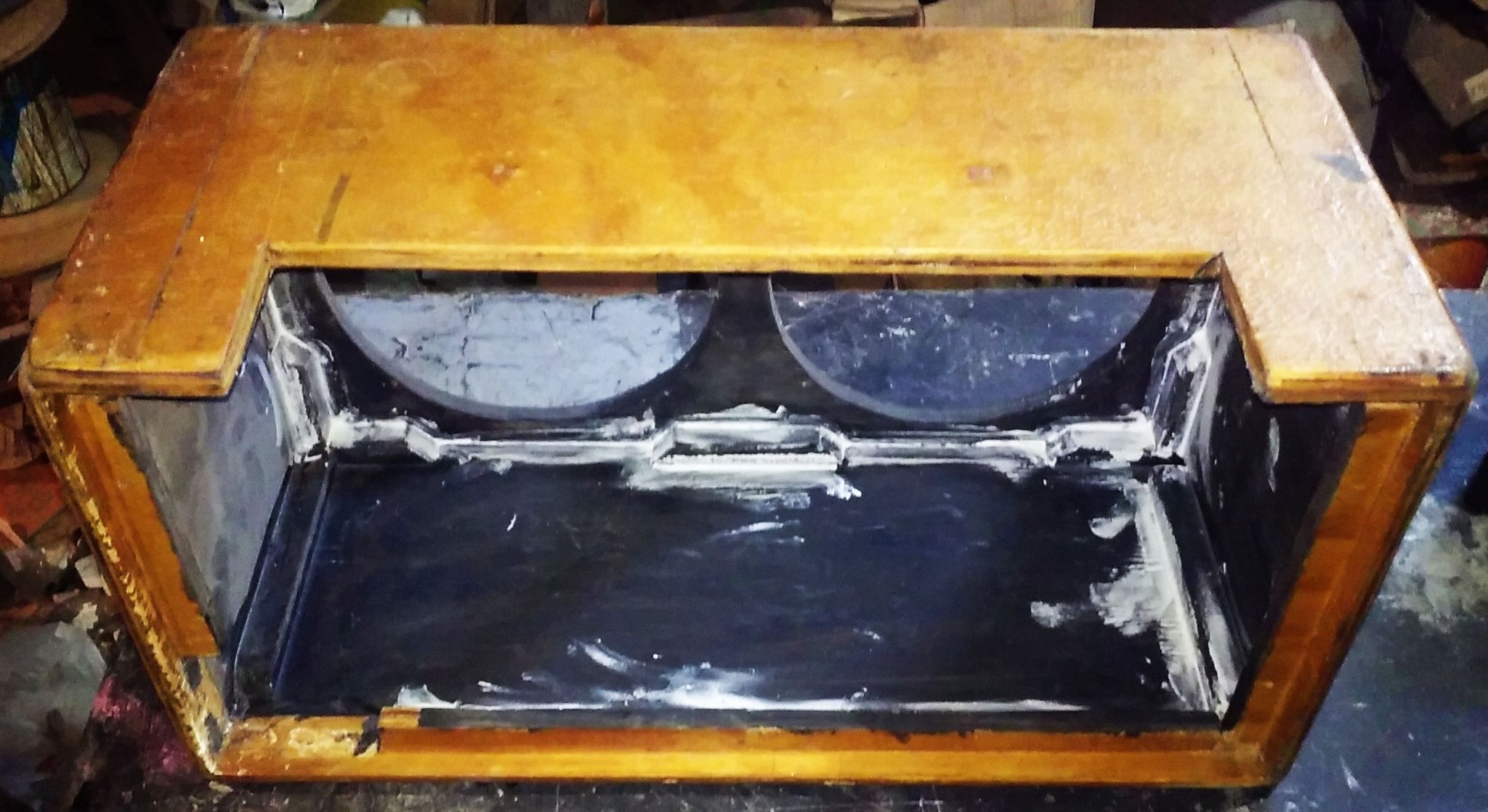

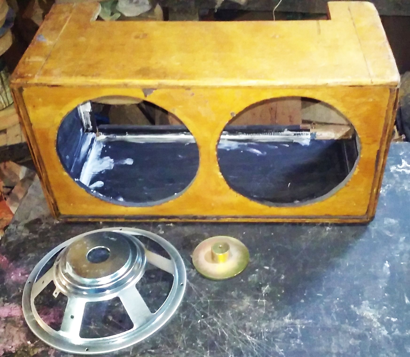

Small world, I am just now making a very similar cabinet, but smaller (2 x 10")
Ultralight, made out of 12mm plywood, empty cabinet (inclding back panel) only weighs 4.2 kg .
Actually retolexing it, Customer wants it in Brown/Beige colour "because he plays the Blues" ; found black Tolex "too Heavy Metal"
He´s paying extra, so no big deal.
also showing one of the (yet unfinished) 10" speakers I make:
