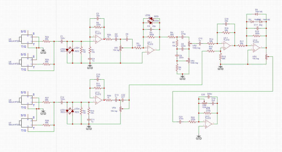

I've been working on the preamp for a while now and I've attached what I've got so far. It's got a normal channel and a top-boost channel. Asymmetric clipping occurs first, after the EQ on the top-boost, and pre-eq symmetrical clipping cuts in later. The normal channel is only affected by the asymmetric clipping. The inverting amplifier at the end with the 'cut' control will also serve to sum the reverb signal into the output.
I'm really pleased with the sound so far, it's very AC30-like. The normal channel is pretty muddy at low volume but sounds great when turned up a bit, especially on the strat bridge pickup. The 'treble bleed' capacitor on the normal volume control will be switchable on the final build.
I've got the Celestion gold coming in the next few days, along with the reverb tank, so I'll be able to adjust the sound more to fit the speaker.
Any suggestions would be greatly welcomed!

Hi James
Great stuff!
Then it really sounds like a Vox AC30! ;-)
Seriously though, you could drop the value on C11 to something like 220nF or switch between two values. BTW I think top of R10 should join R11 instead of the non-inverting op-amp input? Cheers

Yep, R10 should join R11, I've just connected the wire wrong on the schematic. I'll play around with the value of C11 but I think I'm going to leave the normal channel as-is. From what I've read, the normal channel on the real AC30 is pretty muddy. I suppose I could brighten it up but then it would lose the sounds you get when you turn it up and use the bridge pickup. So I think it's best to leave it as-is and have the top boost channel for bright channel.

Hi James
Yes I have heard the Normal channel AC30 and indeed it's a darker voice at lower volumes..which may not be what most people associate to that amp..the expectation that it sounds jangly would be more the Top Boost side, or going into the Normal channel with a treble booster. So more true to it's original form leaving it as is.

I should have mentioned that I've tried a treble booster into the normal channel, a Rangemaster clone I made with an AC125, and it worked pretty well.
I haven't had a chance to turn it up loud but it seems pretty loud. One thing I'm thinking about is the speaker's power handling. the Celestion gold can handle 50W RMS according to the spec but the amplifier on 25V rails can put out about 70W. The clipping stage limits the clean power to around 30W but when driven into distortion, it exceeds this considerably. I could attenuate the output but then I'd reduce the clean output too, which I don't want to do. I suppose I could add another hard clipping stage after the master volume to limit the power to 50W. I always hear that valve guitar amps are putting out significantly more power than their rated power when driven into distortion but I don't know how much. I also wonder if it might not be a problem as I just won't turn it up loud enough to blow the speaker.
The second problem is that, with the master on full, there's a fair bit of hiss on the output. I reduced it considerably by increasing the gain of the input stage, using LEDs to increase the clipping threshold, then reducing the gain of the post-summing clipping stage. Any ideas?

Are the input jacks shorted to ground when unplugged? I assume most of the hiss will be on the Top Boost side, maybe reducing the signal before its mixed with the Normal channel will help limit the output wattage and lower the apparent noise floor of the boost circuit so it's less noticeable.
The inputs are shorted when not connected. I think the hiss is being generated in the summing or clipping stage as it's present when both channel volumes are on zero.
Your "summing stage" is wired as a differential (difference) amplifier, as far as I can see. Not sure if that may be a factor..nothing would seem to cause it to be noisier then a summing amp.
That's right, I've got it set up as a differential amplifier so that the normal and top boost channels are in phase and can be combined. I'm not sure how much noise is a product of it being wired with jumper wires on a breadboard and how much is intrinsic to the circuit.
Ah that's what I thought you were doing, and I am not sure either if it may be at play in contributing to noise, or if it's the breadboarding. There's no gain on that stage, and the next one doesn't seem excessive either.

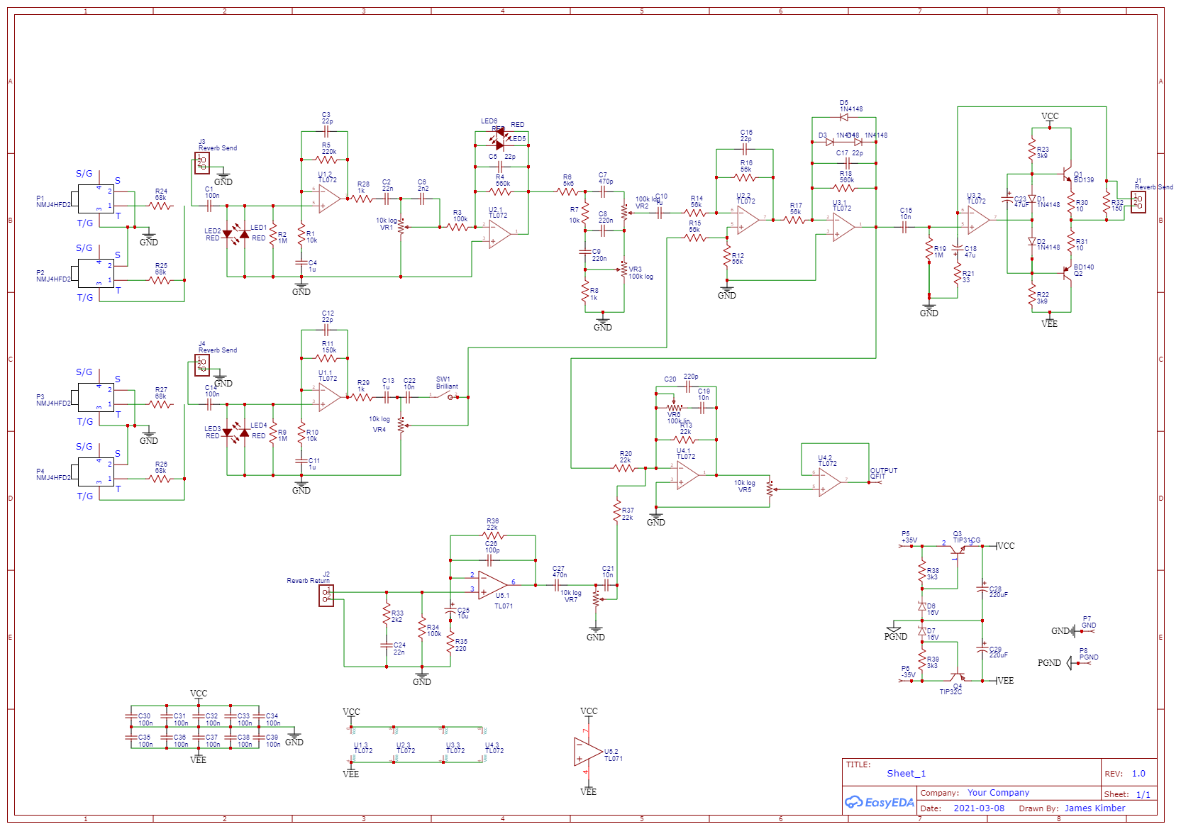

I've spent a long time fiddling with the circuit now and I'm pretty pleased with how it's sounding. I've got it all mounted on a wooden board with the PCBs, transformer and the preamp on a breadboard. I'm also using the Celestion Gold now. The updated schematic is attached. I'm still getting what I consider too much hiss on the clean sound. The master volume needs turning up a lot to get a clean sound and then there's too much hiss. I'm not sure what the best approach for solving this is. I'm also wondering if it needs a bit more bass. It's a bit thin sounding at the moment and doesn't sound as 'big' as I'd like it to.
