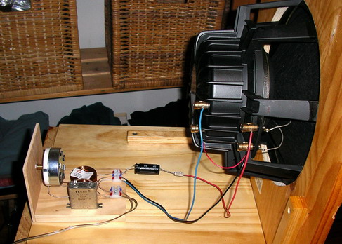

adason said:open baffle coax
You likem da Sammi's? Still using a simple cap on the tweet? Mine still in box until something else breaks. Yours look great.
I love them, as you know looking at yours, they are well built, highly efficient, nothing to complain about. Cheap man's Altecs. Yes, I still have just a cap and L pad for the tweeter. You have to brink the tweeter down to 1/3 of the signal. Otherwise they love the power, they are not affraid to be cranked up from time to time (unlike my Lowthers). Sammi's are a good value, no regrets. You should put yours to good use!

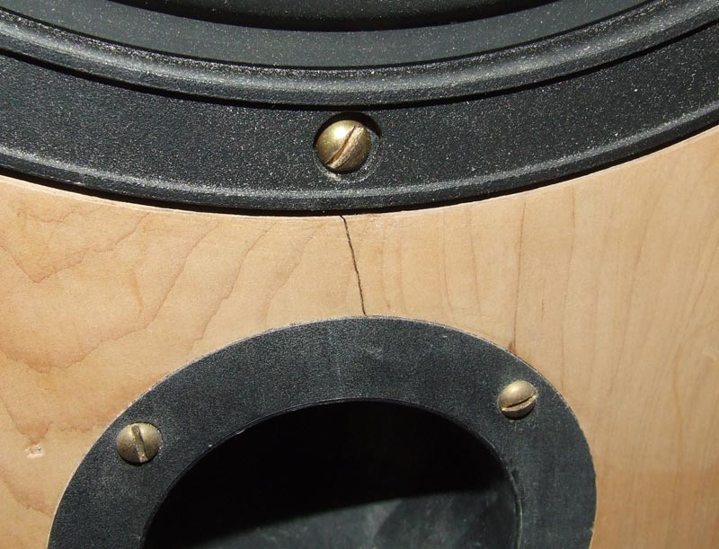

leadbelly said:...My experience is different, and therefore I question if people are speaking from experience and have had these cross grain failures ...
Yes, and here's a pic to prove it.
I also have had failures of this type, (no pics, sorry),
but not since I actually started considering methods to avoid it, it just requires a bit of thought and understanding of the differential shinkages an movements of timbers along and across the grain.
If you choose to build it purely out of flat pieces of hardwood, joined together tightly at all joints, you really are taking the risk !!
pinkmouse said:Yes, and here's a pic to prove it.
You sure? It seems to line up pretty well with that driver screw hole.
leadbelly said:
My experience is different, and therefore I question if people are speaking from experience and have had these cross grain failures or just regurgitate what they were taught. I understand the technical reasons for your concern, but frankly, all I seem to hear in this thread is reasons to build cabinets designed for 50 year lifespans for speakers that are lucky if they are used 5 years by the owner.
It is one of the most basic rules of carpentry and joinery we are talking about here. The expansion and contraction of solid wood across the grain cannot be halted. Even when it is at EMC (equilibrium moisture content) and properly finished on all sides, there is still potential for movement.
When you use very dry wood, and keep the panel small, it will most likely never show signs of failure. This would be the case for the small boxes in your picture posted above.
But in a bigger box, possibly using wood that is not as dry as it should be, the chance of failure is much greater.
Solid wood at retail prices is quite expensive, and when it's your intention to build a "furniture grade" speaker cabinet, your preference would be for it to look good for more than 5 years.
I suggested a compromise earlier - use the solid wood for the sides, top and bottom, and veneered plywood for the back and front. Once it's done, the only one who will know the difference will be the builder.
The best of both worlds.

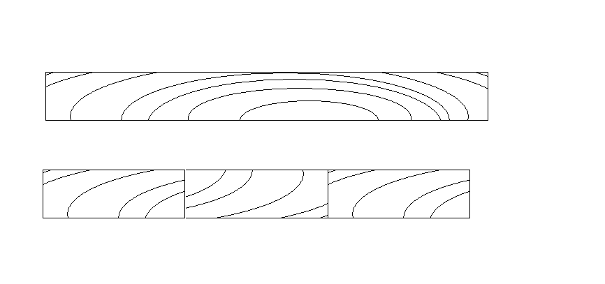

Have heard from several others outside of diyaudio, that you can minimize problems by gluing small pieces of less than 4-5 inches together. Dunno if its true. Seems similar to what plywood or chipboard is when you think about it.

Daveis said:Have heard from several others outside of diyaudio, that you can minimize problems by gluing small pieces of less than 4-5 inches together. Dunno if its true. Seems similar to what plywood or chipboard is when you think about it.
Laminating strips of lumber adds stability - the resulting "board" will stay flat, and resist warping. This does nothing for cross-grain expansion/contraction.
that is exactly how these were made. many lengths of 3cm square timber glued side by side.
