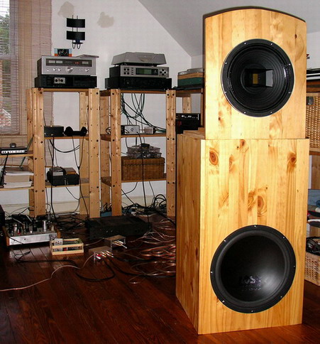

Go for it. The ones are the right are solid oak:
