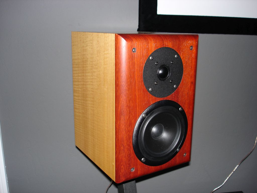

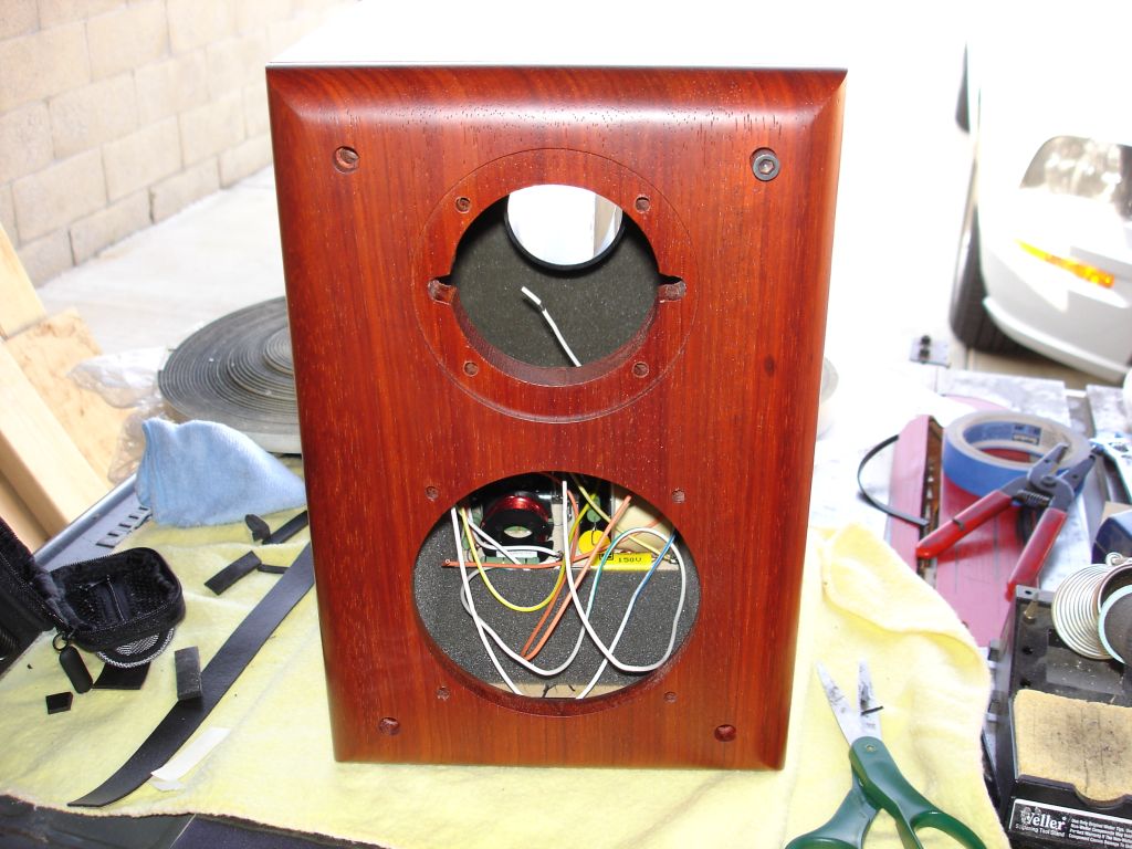

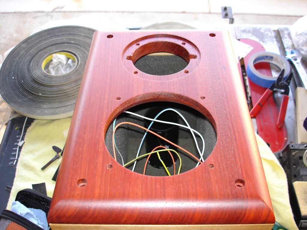

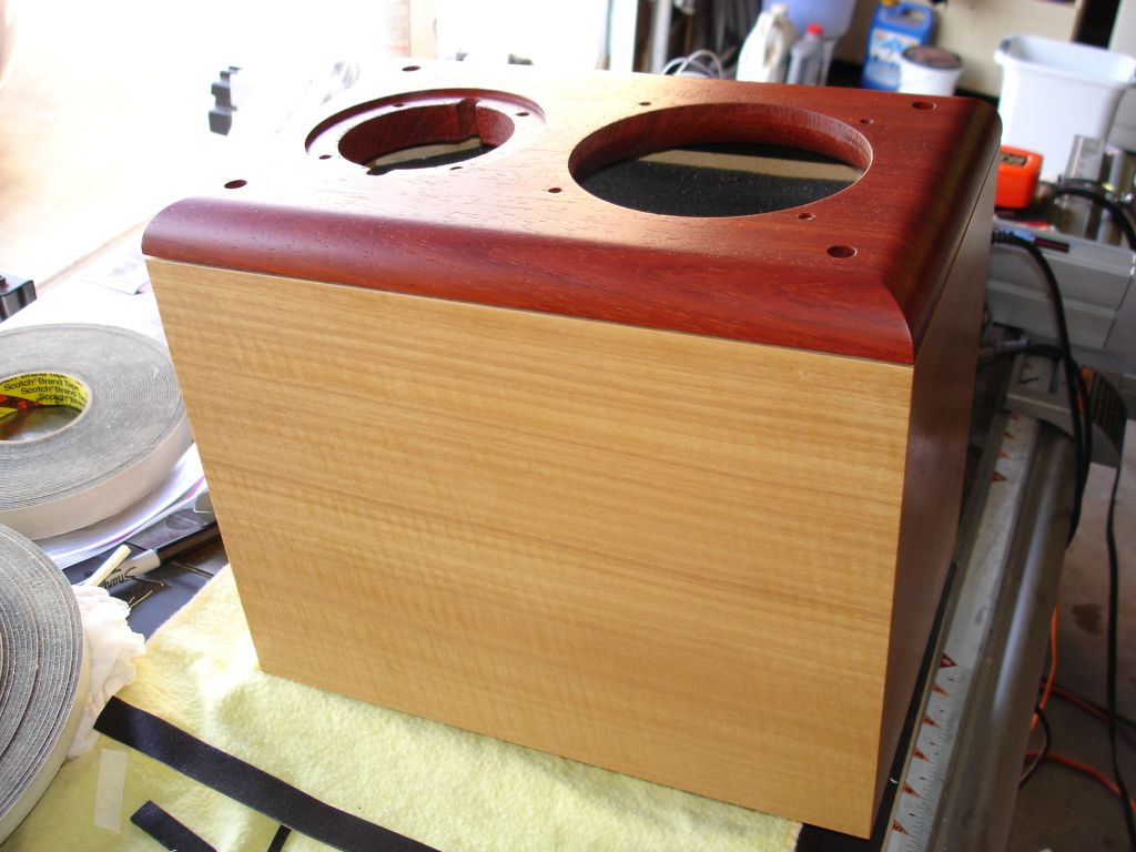

Back in the early 90s I built a pair of quarter wavelength TL bookshelf speakers. Used 8” x 14.5” x 1.25” solid walnut (flat sawn) for the baffle in an otherwise all-plywood cabinet. The baffle is recessed 1/4” into the plywood. No screws were used except for the drivers and crossover mounting. I still have them and they are rock solid.

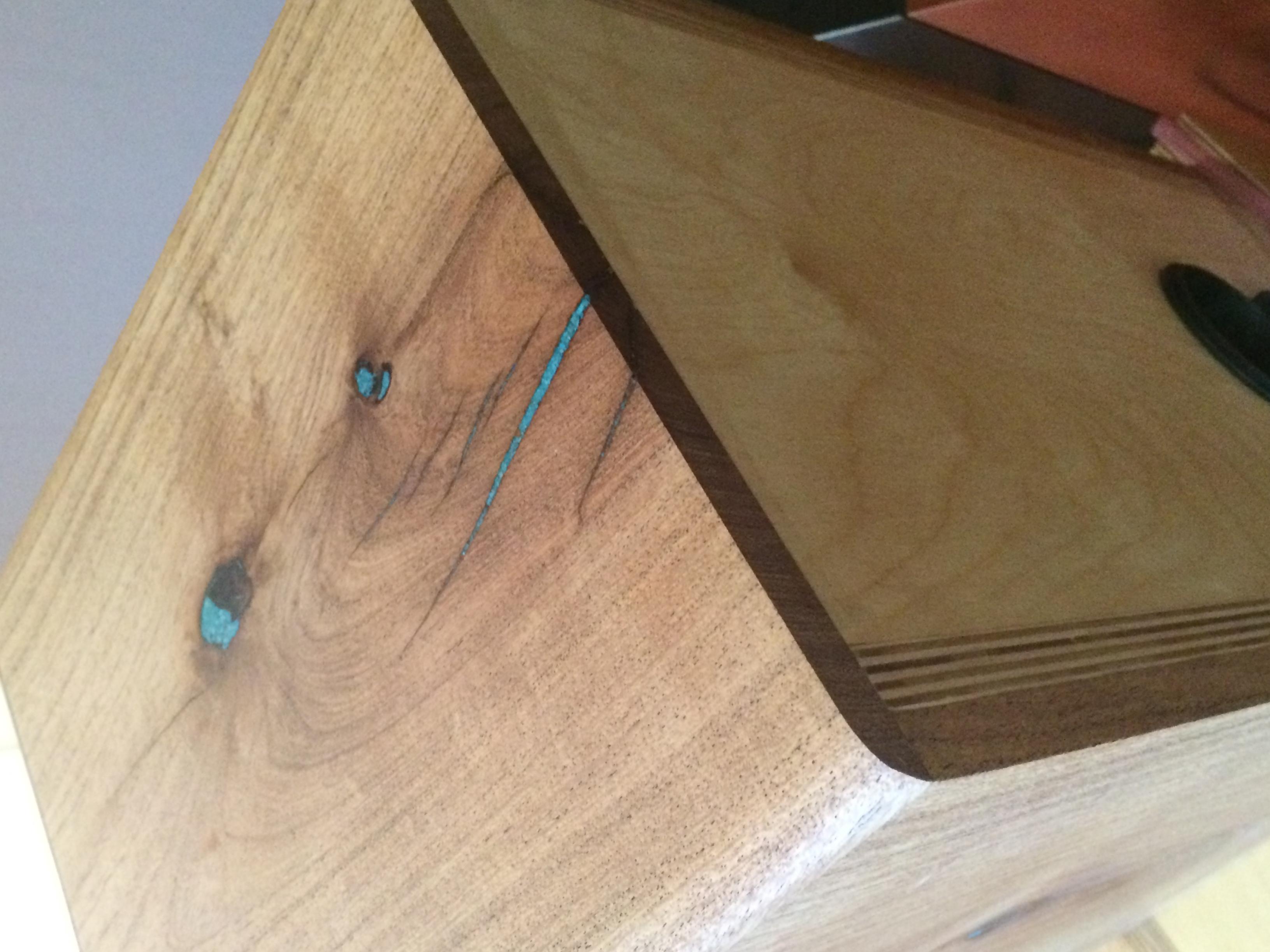

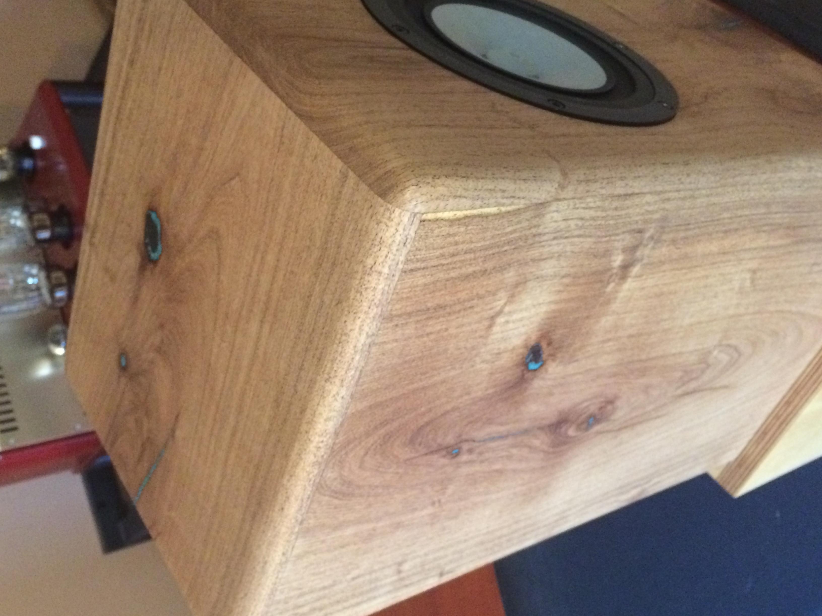

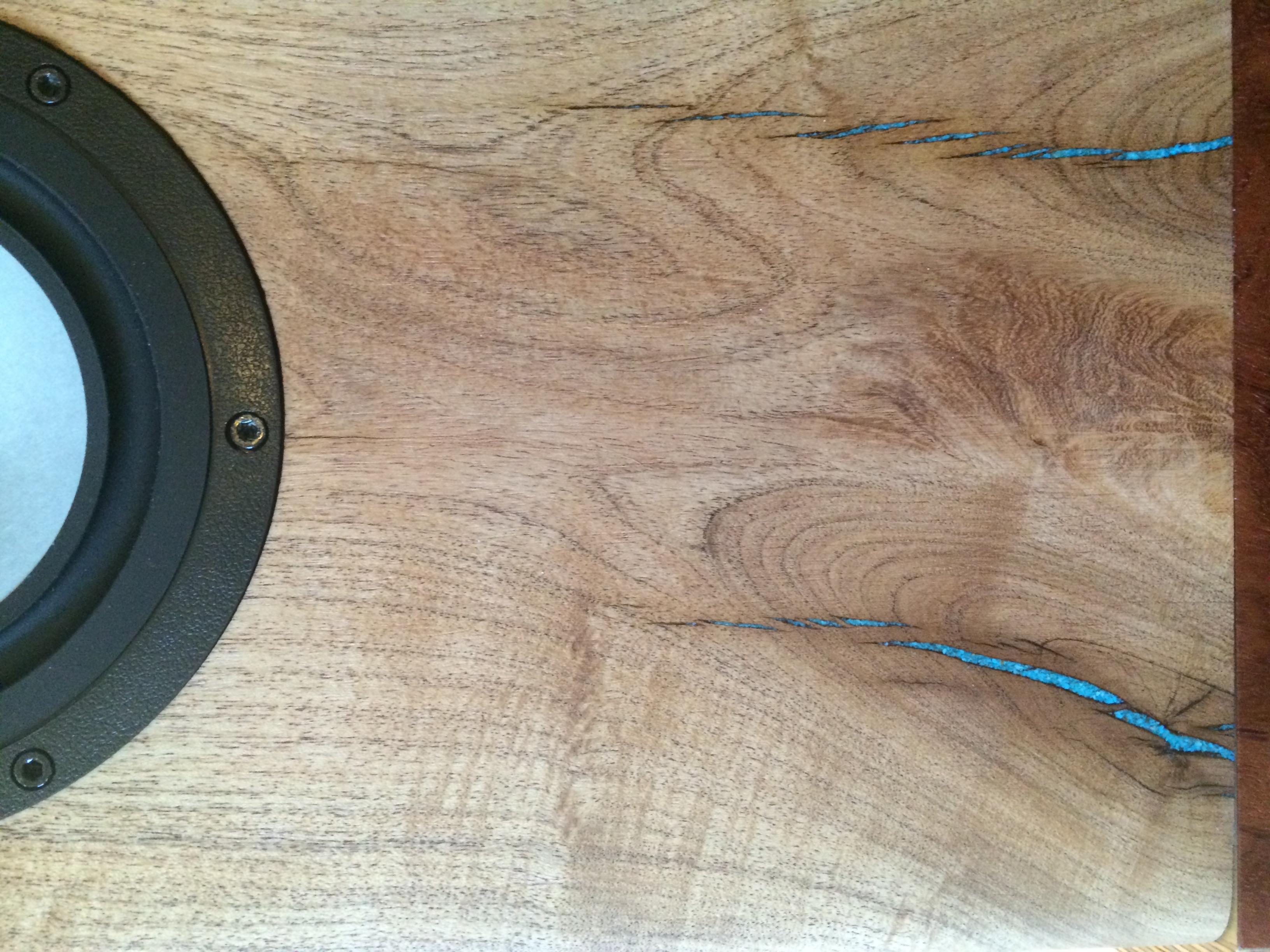

I used regular Titebond wood glue to glue 3/8" mesquite panels to proper plywood bookshelf kit (MA A10p) from Brines Acoustics many years ago and have had no problems with it. I did use epoxy though to seal crushed turquoise into the mesquite's cracks.
Terrific Cabinet work! Veneer can look decent, but there is most often something better and more authentic in the appearance of solid lumber.

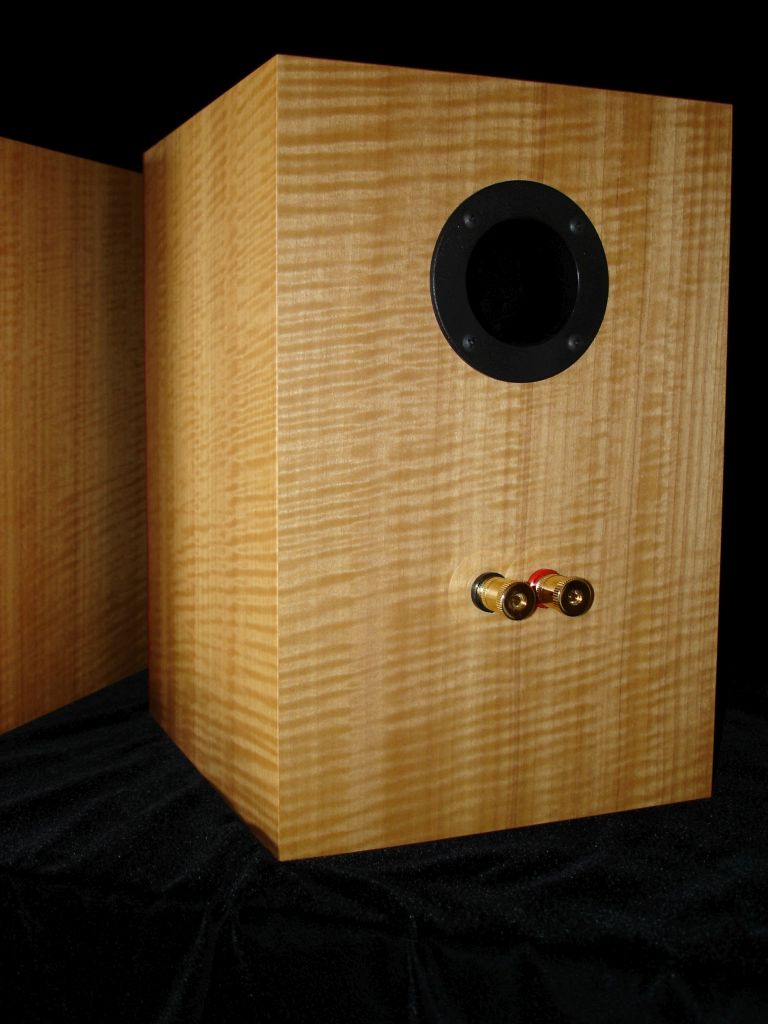

Here's some pics of the Swifty I built years ago using Padauk. The box is anigre veneer on the box (MDF). Finish is all Deft satin lacquer (spray cans).
You might be saying to yourself, why does this guy use Padauk so much? Well, I bought 10" x 3/4" x 8' piece at Rockler a long time ago 😀
