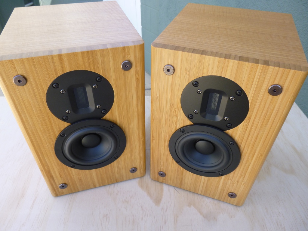

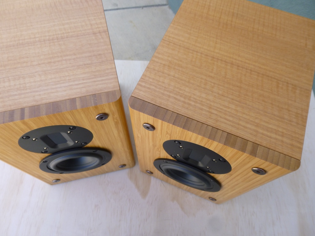

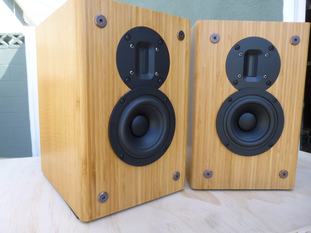

I like to make the baffles removable - no glue required :)
