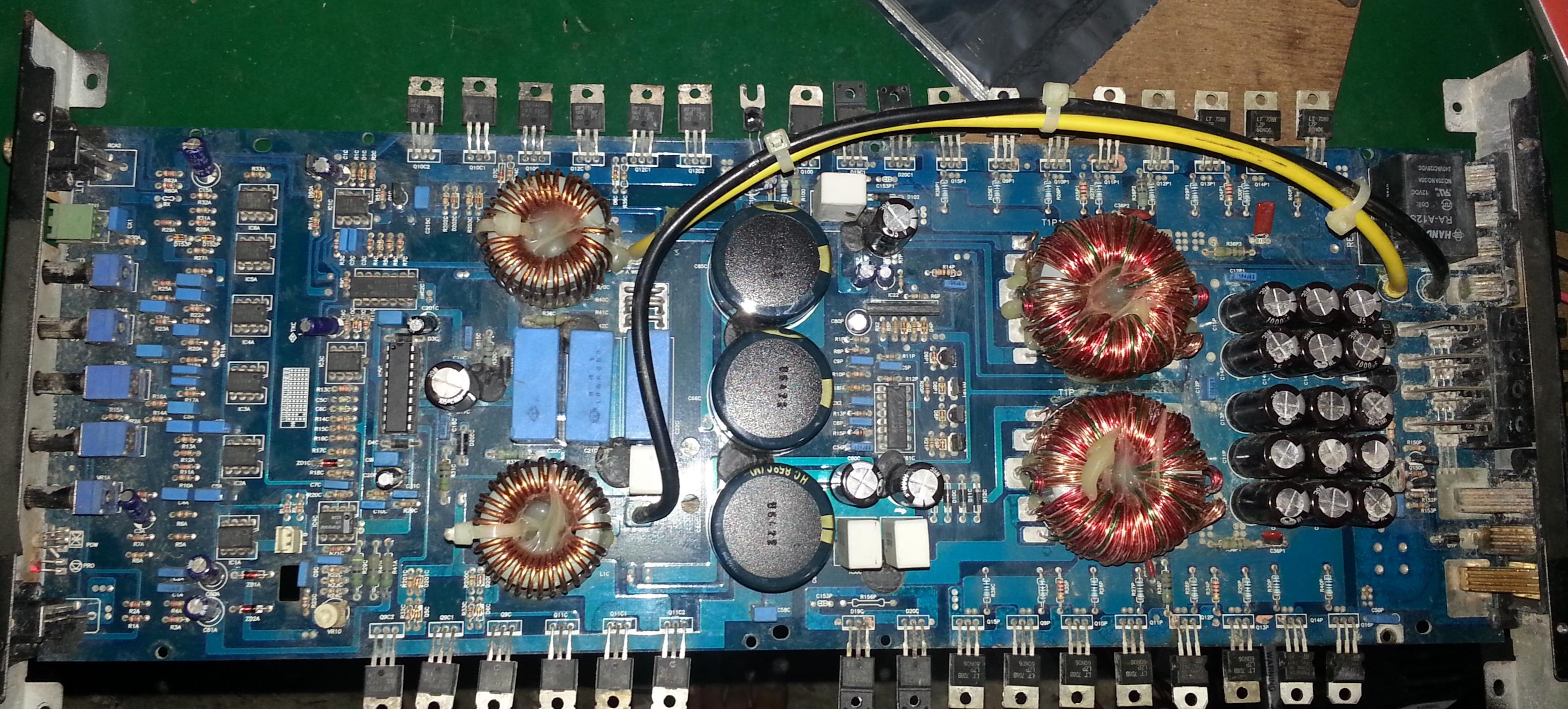

Good Day! I have solid audio 1500 watts rms does not have an output. This amp is not in protect state.
I replaced with a new HIP8040 driver but still no output. I have +-12V into op amps. I have a rail voltage of +70Volts.
IC HIP4080 Voltage reading

Pin3 is Disable, you're showing it high which means something external to the HIP4080 is disabling it.

Can I extend my inquiry? May I know what is the function of the potentiometer nearby and what is the correct setting?
Without a schematic answering that question will only be a shot in the dark. A pot might be related to adjusting the dead time of the output MOSFETs. But as I say, its just a wild guess.
The pot is DC offset on similar amps.

The LED lit on power side and not the protect LED. There is rail voltage and opamp voltages.
During a cold boot, there some thing scratchy noise that you can heard...after a while it gone. then silent...
If this amp has 470K ohm pulldown resistors on the output transistors, you can power it up without the 4080 in the circuit. Does pin 3 go low without the 4080 in the circuit?
Has anything else been done to the amp besides replacing the 4080?

This amp was junk for more than a year. I found some rusty component such capacitors. Yeah without the HP4080 the amp still powered up. I will measure the pin 3 and get back to you.
This amp is fixed! I found cold solder on gate diode. thank you!!!
