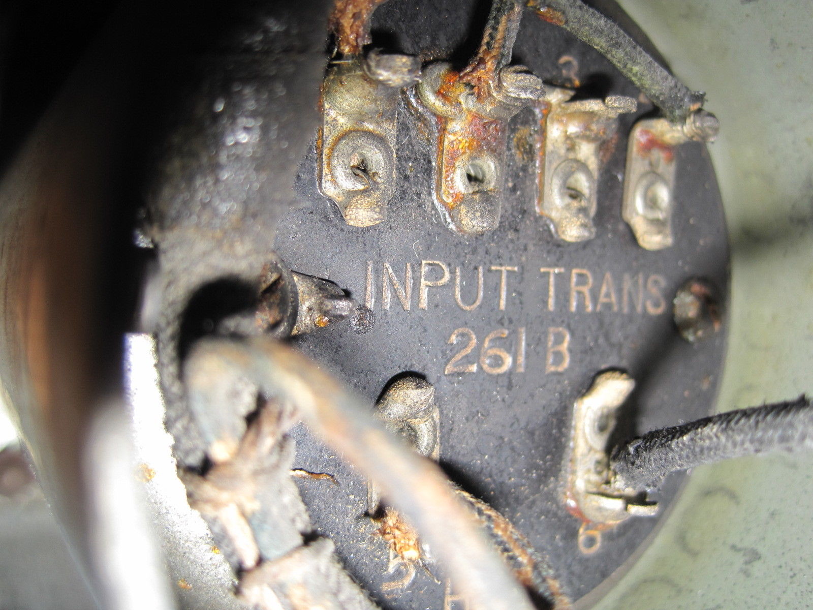

Western Electric did it (and some others, too). They wrapped each internal wire around the terminal of the component and only to fix it, they solder it. Do you get the idea behind it?
To wrap the copper conductor around the terminal pin makes a very close contact between both, wire and terminal. The gear has to function without solder, the solder is just to fix this joint against lossening over time.

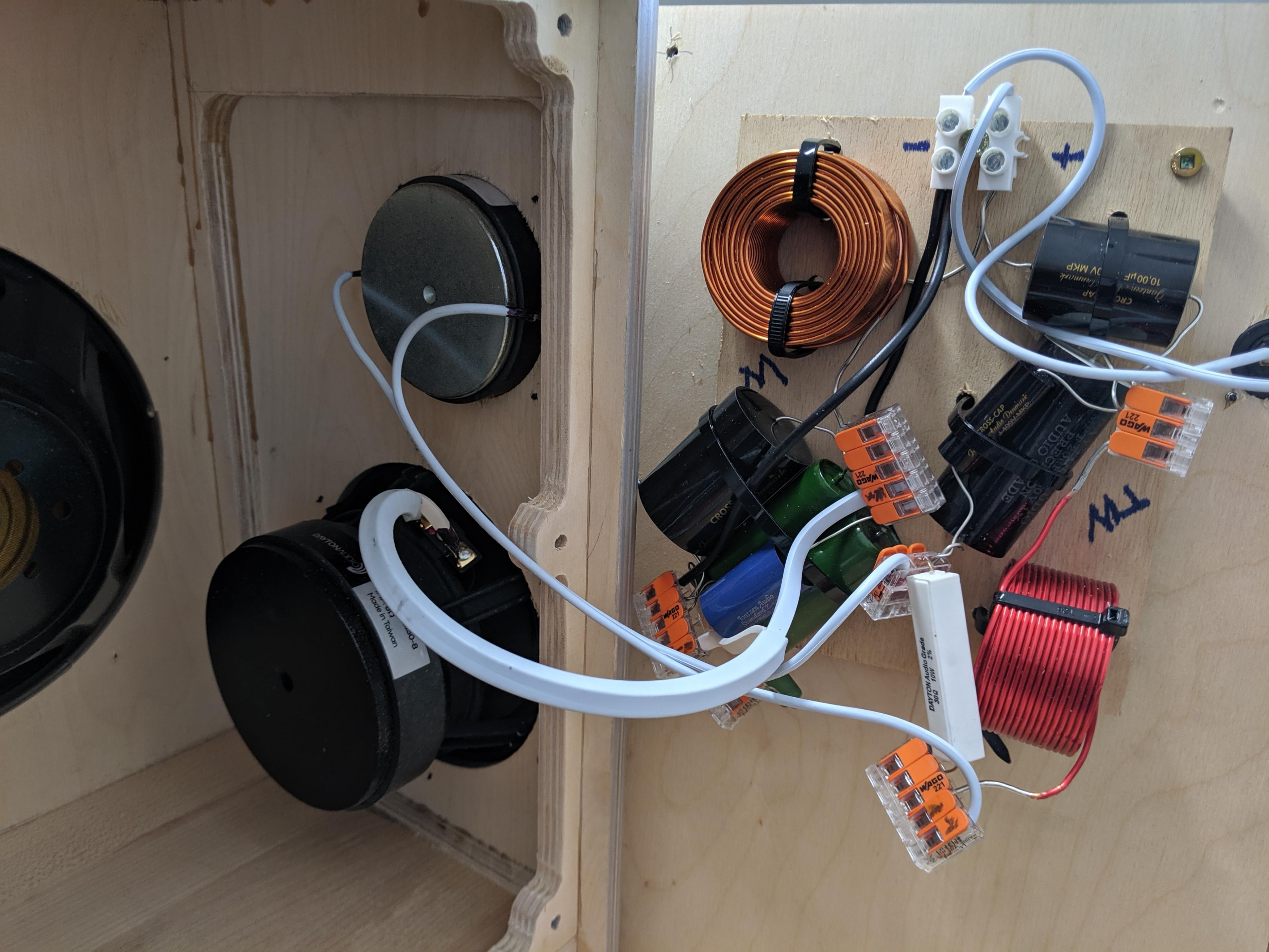

I will be trying Wago connectors for my prototype builds. I use Goop to fix the connectors to a stable surface.

It's a holiday weekend (for US people at least) so perhaps I'm not thinking correctly but how do the Wago connectors help with the small leads on resistors and capacitors?
I can't find photos of my preliminary attempts at using Wago connectors and since we have recently moved from Maryland to Australia, my stuff is on a boat approaching Melbourne. I may be back to building by Xmas.
The Waygo units come in different sizes with 2 to 5 barrels and a common backplane. For example in a five-barrel unit, you can connect four ground wires coming in to a star ground and use the fifth barrel wire as the common ground.
The wires on resistors or capacitors fit quite easily into the barrels and are easy to fix or remove simply by flicking up the lever on the appropriate barrel.

Wago's are great for crossovers, etc. They make a good firm connection to a variety of sizes, types of wire. I've also used them for a while for home wiring.
I would expect them to work for point to point wiring of an amplifier.
