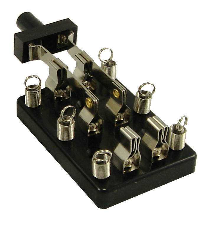

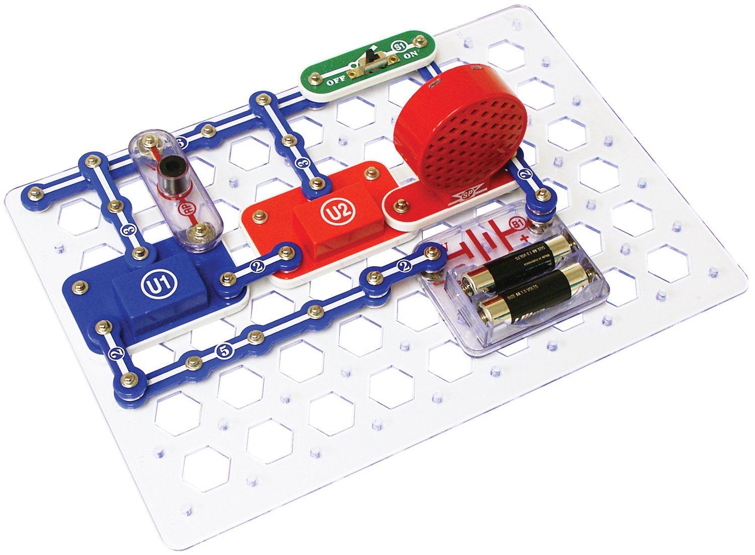

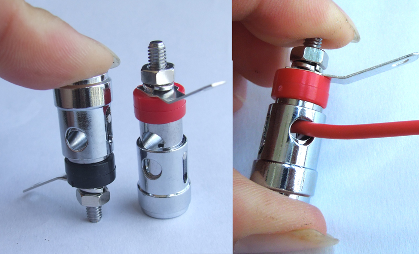

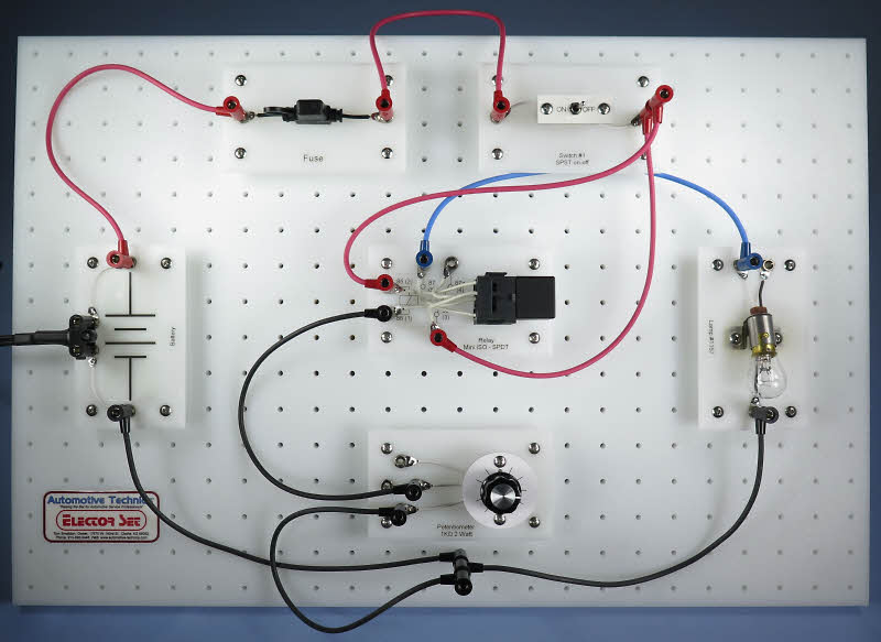

I remember the 1st Xmas gift electronics set I got. It had all the components on yellow plastic strips with plug-board pegs on the bottom. The terminals at each end were single octal tube pins sticking up, with push-on-clip wires for connecting things up.
Now there are spring binding posts..., etc:

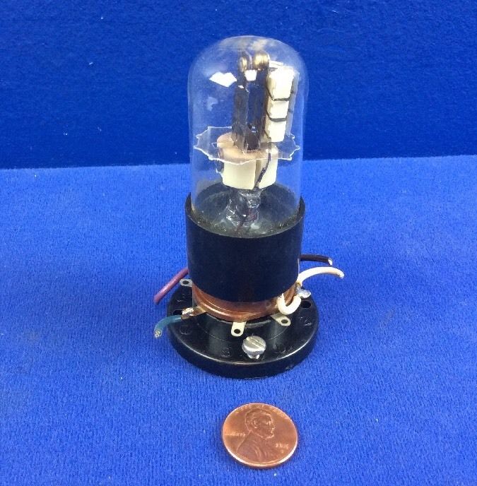

I've been looking through some Google pics of old tube related gear, and I just found
Pomona "surface mount tube sockets"!
Not quite what one might expect these days.
http://www.technicalaudio.com/pdf/Electronics_Catalog_Extracts/Pomona_socket_savers_1960_REM_24.pdf

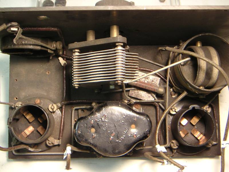

I was actually referring back to the earlier part of the thread about whether using solder really makes an amplifier sound different. Anyway, those early radios tended to be pretty simple affairs, with few joints to go wrong.Of course not, they just chose whatever method was most convenient. Still, it shows that screw contacts were apparently not that unreliable under domestic conditions.
