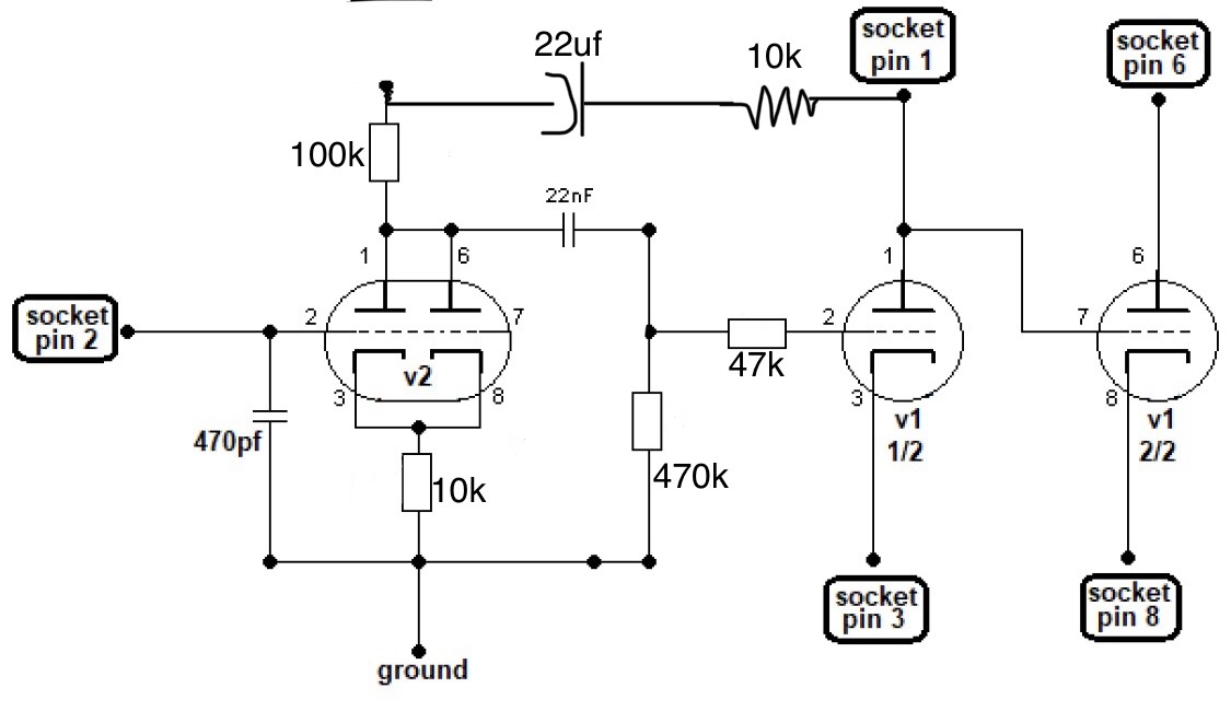

Yes yes I am really very happy because it worked and especially with your help. I measured the gain in decibels, it has extra pre-amplification and it is at 32db.. Of course I would like something more, so I thought since I have an extra triode. Use it properly.
Just take care of what you experienced if you want 3 gain stages + CF in a small box: oscillations.
By now you are having lower gain than expected because you are wasting part of the paralleled stages through the feedback anode-to-anode with the following stage.
Which kind of sound do you want to get? I can help you more if you have a reference in mind.
Mainly I don't mind being bothered. Anyway, I like suffering and I learn things from mistakes. Now for what sound I want, For example the sound of this amplifier I like very much, it's warm and bright, it just needs more gain db, for modern metal, I use a booster pedal of my own construction .. clean booster, I've relied on it enough on the mxr micro amp. not the ts9-ds1-t808 and all those with diode clipping.so I'm thinking of splitting these 2 parallel triodes and getting a gain of around 20-25 db gain from each one
Instrument amplification it's not dB amplification per se, but more a shape of frequencies and harmonics to be amplified downstream.
I'd go for something like 100k 10k, 220k 2.2k, 220k 2.7k then CF. Attenuation and frequency shape to be determined.
Sorry … I don’t make some change on this 2 triodes , only on the extra triode ,, let me ask you something else, do I like having high output impedance? or low, on the parallel triodes, because if I want less I have to separate the triodes. Am I talking good or nonsense?
Look ,, I want more gain, meaning more saturation. in order for this adapter to be considered worthy to be inserted into the amplifier.. I'm thinking of splitting the parallel triode and making 2 gain stages instead of an extra,, but not as aggressive as the parallel triode, but something like - 100K 10k and 100 4.7k and maybe with a bypass cap .,,, be more weak compared to the original parallel but in the series to give something more in gain / saturation,
really it's as close as I can get to the sound I want .. as for the changes I made to the parallel triode are the following :
156k plate resistor - 8.2k cathode resistor and bypass with 330Nf … the sound is amazing !! It’s very chugging! with these changes there is no oscillation at all and also i haven't messed with anything other than the other 2 triodes .. i want to do some more tests though ,,,
So, it's too late to sketch and scan it now.
I'll try to resume here, tell me if it's clear for you:
  1. add a 10k 22u PSU node from the CF node, to supply the two added stages;
  2. keep the 470p to ground, then first stage 100k 10k with a 470p snubber;
  3. 22n to 470k to 47k to ground (to be chechek based on your preferences);
  4. 100k grid stopper to 220k 2k2;
  5. 22n to 470k to 47k to ground (to be chechek based on your preferences);
  6. Keep the last two stages as standard.
The 3nd and the 5th it’s the same ,,, and the 4th I don’t understand ,, but this understand , check it
