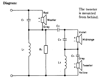

Tandberg of Norway were always big on series filters too:
496143d1438221710-crossover-elimination-tandberg-hifi-15-png
Not saying the Tandberg HiFi 15 was any good, of course. But decent Celestion and SEAS drivers IIRC.

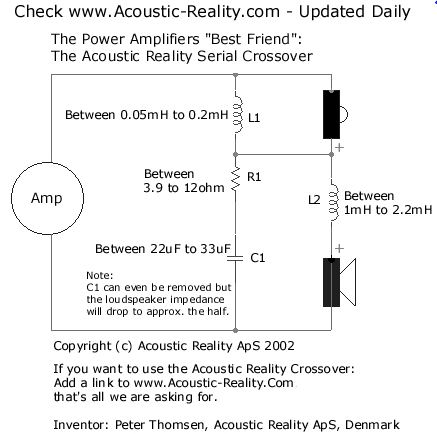

Mr. Troels Gravesen was very scathing about this piece of series crossover nonsense:
496141d1438221273-crossover-elimination-acoustic_reality_crossover2-jpg
Worst thing he ever heard.
Serial filters can turn out awful, but then you have to redesign them 🙂 I did talk to Gravesen years ago, and at that time he didn´t fancy them at all, but then again at that time he didn´t think that capacitors had any impact on the sound either 🙂
I also thought that if a speakerwire is thick enough, it will give a good sound. And that is proved wrong, so we all have the right to change our minds.
I have designed 5 speakers with serial filters, all sounding very good, but with a lot of time in between, so that I have forgot the reasoning behind the design.
There is a Dutch guy who really are into serial filters, and it should be possible to google him.
In the AR schematic R1 is an attenuation and C1 determines the crossover FR for the tweeter. L1 and L2 determines the crossover FR for the woofer. I am not sure why he split split L into 2 coils.

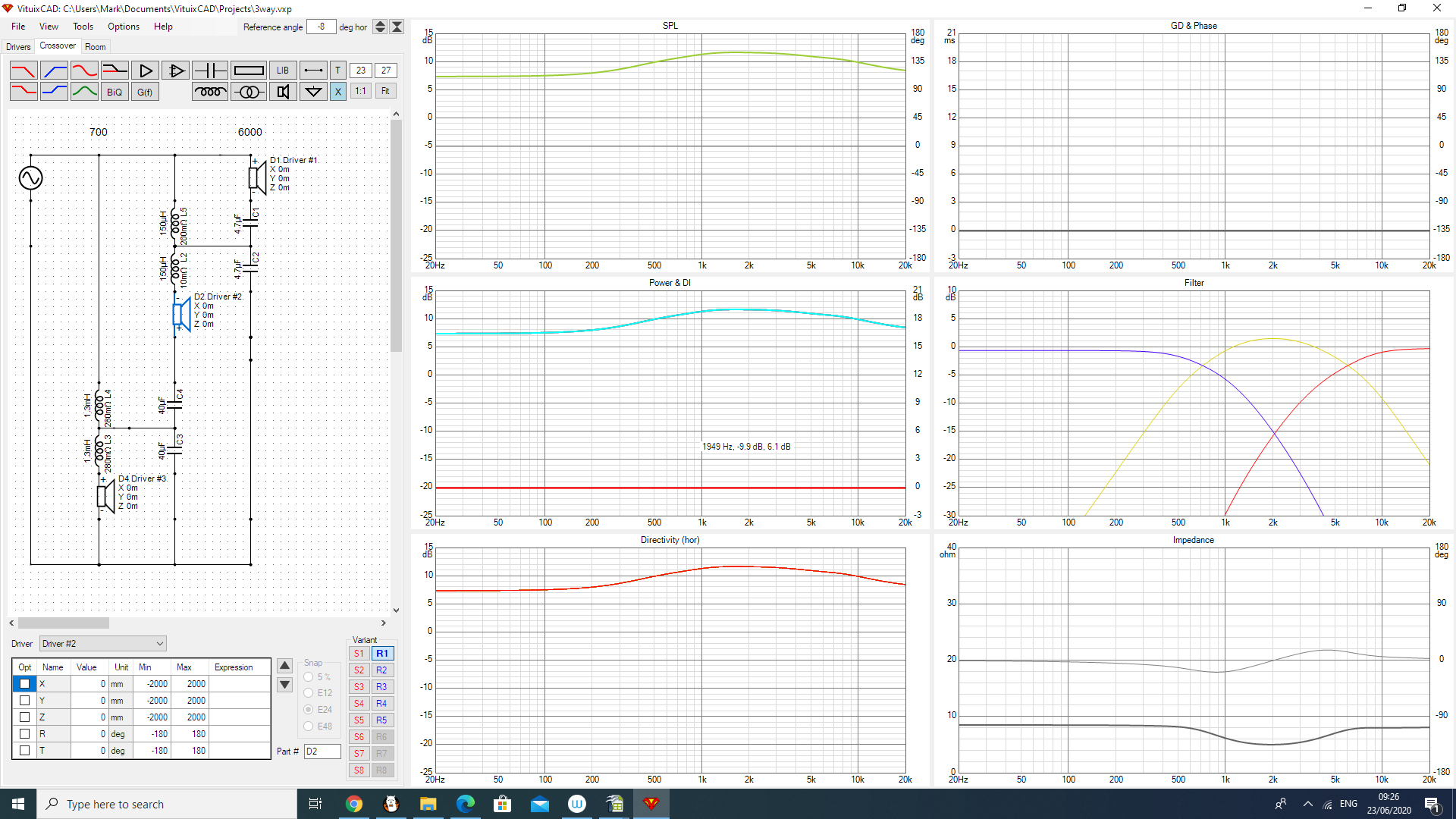

i want represent this scheme of 3rd order series filter in xsim:
for example this is the ground on parallel xover:
but for series 3rd order (don't care about components values) what is the correct ground?:
1)
2)
3)
1) is the correct way.
3) works also but is an illogical way to depict it.
Remember, there isn't a ground in AC, you use the ground symbol in the parallel crossover as an aid in designing it, but you don't have to either.
