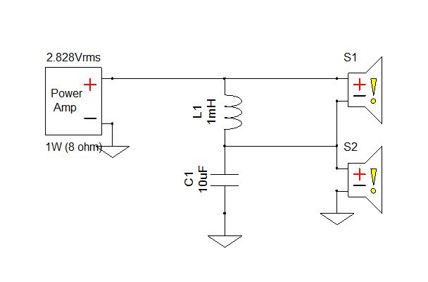

Series vs. Parallel Crossover Networks
This is a 1st order serial filter (6dB) and S1 is the tweeter and S2 the Mid/woofer.
You should impedance linearize the woofer with a Zobel, and you need to be carefull not cross the tweeter too low. If the fs on the tweeter is 500 Hz, you would want to cross around 3-4 KHz. And that means that the woofer has to go quite high too. If they cant, you will need a higher order crossover.
It is almost invented in my backyard (Dynaudio) They used those filters most of the time in their older speakers.
They should be phase linear, and they ´distribute´ the whole signal, so that you will not get any positive/negative peaks at the cross over frequency.
You would also want to use a tweeter LCR resonance filter to get the most out of it.

Serial filters can turn out awful, but then you have to redesign them I did talk to Gravesen years ago, and at that time he didn´t fancy them at all, but then again at that time he didn´t think that capacitors had any impact on the sound either

In the AR schematic R1 is an attenuation and C1 determines the crossover FR for the tweeter. L1 and L2 determines the crossover FR for the woofer. I am not sure why he split split L into 2 coils.

1) is the correct way.
3) works also but is an illogical way to depict it.
Remember, there isn't a ground in AC, you use the ground symbol in the parallel crossover as an aid in designing it, but you don't have to either.
