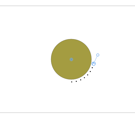

I'm trying out Affinity 2. Its impressive but can it accomplish particular arrangements.. There's a lot to decipher. Placing small circles(dots) "precisely" on a circle snapped at 7.5deg is a challenge at this point in time..The simple protractor and arc tool in sketchup make it easy as shown in attachment.

So you know, you can move the rotation origin, and specify the degrees of rotation in a dialog box. The Duplicate command remembers the last displacement. So another way to achieve a circle of dots is:
draw dot,
move rotation origin to center of knob,
duplicate,
change duplicate rotation angle to 7.5 degrees (separating the dots),
duplicate, duplicate, duplicate… adding all the dots around the circle,
select and cut unused dots.
of course the same trick works for bars, numbers, etc.
Affinity 2 is WYSIWYG (what you see is what you get). It’s friendly.
Some might prefer to specify in written code what they want, instead of drawing it. For them, a 3D design software like OpenSCAD - free and well supported - may be another option. You write in OpenSCAD language what you want, and hit “Preview” to visualize the result. Changing 7.5 degrees for 10 degrees (playing what if) can then be as simple as changing a number in the provided editor and clicking Preview.
draw dot,
duplicate,

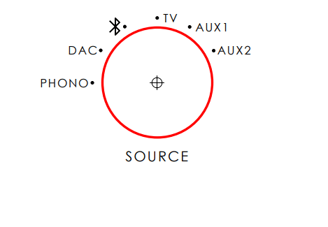

WOW, thank you. Looks like I'll be paying to keep Affinity after 30 day trial.
Google layout now appears primitive to me and it is $300 per year after trial period
