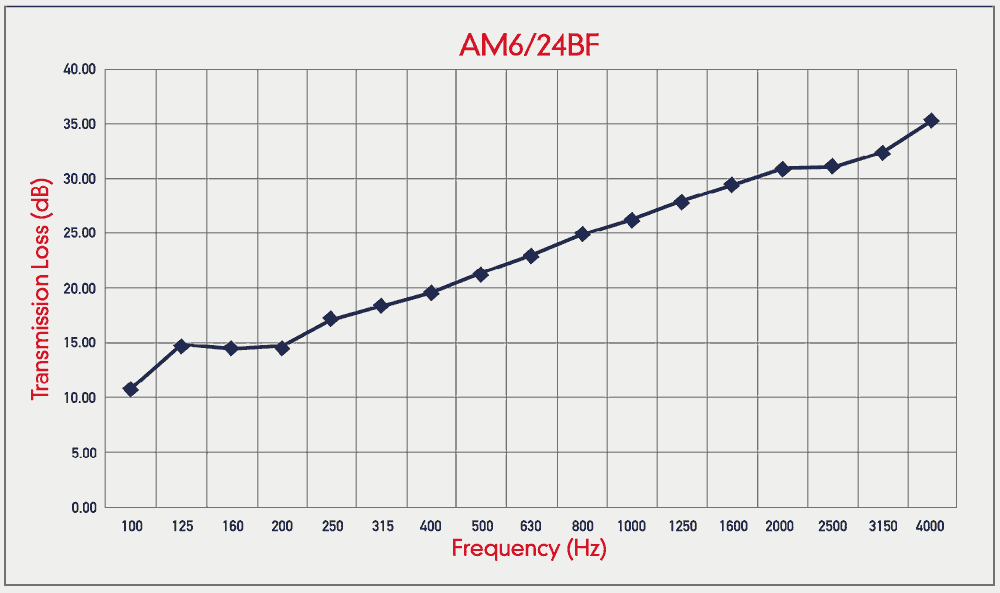

The best link I could find is here: https://www.retwine.co.nz/site//file/product/50/files/Acoustic Multigrade_spec.pdf which illustrates one of their products (Multigrade) which was a faced Acoustop foam.
