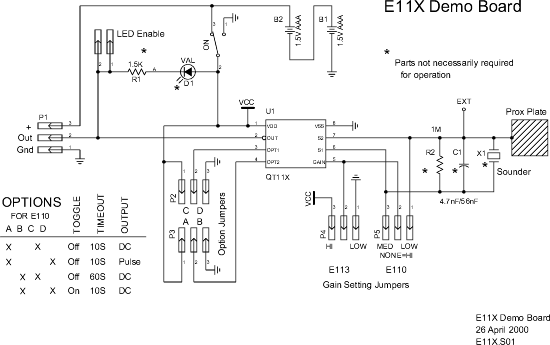

I have to add, that I really can't believe how simple and cheap these things are. Self-calibrating? Come on! What's the catch?
implementing into...
They offer an evaluation brd w/ schematic...
http://www.qprox.com/products/e11x.php
here is the schematic for the E11X...
but yes, I could not slip this in if it would work.
Yeah, that's easy. The slider has a serial output, which means you need a microcontroller etc to interpret the signals and pass them to a digital volume control. The DS1802 has a simple VolUp/Down button interface, so you could use two 110s for that, and another in toggle mode for power. Maybe a source selector too, if you can find a selector IC you can live with, or maybe drive a lagic chip then an array of relays. I need to spend some time with this....

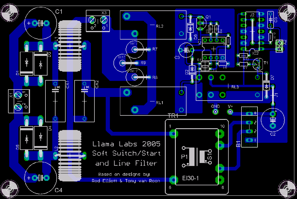

is it too late to suggest adding in a DC block to the neutral line? It would need a rearrangement of the components to create the spare space in that area?
Then all the mains is on one board.

Merging soft power-up circuit with output protection. Comments?
Basic design:
Separate power supply for driver stage. Includes time delay to relay for soft turn-on of output power supply. The driver circuit includes a servo to control DC offset, and a shelf circuit which triggers if the output has significant DC from a short circuit or shorted output transistor.
Output power supply has soft turn-on resistor and shunt relay that shorts out this resistor after the timer on the driver board triggers and the shelf circuit is off. This relay is DPDT, and also has a 1 ohm resistor between the amp output terminal and ground in the "off" position.
Main power switch turns on driver supply and the soft turn-on resistor path to the output power supply. When the timer on the driver triggers AND the shelf circuit signals "no short", then the turn-on relay is activated and the 0.1 ohm shorting resistor removed from the output.
If an output short occurs, then the relay falls open, the 1 ohm shunt resistor in put in parallel with the speaker to protect it, and the output power supply is run on the limited current from the soft power-up resistor. If the short goes away, normal operation is returned.

I had thought about this, but I was trying to keep the board as small as possible. This would certainly increase the size quite a bit. To help out a little, I added some testpads so that any other additional 'accessory' boards could use the power off this board. I also decided to put a decent line/DC filter on the front end. The board is still fairly small, coming in at approximately 5" x 3.25". Here's a screenshot...
And here's the obligatory .brd file...
I based the line/DC filter on the one in this post. The addiotional cost is only about $15. I'll update the BOM and post that soon as well.
Just out of curiosity, would there be enough people interested in this to do a small board order?
Yes, at least two, maybe more.
Thank you Ble0t...
By small, I mean just 25 boards. It would only be about $13 per board for both top and bottom masked, silkcreen on top and 2oz copper. It's something to think about at least.

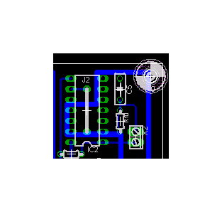

sklimek said:Hi, would this mounting hole taken from your latest version be a problem?
How so?
OK...gotcha...that's actually a 'fill' that is on the board (polygon tool). Hit the 'Ratsnest' button to have it fill in and also avoid the restricted area of the mounting hole.
ble0t said:OK...gotcha...that's actually a 'fill' that is on the board (polygon tool). Hit the 'Ratsnest' button to have it fill in and also avoid the restricted area of the mounting hole.
