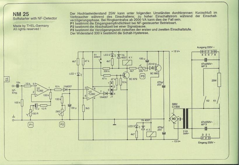

I have just bought the attached circuit from a German firm named THEL. The quality is fantastic, maybe a little expensive, but this circuit is just what I needed... at least this what I thought!
Depending on the position of the J1 switch, this circuit behaves in the following ways:
Pin 2-3 shorted: simple softstart. The soft start duration is determined by a trimmer
Pin 3-4 shorted: the circuit is activated by an external signal (0.2 mV to 2mV, sensitivity set by trimmer), cycles through the soft start time and then stays on. After an adjustable period from the last signal received (1-10 minutes, set by a trimmer), the circuit turns off.
Pin 1-2 shorted: the circuit behaves like a soft switch activated by the S1 switch. Therefore, when S1 is closed the soft start cycle starts and the circuit is activated until S1 is opened again.
I have a problem with the last way of working: I didn't understand that the circuit operated based on a switch (i.e. permanent contact), I thought it operated based on a button (i.e. a momentary contact turns on, another momentary contact turns it off).
I definitely need the circuit to work with a button. Can anybody tell me if there is a way to modify the circuit in order to implement this feature? Help please!
you need a latch.
Add a third relay in parallel to K1.
After the button is pressed both K1 & K2 come on. K1 starts the timing period and things work as designed. K3 output contacts are wired in parallel to S1. K3 will now hold BC879 on and maintain voltage to the timer even after you release S1.
A comment on the design if I may. K1 & 2 are wired to hold in on full voltage for the whole listening period. They will run pretty warm and the extra K3 will also do likewise. Select a suitable relay and make sure the enclosure is well ventilated. Even better if you could modify the circuit so that each relay receives a higher voltage pulse & then holds on with a reduced voltage, usually about half to two thirds rated voltage.
Check my logic before you implement!!!!

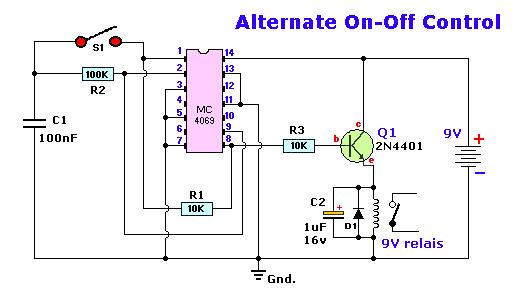

somebody posted this circuit here - I cannot remember who, apologies for not giving proper credit. you could build the flip flop portion on a small proto board and connect the output to the end of the switch that connects to the base of the BC879.
In the end, I've made the circuit Kristjan designed (see attachment), but I can't get the relay to switch.
Everything seems to work fine, when I connect a LED instead of the relay it works fine, the tension measured at the poles of the relay (without the relay in place) is 8.3V
I wonder if the transistor can't provide enough current for exciting the relay. If this is right, how can I solve the issue?
Please bear in mind that all the components work fine, I've already changed them at least once!
Thanks for any help!
perhaps a silly question, but is the relay rated for 9V operation?
How much current does it draw? If it is within the limits of the pass transistor, you might try reducing the 10K resistor to permit more base current and therefore more current to the relay. You may also want to try connecting two of the pass transistors as a darlington pair for more current.
What happens to the 9v supply voltage when you try to activate the relay?
What voltage do you get at the relay terminals when you try to operate it?
The supply is oversized, I've operated the relay by tapping it directly into the regulator's output without any problems. In this configuration it draws 50mA approx.
Based on what I know about the transistor, it shoud be able to operate it without any problems. However, when I measure the voltage with the relay in place and the circuit activated I find only 2.5V.
I've also tried to measure th current flowing to it and it's 16mA approx., way too low.
I've tried lowering the resistor feeding into the transistor, but with 5K (instead of the original 10K) I get only 19mA
Can I put 2 transistors in parallel? Alternatively, how much can I dare lowering the resistor?
I have assembled this circuit, and had the same problem initially. I found out I had my collector and emitter reversed :xeye:

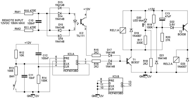

Also, I've been working on a combination momentary switch + soft start circuit (based on Rod Elliotts P39 and the momentary toggle circuit posted above). Here's the schematic if anyone is interested (sorry if it's a tad sloppy).
EDIT: Beaten to the punch by SY 😉
switch + start circuit...
Hi, yes definitely interested, looks like a good one to crack my knuckles with my Eagle lite program.
Exactly.. Im building these too. But the transistor he used is to little for the current.
