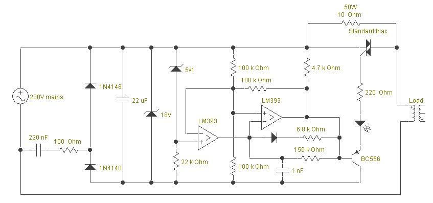

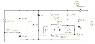

10r suits Eva's very large load and necessarily high fuse value.
3//50r resistors will suit a smaller fuse value (maybe 1000VA to 2000VA).
2//50r resistors will suit about 600 to 1000VA.
Users with 110/120Vac will require surge resistors of about half these values.
If one were to close rate the mains fusing then higher values of resistor would be more suitable.
eg. 800VA transformer fused @ T3.1A starts reliably with 50r (100W) on 240Vac mains.

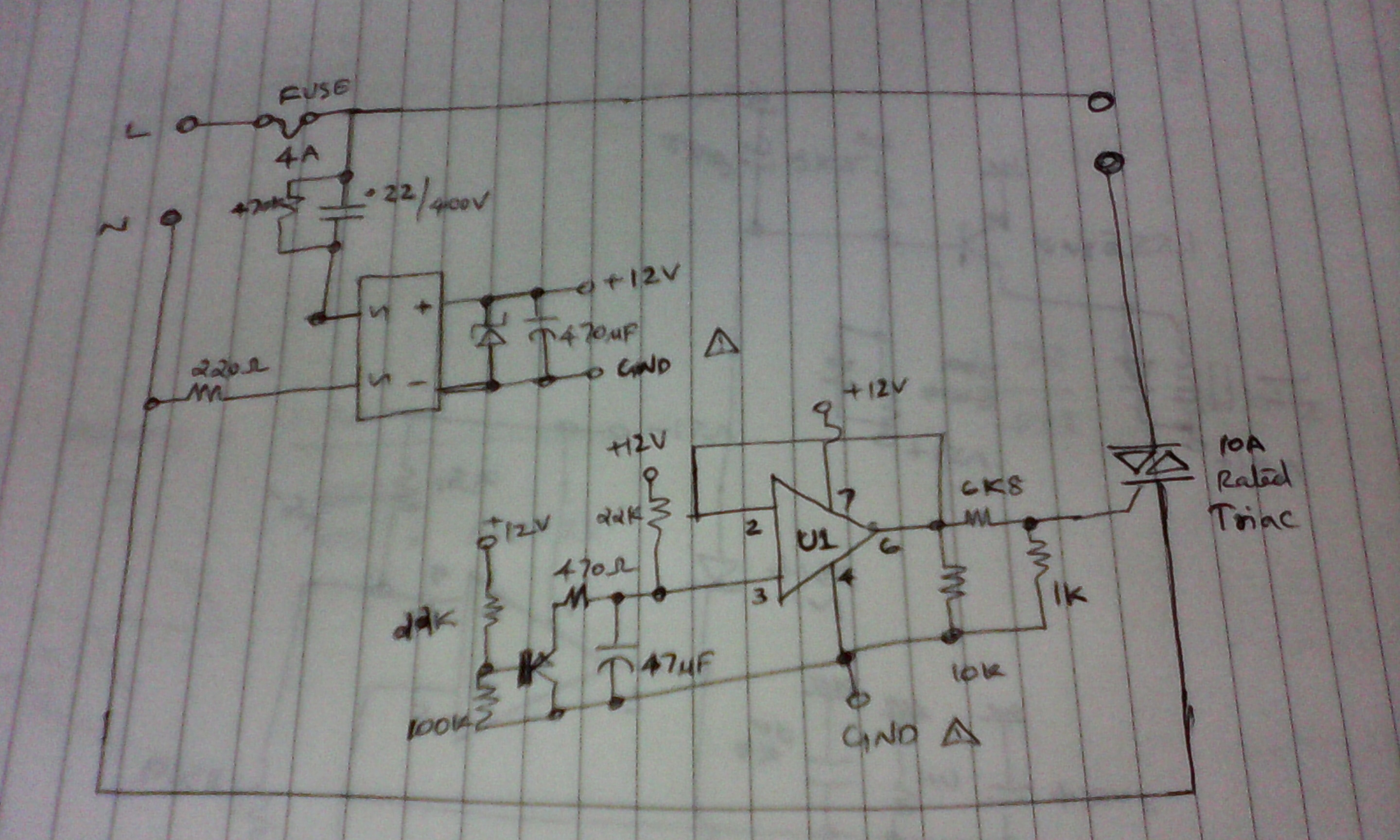

A single CD4541 can't simultaneously provide the turn-on delay and the square wave with only 5% to 10% duty cycle required for triggering the triac. A simple LM393 comparator does.

I 've just prototyped this and wil add it to my amp.
I love simplicity and elegance and can now halve the mains fuse values adding further protection.
Cudos, Eva.

it is for my 300VA torroid on my SKA150.
I am in bed with 'flu ATM and can't be a**ed to get up and check, but I think I doubled the SB fuse to 2A from 1A as it would be blown after 5 or so switch-ons.

I was wondering whether a mains (coil) rated relay/contactor will serve the purpose with the resistor across N/O contacts. After all it takes time to make the contact.
Gajanan Phadte
Gajanan Phadte
look up the AC relay data to find the time to close.
I suspect only a maximum is quoted and it could be around 10 to 15mS.
At best that would allow less than one mains cycle to pass through the surge suppressing resistor.
The info I have seen, suggest the toroid needs three to five cycles to fully establish it's magnetic flux. That's why I design for around 300mS delay on the relay.
