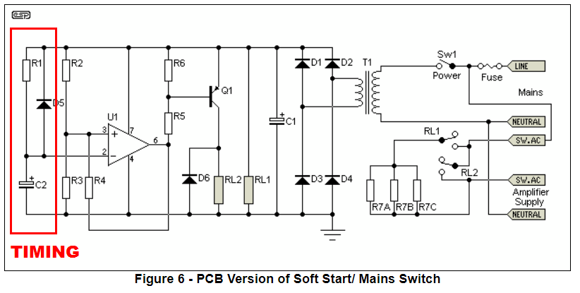

I recommend that you disregard/abandon Figure 5 of ESP's general article about soft start, and instead focus on the actual ESP project 39, specifically its Figure 6, shown below. In that circuit (which is on the PCB that Elliott actually sells), delay time is set by R1 and C2. I recommend using a 20 turn trimpot for R1, that way you can adjust the timing according to YOUR tastes, instead of Rod Elliott's tastes.

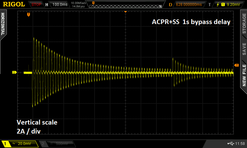

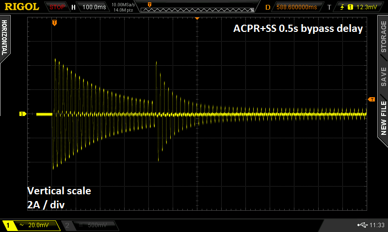

Here are a couple plots of current at turn-on, with an inrush current limiter that includes a bypass relay. They show what happens when bypass is engaged, and what happens when you vary the timing of the bypass. Of course, your transformer and your ICL resistors/thermistors and (to a lesser extent) your filter capacitors, will be quantitatively different: different peak current, different decay time, different post-bypass peak current. But the overall shapes, the "envelopes" shown below, are representative of the general situation.

bansuri, attachments 2 and 3 on post #23 are screen captures from a Rigol-brand digital oscilloscope. The oscilloscope was connected to a current probe (sensitivity: 2 amperes per vertical division) that was measuring the AC mains current of a class-AB audio power amplifier at switch-on. The power amp was equipped with a soft start board. Thanks to the soft start, peak inrush current has been limited to 4.4 amperes.
Those attachments are measured data from real-life hardware; they aren't simulations.
The reason why you don't see "magnetic inrush current of the transformer" is because the soft start board has limited it. That is the board's job after all: it's an inrush current limiter.
The purpose of showing those two real-life measurements of current-vs-time, was to demonstrate what happens at the bypass event. The bypass event occurs when the soft start is terminated ("bypassed"). At that instant, AC mains current jumps up, and if you arrange your circuit timing correctly, you can make the up-jump smaller than the initial inrush.
