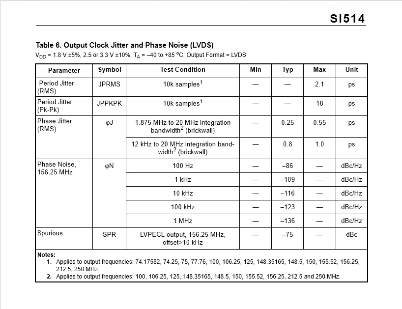

Please, take a look at the Si514 datasheet, it says 0.25 ps RMS phase jitter of course, with an integration bandwidth 1.875 MHz to 20 MHz !!!!
It would be very curious to see the RMS phase jitter with the integration bandwidth starting from 1Hz, much close to the carrier, that's the real part we have to look in digital to analog conversion

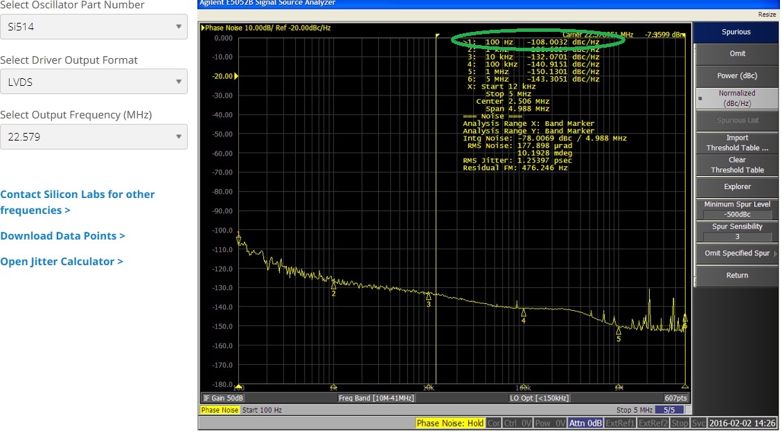

The Si514 is actually not that bad, check it at:
Oscillator Phase Noise Lookup - Silicon Labs
The Si514 is perfectly fine for most applications, those who want products with better oscillator phase noise, I have both the dam1121-01 and dam19x1 series.

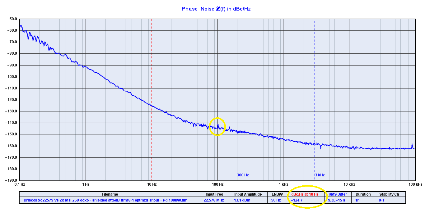

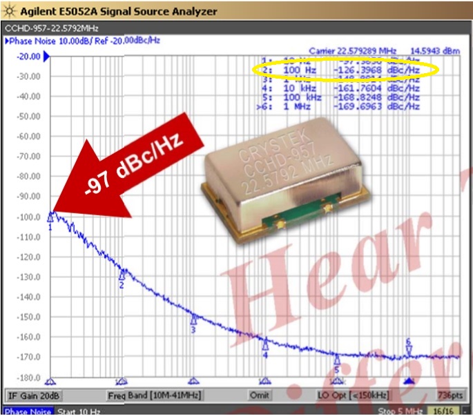

I wonder how one can say "The Si514 is actually not that bad", please see the phase noise plot at 22.5792 Mhz, -108 dBc at 100 Hz from the carrier is a bad performance.
The Crystek CCHD-957, not an Oscilloquartz BVA or a Wenzel ULN oscillator, performs 20 db better, while a good oscillator exhibit -125dBc at 10 Hz from the carrier and -145 dBc at 100 Hz.
The Si514 is perfectly fine for telecom application, not for audio.
