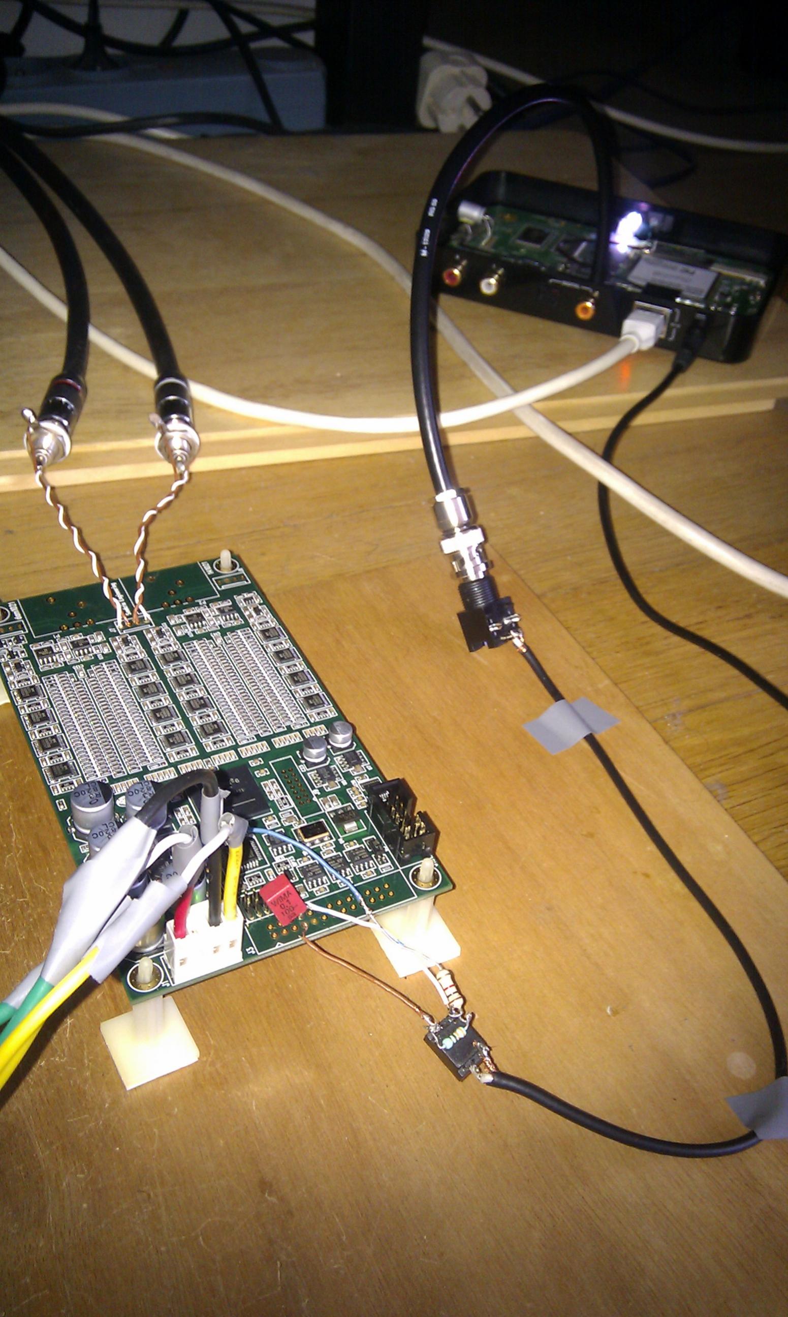

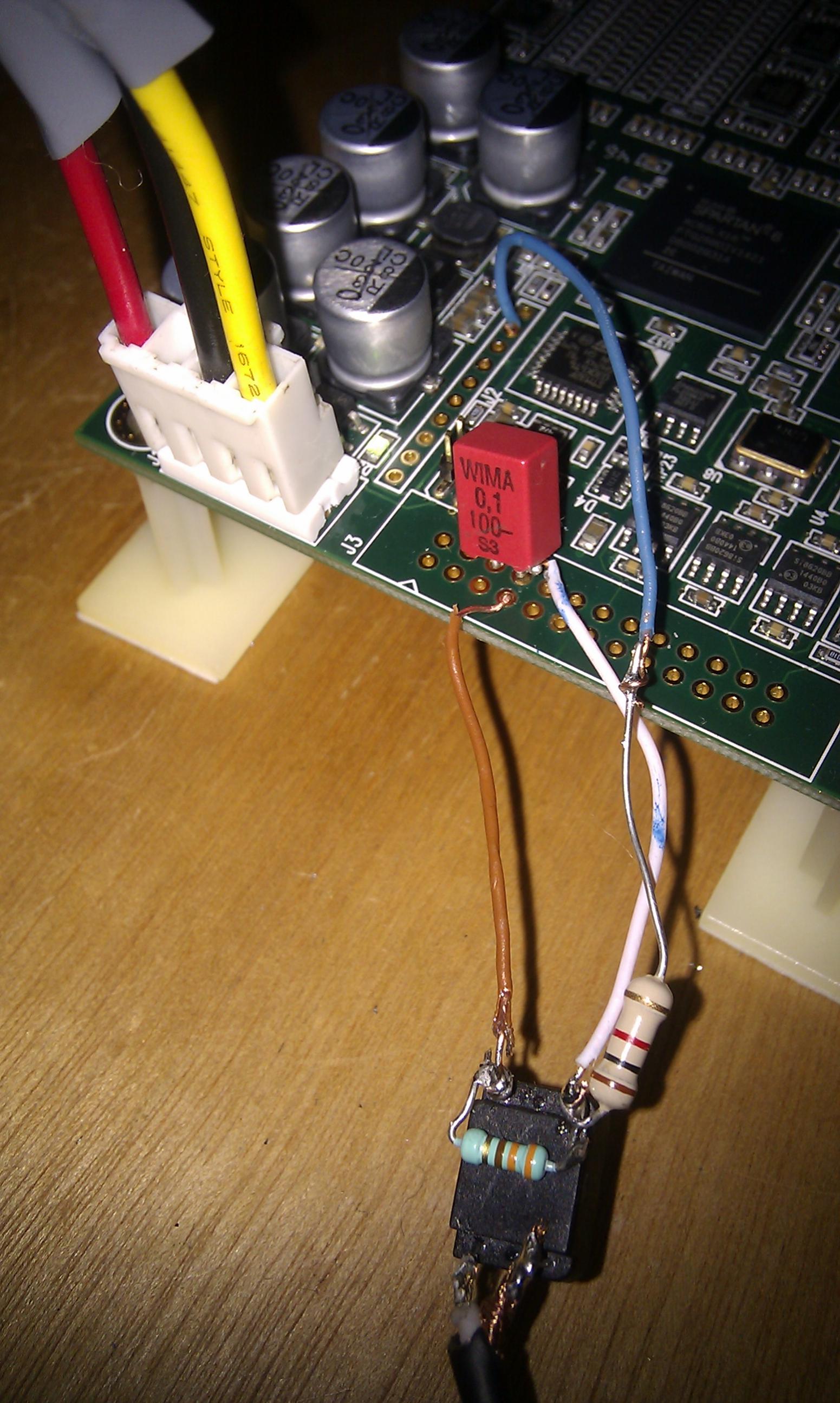

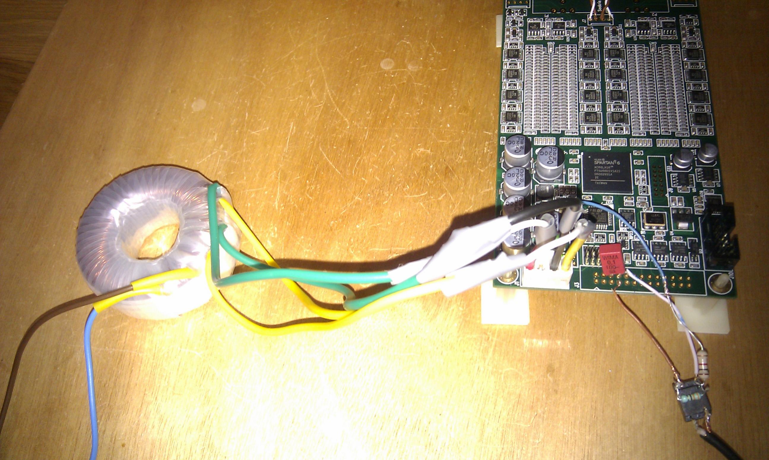

I'm slighty picked, it doesn't work with my SPIDF connection and my SB Duet !
Green led is switched on without flashing so I assume it sees the signal from SB !
I checked and re checked the two shematics and don't see what is wrong :

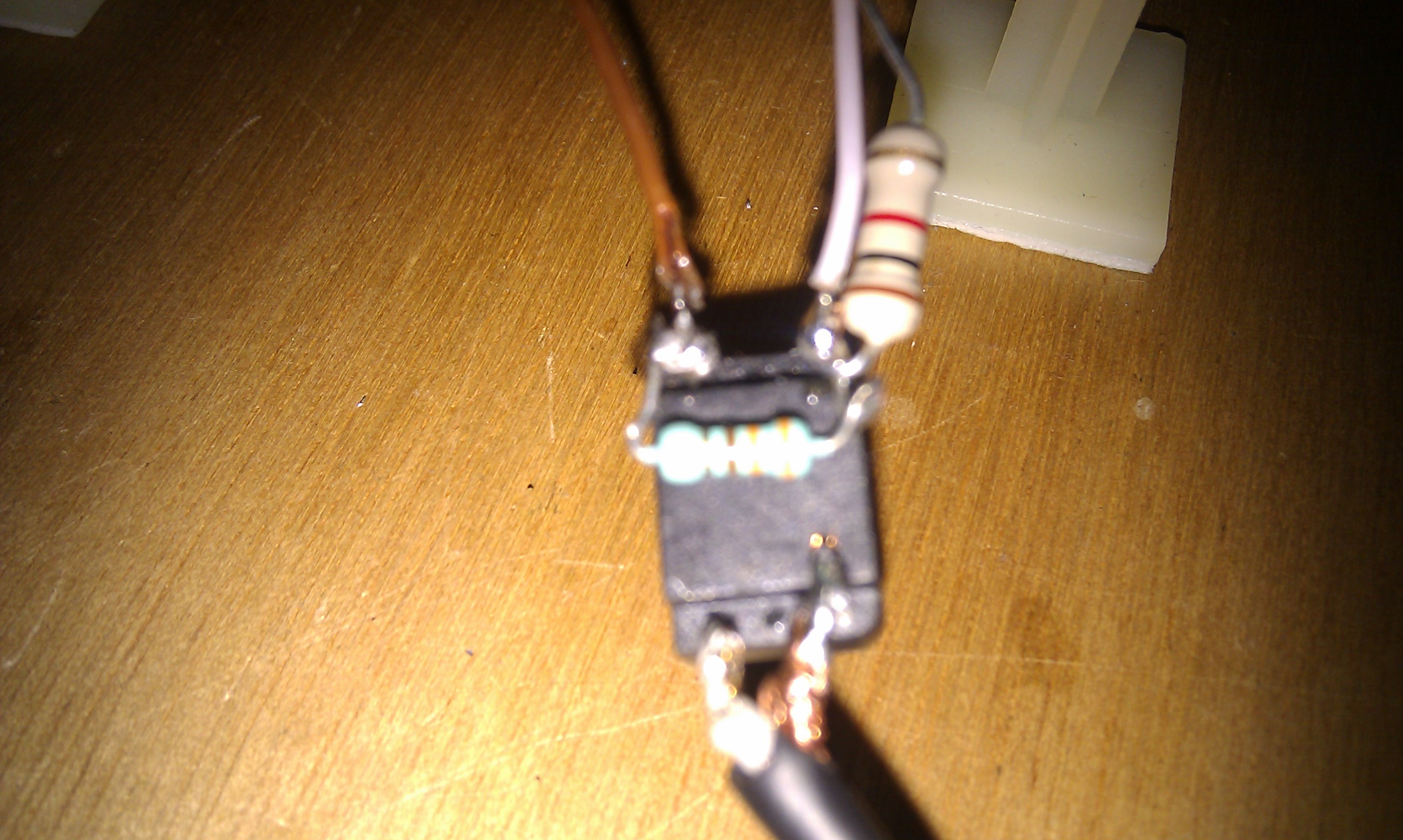

traffo is the Pulse Enginnering linked in first page, pins were checked like the signal with a DC buzzer...
Global PS is good as I finally bought a 7v/15VA to avoid any bad choice of caps with a personal DC PS !
On the photograph I took the Gnd pin on the upper row : pin 3 starting to the left ! : white wire
signal is the Brown wire.
green wire is the 1.2 V took from the board !
resistor= 330 ohms (the traffo one)
the biggest resistor is 1K ohms in serie with the 1.2 V
I have not yet my Wave I/O yet to check.

Clearly looks like a user error here. You need two 7v AC windings. Look at the diagram.

Power and SPDIF connections looks correct and if the dam1021 is locked to the SPDIF signal then things are good. Just make sure there is actually sound on the SPDIF signal....
Thanks Soren for your rapid answer.
Well the SB is good and works on a Subbu. I have to check with a second I have also. I use BNC all along the signal ! (no problem with the 330 ohms where I soldered it ?)
The led flahs green with no signal and stays green when I connect the SB !
Wll i check with the other SB Duet and check this one again with one of my two Subbu (but it plays every day ! ).
output signal is SE : with the signals took on the external edges of the 4 vias (2 vias of the center for Gnd).
:D It works !
Good sound, any harchness in the highs I had with the Subbu. So I surmise I was listening before the effect of the jitter or a ground loop : (still have to try the Subbu with the same pulse transformer to compare apple to apple ).
