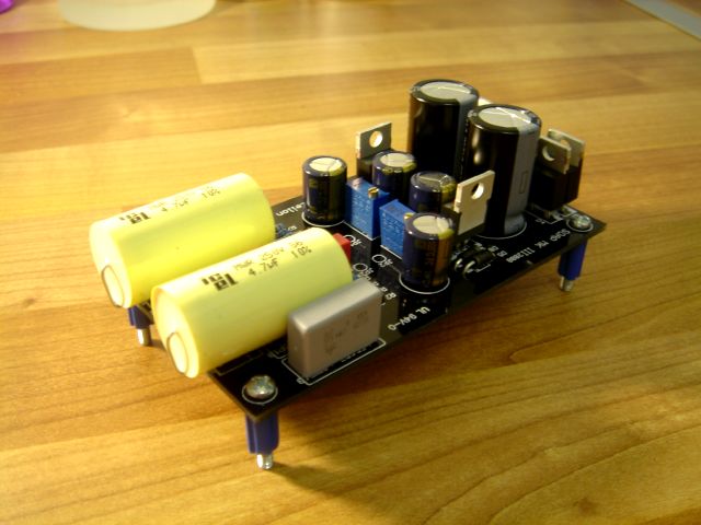

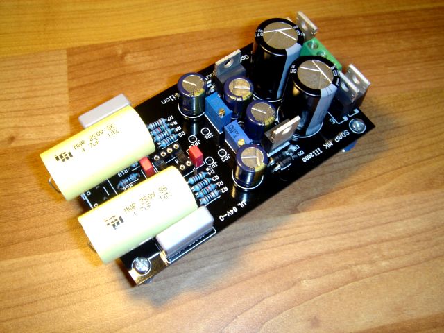

Looking good
Did you source all your parts from Farnell? If so what is the total cost. You have not fitted an op-amp, which one do you intend to use?

Why thank you...flattery will get you nowhere!
Yeah I did source the parts from Farnell, I am not sure of the total cost for this project as I purchased several other parts for an ill fated DAC project 😉 I will email the Farnell parts list to you.
I am going to use the OPA2134PA as suggested in the BOM.
As I have not tested the circuit, I thought I would leave the OPAMP until last.

Please find attached BOM with Farnell part numbers.
A couple of things to note...
C9 & C10 - The pin spacing is a little bit too wide for the 0.1uf Wima caps so I mounted them flat to the base of the board.
C11 & C12 - The 100uf Panasonic capacitor pin spacing is a little bit wide for PCB holes....you will need to bend the legs closer together.
The pin spacing is correct for all other parts
I hope this helps 🙂
Richard
WOW...It worked first time! (Its all in the title)
I have only just applied the power, but on first impressions it doesn't sound bad at all. I will let the components burn-in and report back later.
