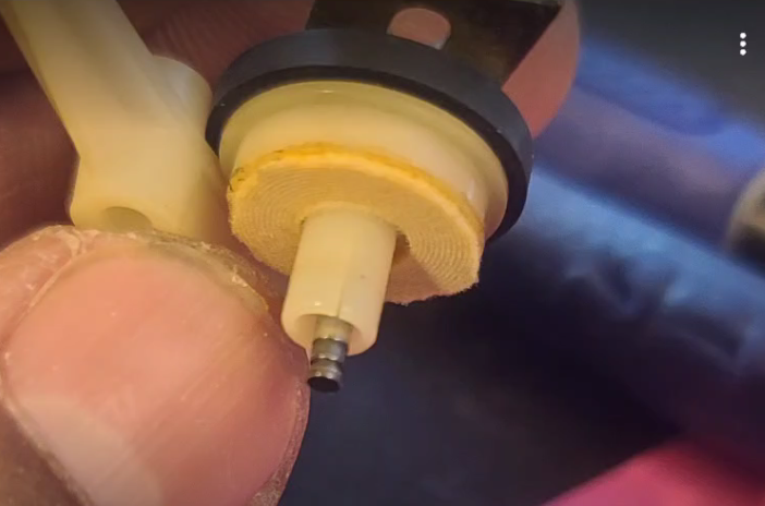

I was reading your thread on this CT-F1000 machine. I purchased two of them as they sold for Parts. I got the Kit (WJoe and Vintage Electronics) with had the tires and belts for the unit. I cleaned the Plastic with a mixture of 99% alcohol and mix 25% of acetone to remove film and oil. Put it together with patience. lots of contact cleaner (for the Variable and Switch controls) and alignment it as per the service Manual and works well. The unit barely fail a Wow and Flutter test. it turns out that the Belt I purchased had a anomaly, which matched to wow error measurement on a scope. I am waiting for a new belt and of course taking it apart. I repaired the clutch piece when replacing the tire, I noticed it was tough to spin. As I am an old school dog of an Electronics Bench Tech / Engineer (Back in the day we didn't have lots of manufactured parts, so we made due with redesigns as needed. when I took it apart, the inner plastic piece has a split running thru it. I made 2 stainless ring 1/8 inch long and it fixed both clutch problems. Ironically, both decks had the same problem. The motor also was dry/sludge, cleaned it re-oiled it. except for the wow it has, I am extremely happy with it. I wish it had a high BIAS freq adjustment to check EQ, but you can have everything. it will replace my Kenwood KX-1060 deck when I am done.

The clutch assembly is notorious for failing and there is a guy who sleeves for a nominal fee on audiokarma. I did a huge amount of work on mine but ultimately gave it to a friend a couple of years ago, replaced by a much more modern machine - Japanese market Sony KA-7ES. Congratulations on sorting yours out, they're quite challenging to work on as you've already discovered. They're really eye catching in a way most newer decks are not.

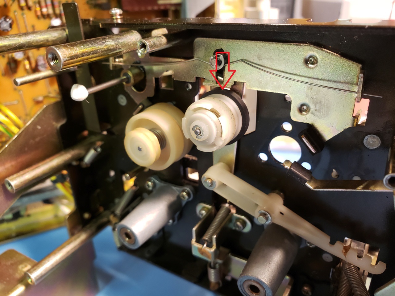

I am trying to restore the CT-F1000 and ran into the same issue JAElectricEye discovered with the Clutch. I observe the cracked plastic too. I wonder if anyone else had success with this solution. Can anyone offer more detail or a photo, so I might have a better understanding of what I need to do?I was reading your thread on this CT-F1000 machine. I purchased two of them as they sold for Parts. I got the Kit (WJoe and Vintage Electronics) with had the tires and belts for the unit. I cleaned the Plastic with a mixture of 99% alcohol and mix 25% of acetone to remove film and oil. Put it together with patience. lots of contact cleaner (for the Variable and Switch controls) and alignment it as per the service Manual and works well. The unit barely fail a Wow and Flutter test. it turns out that the Belt I purchased had a anomaly, which matched to wow error measurement on a scope. I am waiting for a new belt and of course taking it apart. I repaired the clutch piece when replacing the tire, I noticed it was tough to spin. As I am an old school dog of an Electronics Bench Tech / Engineer (Back in the day we didn't have lots of manufactured parts, so we made due with redesigns as needed. when I took it apart, the inner plastic piece has a split running thru it. I made 2 stainless ring 1/8 inch long and it fixed both clutch problems. Ironically, both decks had the same problem. The motor also was dry/sludge, cleaned it re-oiled it. except for the wow it has, I am extremely happy with it. I wish it had a high BIAS freq adjustment to check EQ, but you can have everything. it will replace my Kenwood KX-1060 deck when I am done.
I just went through one of my CT-F1000s and I'm having a similar rewind issue that was very much unexpected.
It has all new rubber and a new (donated from an FG-driven motor Technics) low-hours motor. It has GREAT torque in both directions and will rewind a tape to about 80% and the rewind TIME will be ahead of spec by a comfortable margin. And then...it slows down (instead of speeding up like one usually sees) and slowly comes to a stop. This isn't exactly the problem the OP describes, but it's very peculiar from my perspective. I suspect it's mechanical and NOT electronic as I can take the tape out and the rewind hub still has a LOT of torque. It does it on multiple tapes. I checked it when I first changed all the belts and WJOE-manufactured rubber replacement pieces and it worked (I thought it did anyway) perfectly. I had to travel for a couple of weeks and when I returned it started to exhibit this weird behavior with an approximately 90-minute tape (The Elton John Australia tape) and now does it with a number of tapes. Any helpful insights are appreciated. I've worked on a bunch of these CT-F's and I've never encountered this problem before including on other CT-F1000's. It's a low-hours sample (I've had it for about twelve years and it worked fine until the playback function stopped working owing to idler/motor pulley interactions, as described before now fixed) and I did NOT note any cracks in anything ANYWHERE. It's a pickle. TIA...

Common issue on these decks. The broken nylon parts are a pain to source and is the reason I dont touch the 70s pioneer decks anymore. Once that stuff breaks, your just chasing your tail trying to find good replacements. Its rather sad.I was reading your thread on this CT-F1000 machine. I purchased two of them as they sold for Parts. I got the Kit (WJoe and Vintage Electronics) with had the tires and belts for the unit. I cleaned the Plastic with a mixture of 99% alcohol and mix 25% of acetone to remove film and oil. Put it together with patience. lots of contact cleaner (for the Variable and Switch controls) and alignment it as per the service Manual and works well. The unit barely fail a Wow and Flutter test. it turns out that the Belt I purchased had a anomaly, which matched to wow error measurement on a scope. I am waiting for a new belt and of course taking it apart. I repaired the clutch piece when replacing the tire, I noticed it was tough to spin. As I am an old school dog of an Electronics Bench Tech / Engineer (Back in the day we didn't have lots of manufactured parts, so we made due with redesigns as needed. when I took it apart, the inner plastic piece has a split running thru it. I made 2 stainless ring 1/8 inch long and it fixed both clutch problems. Ironically, both decks had the same problem. The motor also was dry/sludge, cleaned it re-oiled it. except for the wow it has, I am extremely happy with it. I wish it had a high BIAS freq adjustment to check EQ, but you can have everything. it will replace my Kenwood KX-1060 deck when I am done.
