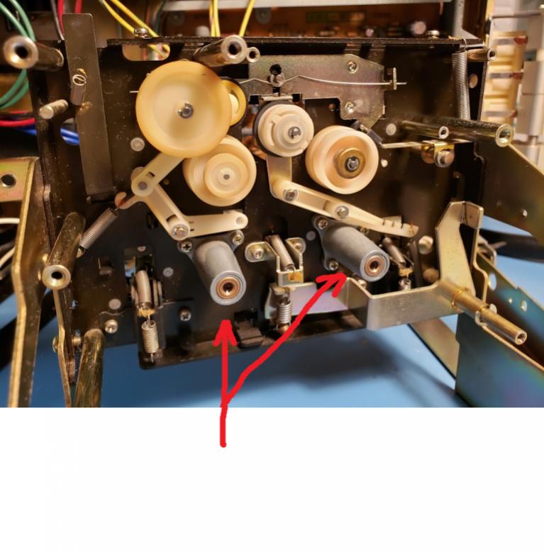

I'm curious about the dual capstans. I assume they are there to maintain tension for the tape/head gap, and to prevent snagging and bunching.. Is there a risk of overtension if they don't remain synchronised, can differently worn pinch rollers cause that? What if one has a dent in it and the tape slips, could this introduce slack.. does one run faster under slip through a clutch?
No slip clutches, and the pinch rollers don't determine the tension or speed - that's determined entirely by the diameter of the individual capstans and/or the pulley/flywheel driving them. (+ motor speed, pulley ratios and belt thickness) The pinch roller's job is just to force the tape tightly against the capstan.
I'm pretty sure in the Pioneer it's all determined by the ratio of the pulley diameters. The supply capstan runs ever so slightly slower than the one on the take up side. Any slippage is likely across the capstans and to avoid damaging the tape would have to be minute.
The purported advantages are more constant tape tension across the heads and slightly better speed stability. Since this was an expensive 3 head machine and there is not room for the tensioners typically found on better R2R (not to mention the opposing torque applied by the supply side reel motor) this is the solution they came up with. Reel to reel decks both auto reverse and not also showed up in this time frame with dual capstan drives. (There are high performance R2R drives sans pinch rollers as well - not the cheesy rim drive found on cheap portables of the early 1960s)

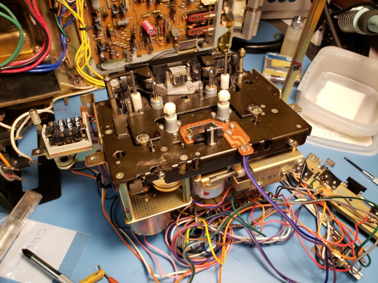

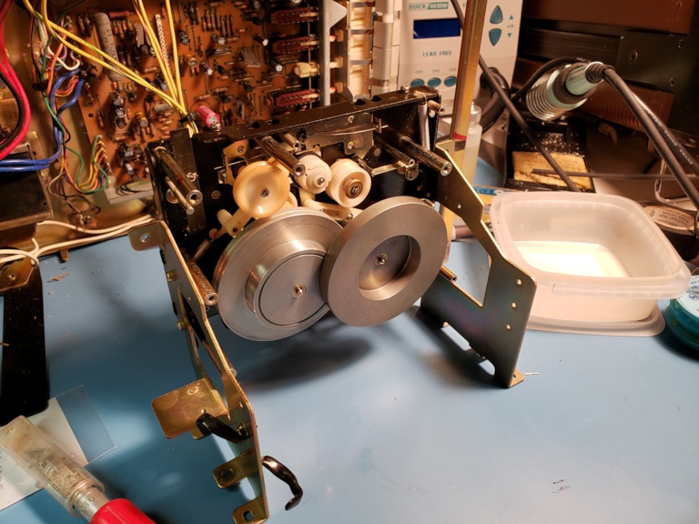

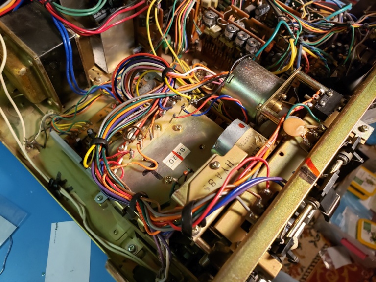

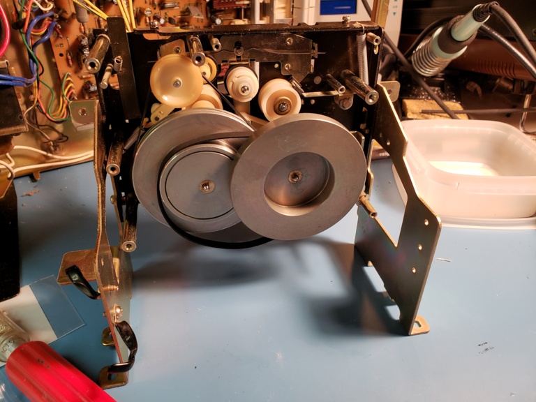

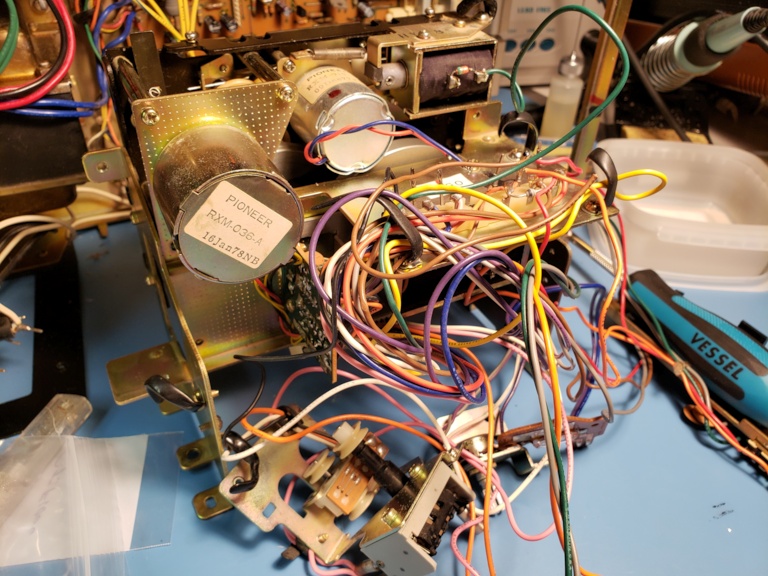

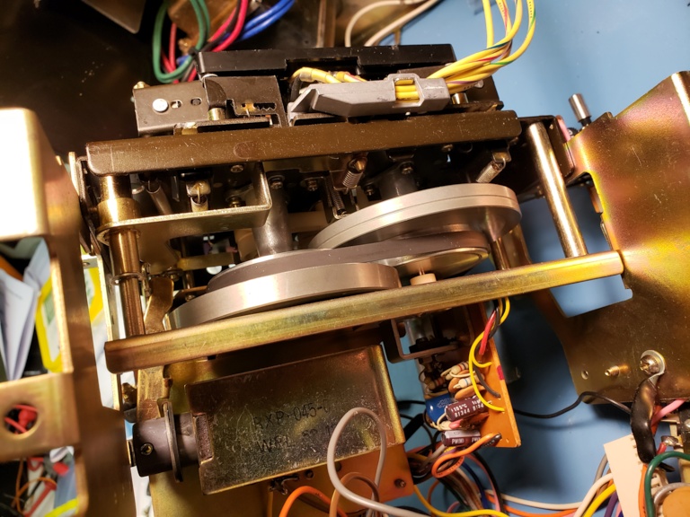

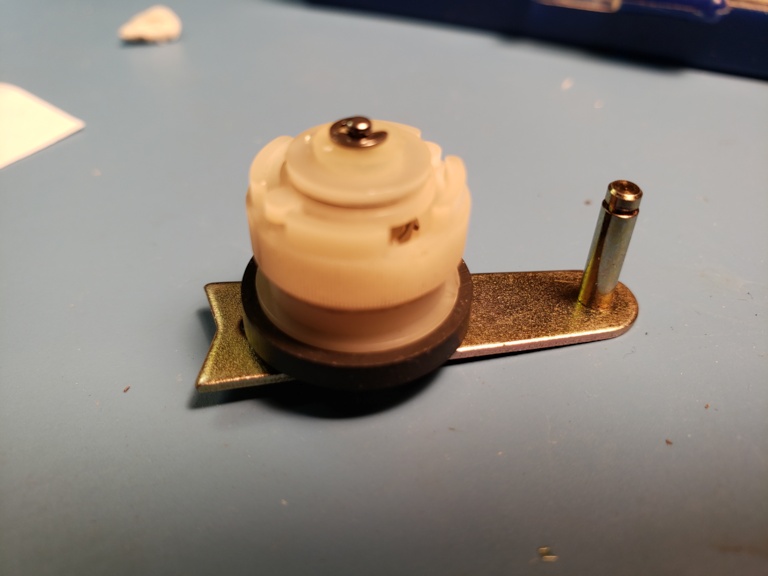

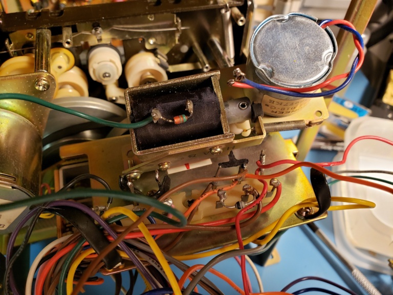

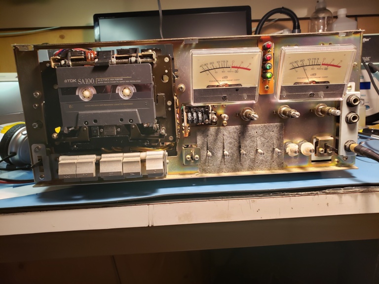

Well tonight was the perfect storm, all the parts needed to fix the transport have arrived at this point.
I slowly and carefully dismantled a few more components to change the idler tire (wrong tire!), but I was able to lubricate the sintered bronze bearing which needed it.
I installed a new tire on the FF/RWD clutch, then installed it. I then installed the capstans and added 3 belts which need to be installed before things are bolted back together, then I installed the rear chassis plate with capstan motor and solenoid. Using a special tool I installed the counter belt first, then the capstan belt and finally the take up reel drive belt.
I added the FF/RWD motor and cassette well lamp...
FF and play seem to work OK, RWD is a bit of a mixed bag and I'm not quite clear as to what the exact problem is - everything is buried. There is a tension setting I can change perhaps without dismantling the transport again.
It actually sounds OK excluding the intermittent switch issues which I will address next..
Not the complete nightmare to work on I was led to believe, but this no deck for the inexperienced or faint of heart. It would not be a lot of fun to work on either if you were on the clock. I'm also concerned about the mechanical bits and motors, none of this is nearly as robust as the Otaris R2R I habitually work on. I am not sure how much further I am going to go once I sort out the RWD issue (if it can be fixed)

I never liked it when they started making assemblies out of that "recycled milk bottle plastic" stuff.
Over time, it sometimes deteriorates, gets brittle, cracks or warps from stress.
Like that spring hooked to that elbow lever in the cassette mech above.
Press-fit gears and pulleys crack, you know the deal.
Then it's a pain to diagnose and repair.
But, ya know, cheapening happens.

Did you check the capstan seat?
Old cassete decks need new head and new pinch roller,if capstan seat is ok
Yup, capstan seats are fine, and so are the heads. The pinch rollers are serviceable short term, but will only be replaced if I sort out the other issues. I've reached a reasonable spending limit until I am sure this thing is going to continue to run. I need to do some more work to the FF/RWD components.
