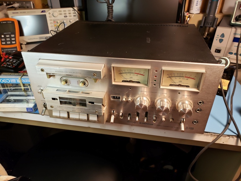

So something over a month ago I was gifted a very broken but decent appearing Pioneer CT-F1000 dual capstan, dual motor, 3 head cassette deck. These machines were built and sold in the 1978 - 1979 time frame.
This machine appears to be a U.S. Military PX version since it has multi-voltage and matches the configuration shown for those machines. These machines retailed new in the 1978 - 1979 time frame for about $650 which was more than I could afford at the time. (I purchased a JVC KD-75 in 1977 while in college, and that was quite a stretch for me at something like $450 - that deck was still running well when my ex deprived me of it in 1999.)

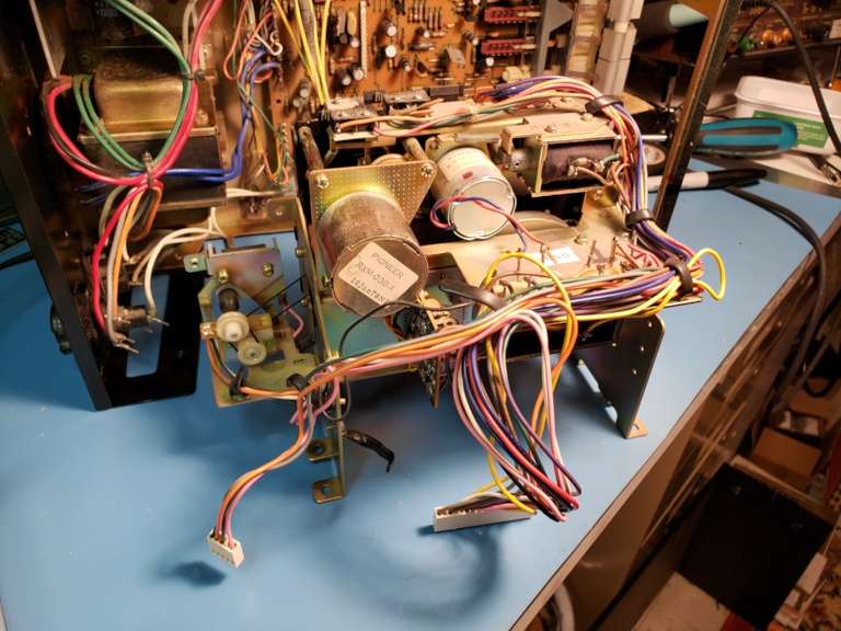

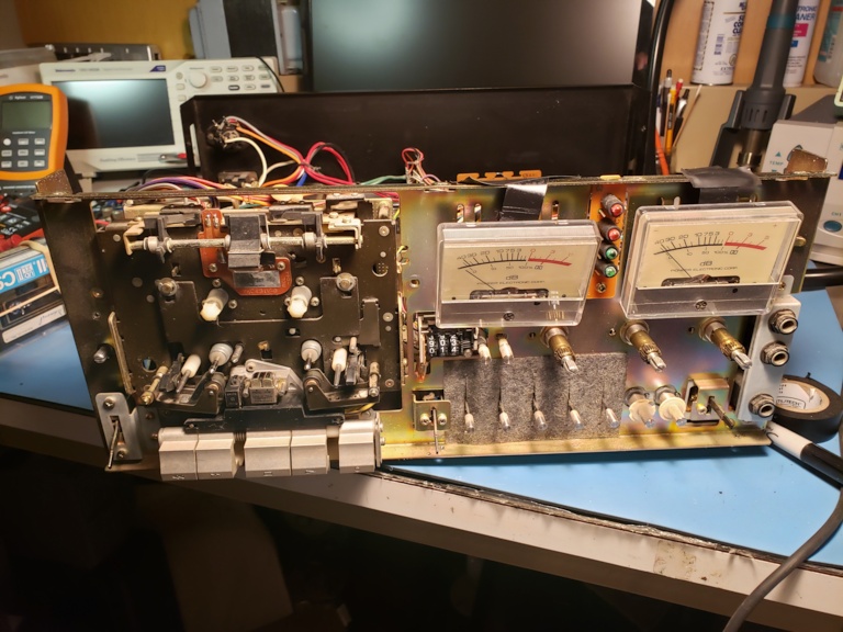

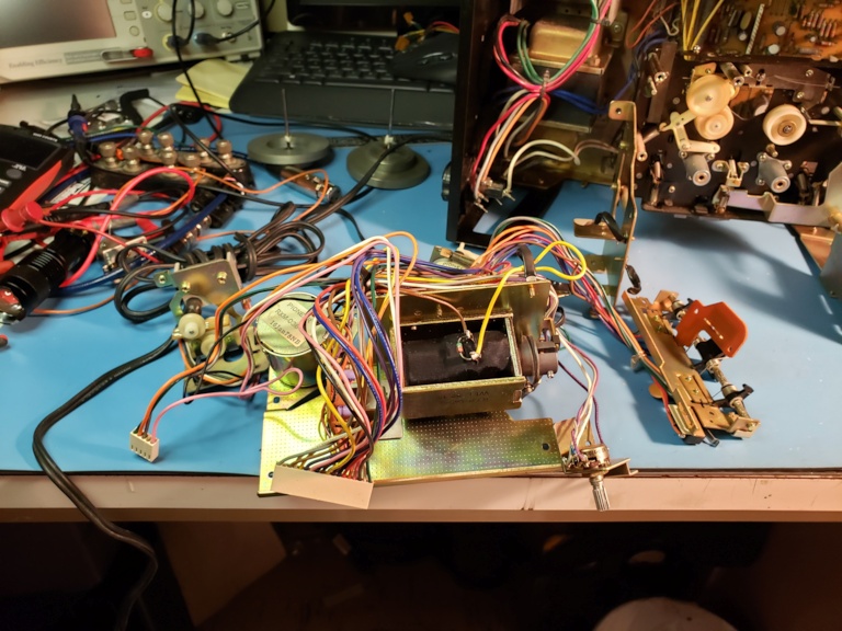

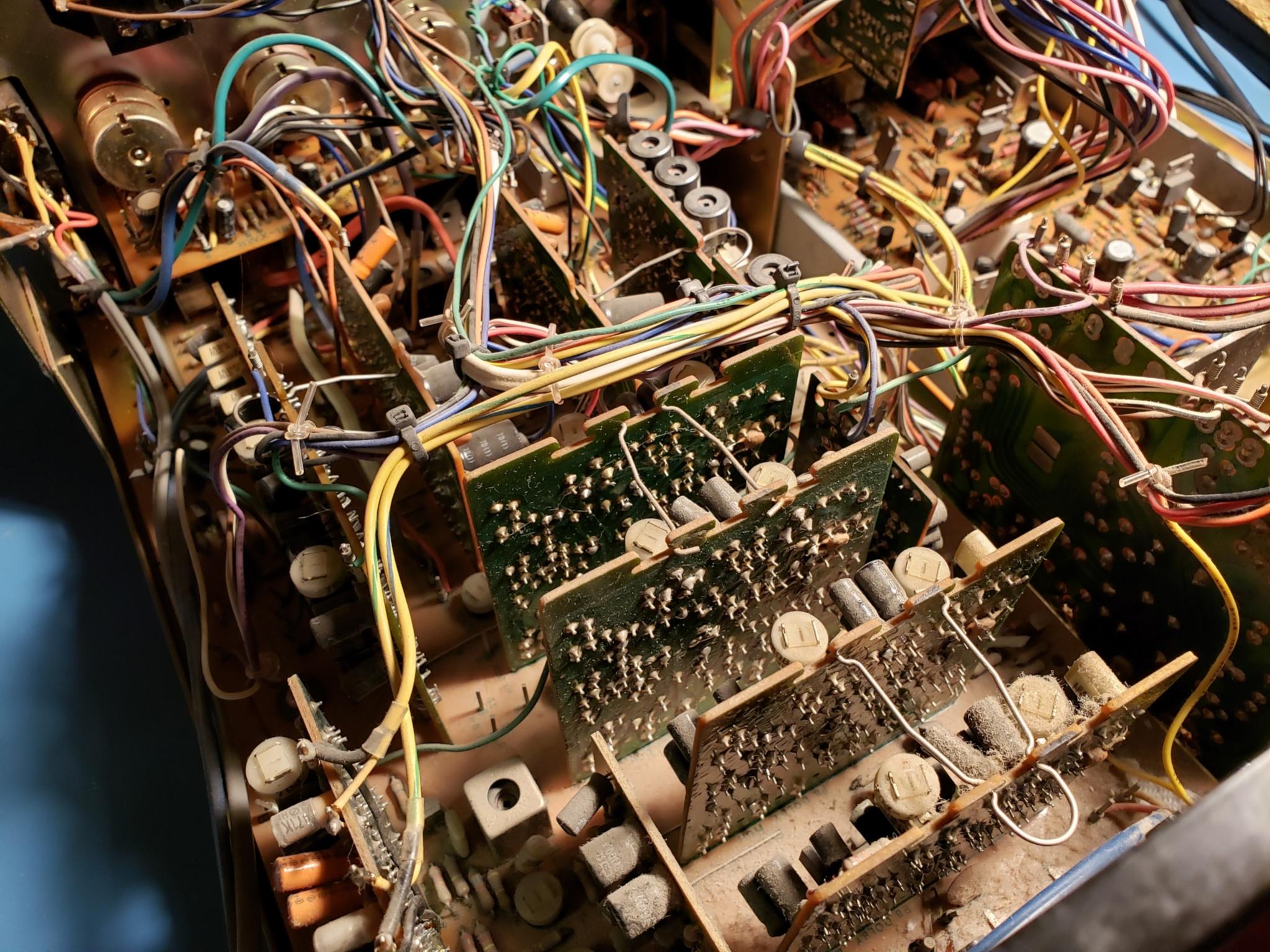

This machine has bad belts, a bad FF/RWD clutch, bad micro-switches, and motors with dried out bearing front bearings.
It also has over 160 electrolytic capacitors, all of which need to be replaced. (I have replaced 34 to date.)

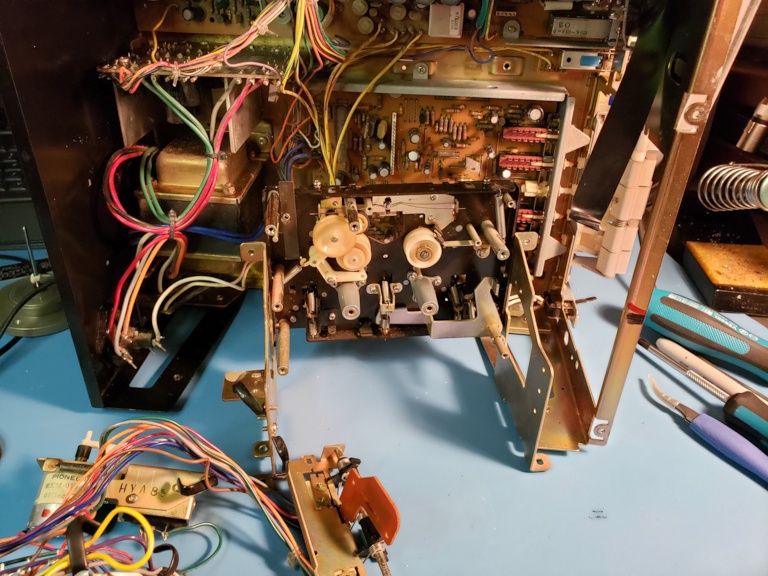

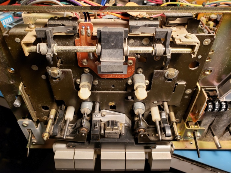

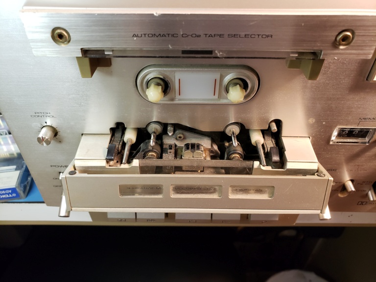

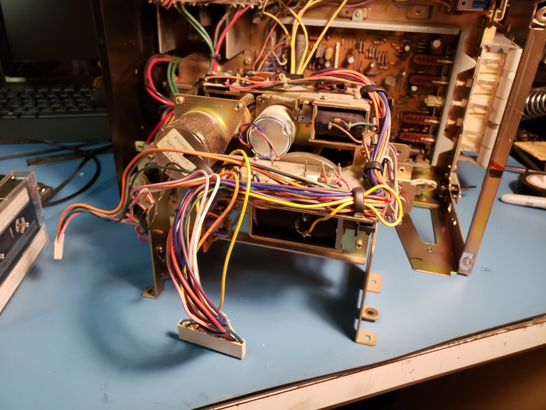

Since it basically refused to play except after considerable coaxing I decided the first order of business was to dismantle the deck to the point where I could access the transport.
I checked all of the micro-switches and jumpered the capstan motor switch which allowed it to run.
I observed that the fast forward and rewind were not working but the motor was.
The belts were all sloppy and loose. I immediately ordered replacements.

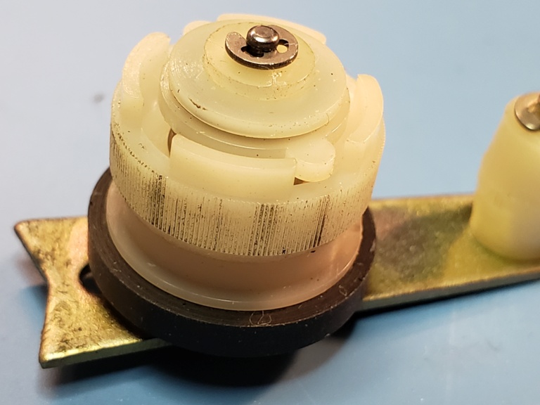

I noted that the FF/RWD clutch basically did not want to turn. These clutches are prone to internal cracking which results in them jamming and refusing to turn - mine was not there (yet), but was binding for some reason. Turned out the clutch had sat long enough for the clutch felts to stick to the plastic. Cleaned things up a bit and the clutch worked, but concerned about eventual failure I sent the clutch to markthefixer on audiokarma for his repair.

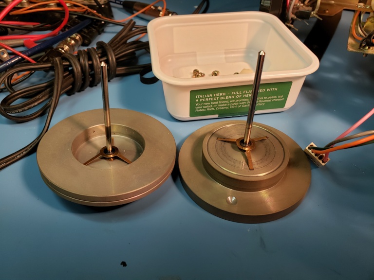

The tire on the clutch was cracked in two places so I ended up ordering some square profile O-rings which arrived a couple of days ago.
The clutch should be on its way back here from its repair.. The O-ring seems to be the correct size, but is slick enough I am not sure it is going to work. I have a lot of them so I will try roughing up the surface.
I lubricated the front motor bearings, based on prior experience I will not open up these motors to get at the rear bearings - it usually does not end well, and for some reason they have generally been OK.

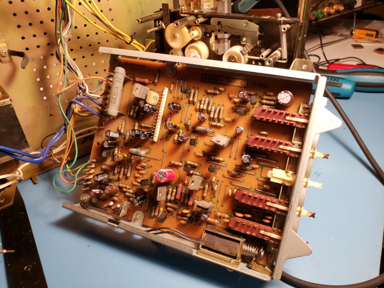

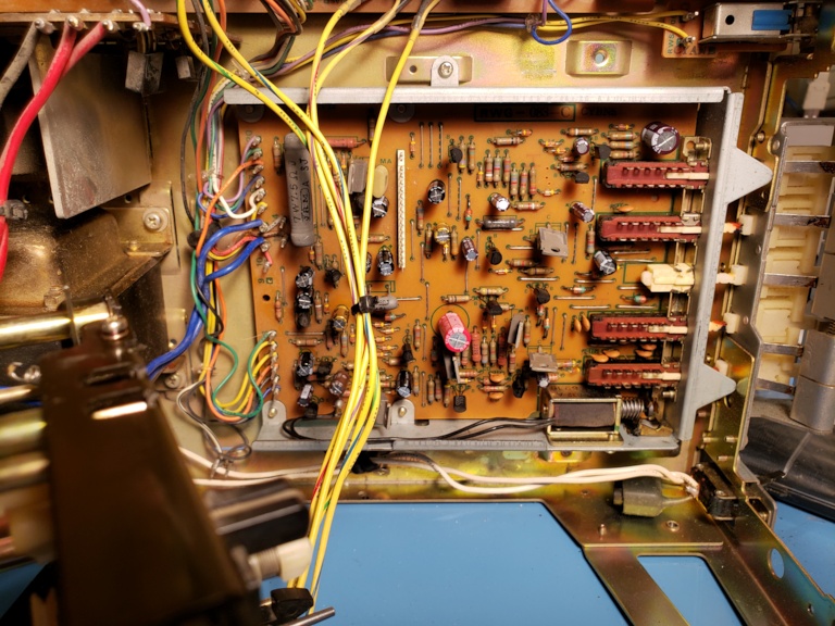

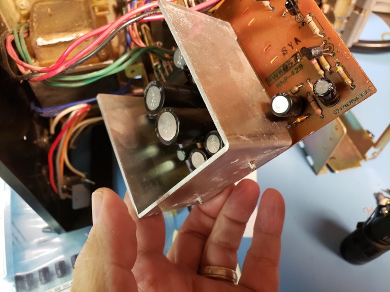

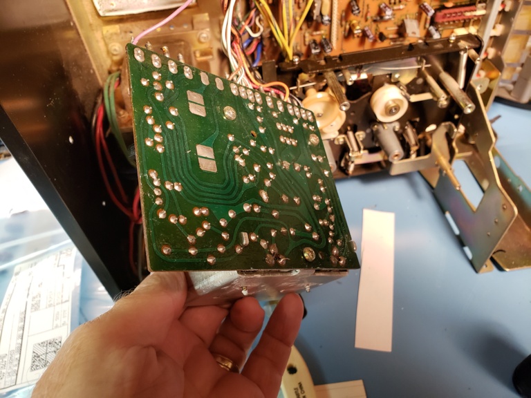

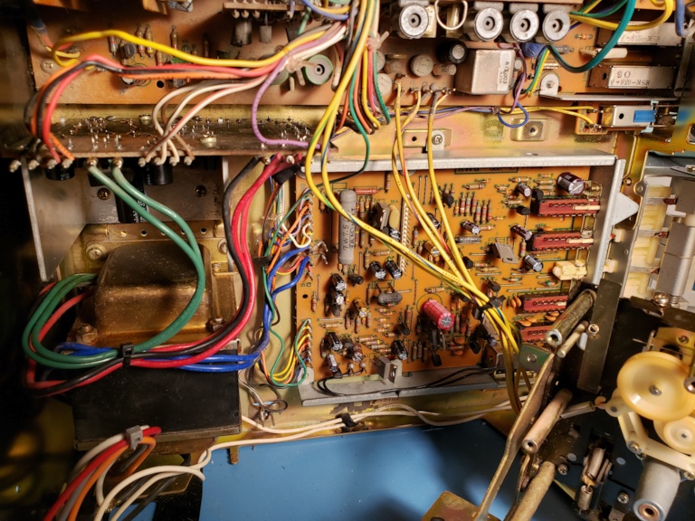

Since the transport was out I took the opportunity to remove the logic board and re-cap it. By the same token I also recapped the PSU.
I still have 12 PCB assemblies to recap..

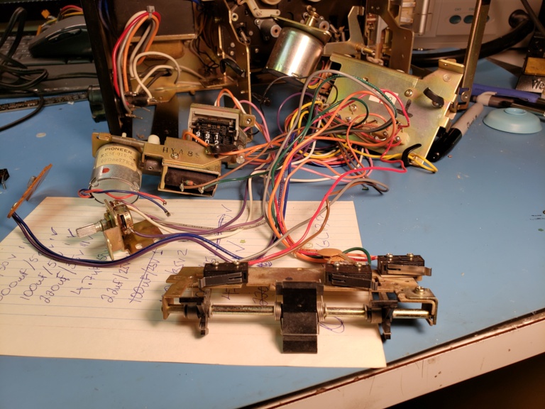

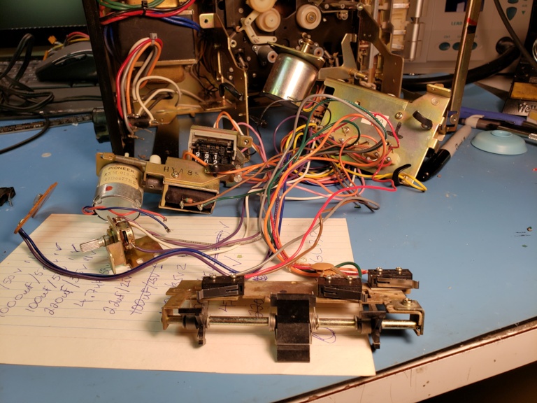

I also replaced all three micro-switches on the transport with ones purchased from Mouser.

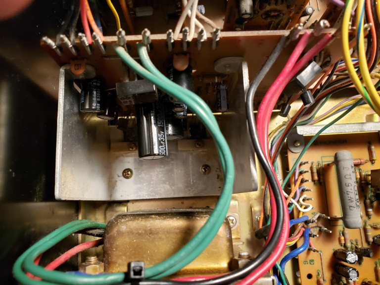

Power supply rebuild.. Since everything was basically working I just replaced the electrolytic capacitors.
The original circuit values are all available from Mouser, including what I thought was a rather oddball 1500uF 35V input filter capacitor value. Turns out there are lots of choices.
For these sorts of replacements I tend to go with industrial temperature range parts from Nichicon, Panasonic or Wurth..
For the audio capacitors yet to come I am likely to go with Nichicon Muse or Elna Silmic types. Nothing terribly exotic and purchased directly from Mouser or DigiKey.
I replace just one capacitor at a time and because electrolytics capacitors have changed so much from the 1970s I made no particular effort to try and match the lead spacings of the originals, were possible I got as close as I could, otherwise I just form the leads. Modern capacitors are much more compact than the originals in this deck.
I am using solder wick (chemtronics soder wick brand) to wick out the solder before removing the capacitors. This works great except for the few caps which are glued down making it hard to tell whether the capacitor is free or not. The lands on these phenolic PCB are a little fragile and some care is required. I have lifted 2 pads total on the 34 I have replaced so far.

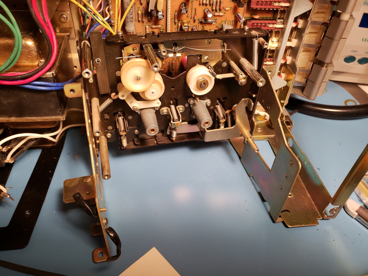

If you look at the photo of the transport chassis you will notice that a lot of components like the motors, capstans, belts, clutch, some linkages and other stuff is missing.
The second photo is of some of the bits I have been working on, there are new switches and the front bearings of the motors have been lubricated.
I am weeks if not months away from having a running machine.
