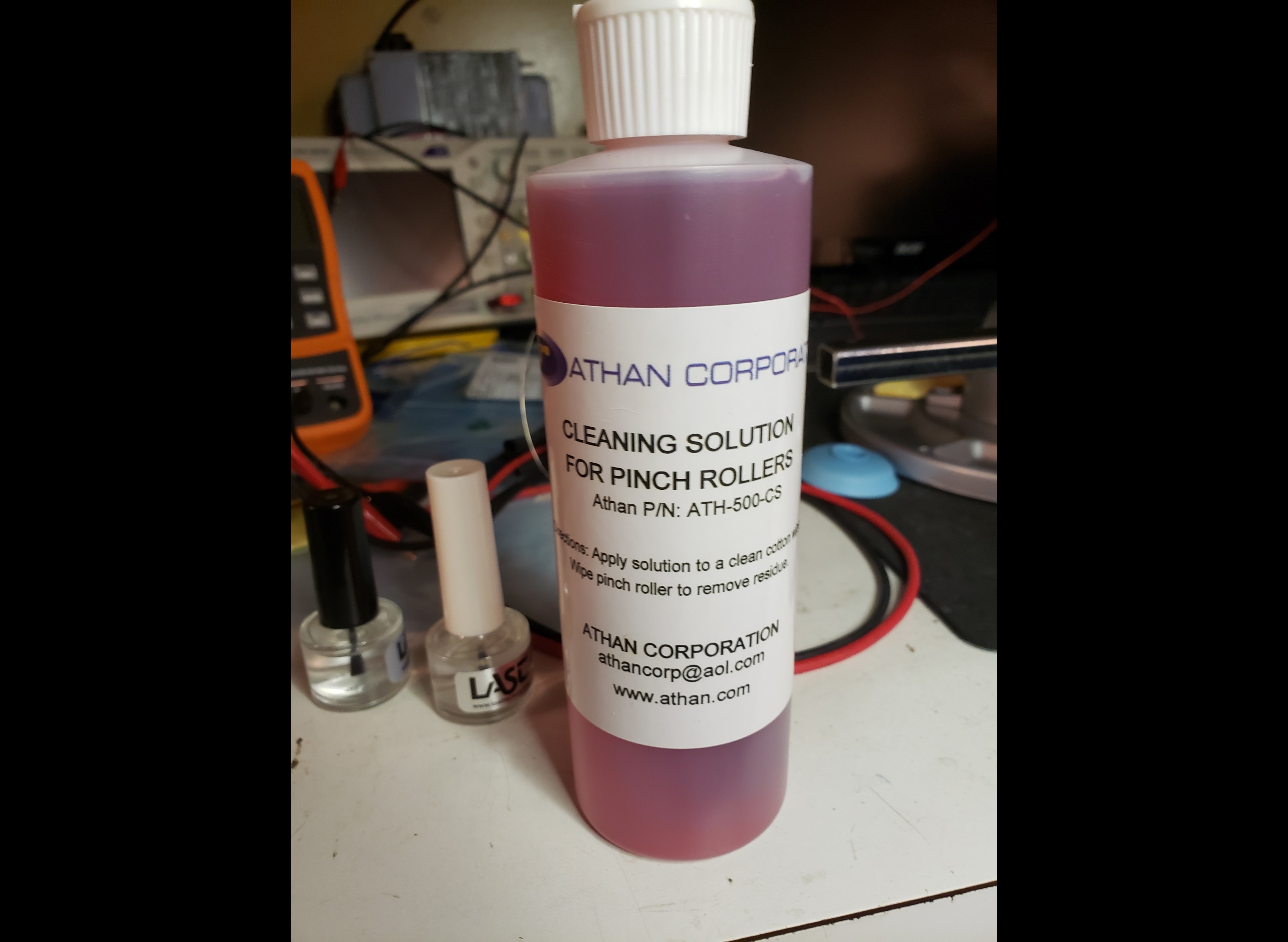

Not specifically relating to Otari tape machines, but......whilst working on my Studer A810, I had need for a pinch roller---old one crumbled away. I had Terry's Rubbers refurbish the bad one; put it on, and......TERRIBLE wow, not subtle at all---like a piece of gum stuck on the roller! Did some research and found that many others (on tapeheads.net) had experienced similar problems with Terry's rollers; although, to be fair, many others had good experiences. Also many complained about Athan rollers going "sticky" after a short time. The best reviews were for rollers from Gianni---https://www.sofh.it/. Have one on order so we shall see. Any one on here have any experience with any of these pinch roller vendors--sofh, Terry, or Athan?
I have Athan pinch rollers on 3 of my 4 Otaris, I've had them less than six months, but so far no problems. I'll report on them should anything develop.
George Athan's pinch rollers are urethane. If you don't use the proper cleaning agents, they will go sticky in short order. They will go sticky in the long term as well, but only after you should have replaced them anyway. Pinch rollers are a consumable on tape decks (except ATRs which have none)
Some of the original Studers had a habit of melting as well, found one that hadn't been looked at in a year with a puddle on the deck plate and no pinch roller!
I have not had a problem with Terry's rollers either, but I only use them on things like Otari's and such. Studers get Athan.

I use the recommend cleaners and so far I've not had any problems with them, and I prefer them to the OEM by a wide margin.
What ARE the proper cleaning agent(s)?George Athan's pinch rollers are urethane. If you don't use the proper cleaning agents, they will go sticky in short order.

It's only required for use on polyurethane pinch rollers, and it's not cheap, but when you are paying $90 and up per pinch roller you tend to follow the manufacturer's advice.
